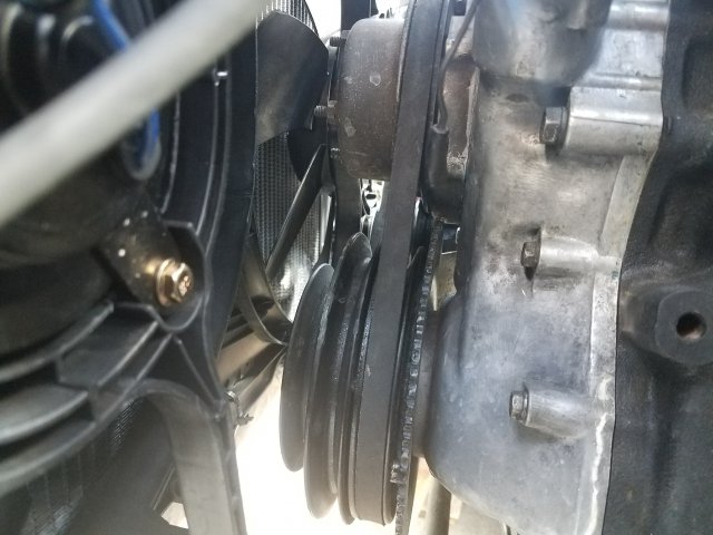

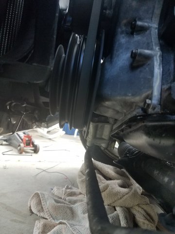

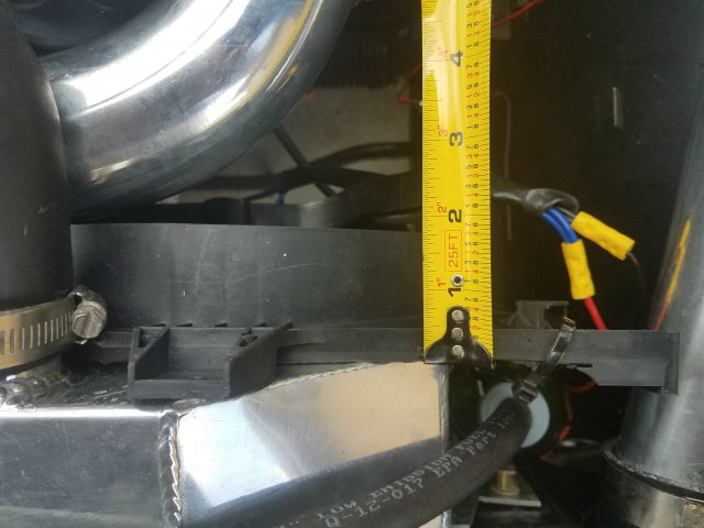

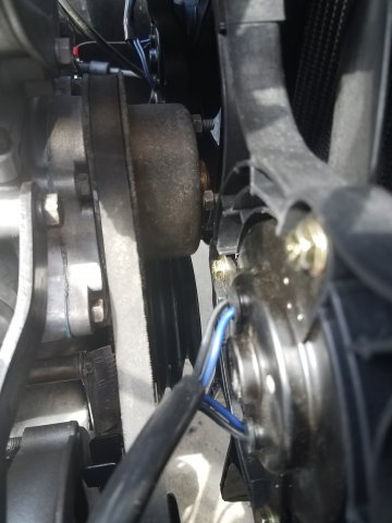

supershanesta Posted February 12, 2018 Author Share Posted February 12, 2018 The pulley sits between each fan with no issue. Quote Link to comment Share on other sites More sharing options...

Namor Posted February 13, 2018 Share Posted February 13, 2018 You don't have AC though, right? How thick are the altima fans at the motor? I had a fan that was 3.5" thick at the motor and had to go to a thinner one because it interfered with my AC pulley. Quote Link to comment Share on other sites More sharing options...
supershanesta Posted February 13, 2018 Author Share Posted February 13, 2018 Good Question, I do not have ac, but was considering it as the prior owner had everything in it besides the compressor. To me, it most likely will hit the fan. Which pulley position does the ac run on in my setup? If its the small front one, I highly doubt it will clear. If its the second one the belt might squeeze by, but I don't know about the actual compressor mounted up. If that was the case you might want a slim single fan I don't know. I plan on putting ac in the car before the summer, but I don't know right now. Quote Link to comment Share on other sites More sharing options...

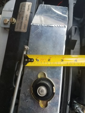

Namor Posted February 14, 2018 Share Posted February 14, 2018 (edited) I have a 280z and I know there is a height issue in the difference between the radiators, but I'm not sure if there is any other difference. As for A/C, it normally runs off the middle pulley on a L28et. I had an unknown 16" fan in there before that was 3.5" thick and ran into clearance issues with the tensioner pulley when recently installing A/C. Now I have a SPAL fan that is ~2.5" thick and have ~7/8" of clearance. I have a Champion 3-row radiator that measures 2.75" at the top, but the core is inset from the edge of the end tank by about 3/8" and my fan is just flat up against the core (no shroud.) *edit* Just looked, and if you have a Champion 4-row for your 240z, you should have ~.3" less clearance than I do. Edited February 14, 2018 by Namor Quote Link to comment Share on other sites More sharing options...
nmehdikh Posted February 14, 2018 Share Posted February 14, 2018 On 2/13/2018 at 2:02 PM, Namor said: You don't have AC though, right? How thick are the altima fans at the motor? I had a fan that was 3.5" thick at the motor and had to go to a thinner one because it interfered with my AC pulley. Expand It looks like it clears an AC pulley, but it seems like it might interfere with the belt / compressor. Hard to tell from the pics. Quote Link to comment Share on other sites More sharing options...
