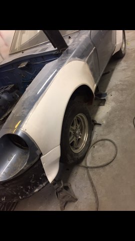

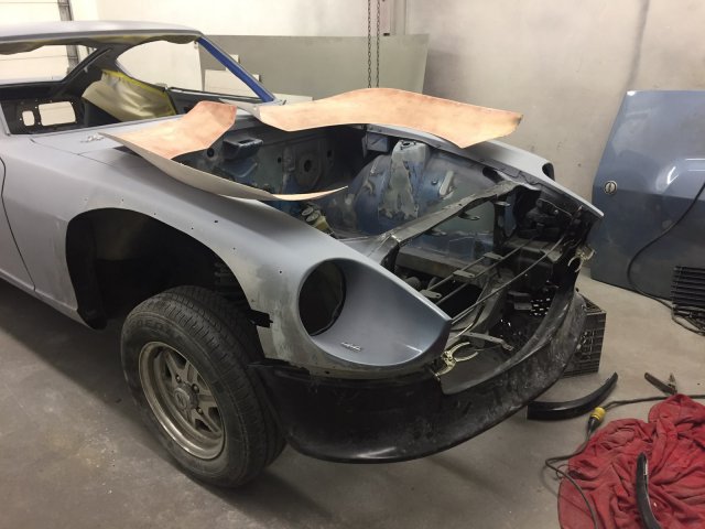

juliarosario 2 Posted March 29, 2018 (edited) The first step once my car got to the body shop was to bring down and cut back my original fenders. You could see them underneath the Mafia flares, like a lot! I couldn't imagine not cutting the fenders back because as soon as you were to see the car from a low angle, there were the old fenders underneath! It was horrendous. Here is a picture of how high we had to cut the fronts back. I don't have a picture of the backs cut, but trust me, they're cut!! Edited March 29, 2018 by juliarosario Share this post Link to post Share on other sites

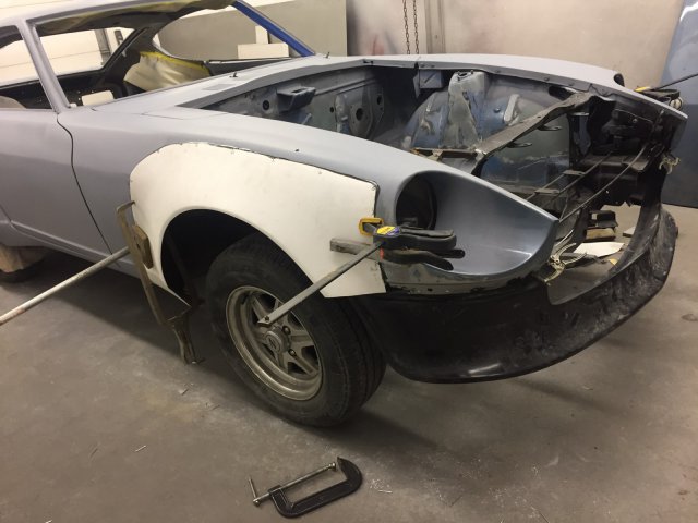

juliarosario 2 Posted March 29, 2018 Next, we fit the fenders on the car and riveted them in place. The backs went on pretty easy, mostly all the lines in the fenders went with the body lines of the car. Share this post Link to post Share on other sites

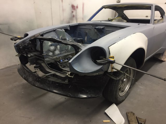

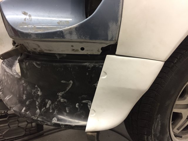

juliarosario 2 Posted March 29, 2018 The fronts were a little more difficult to fit, especially matching the little piece that attaches the fenders to the air dam. You can kind of see how that little piece doesn't fit quite right. So I went back onto the Fiberglass Mafia instagram page to try and find some more information. I found out that they used the Type 1 Air dam to mold with this kit, and that's exactly what I had! I figured that if I bought a bumper we could see where the air dam wants to sit, and more easily fit the front together. But, you can see how awesome the from fenders line up!! We decided to start working on the backs while we ordered and waited for a new front bumper to ship. Share this post Link to post Share on other sites

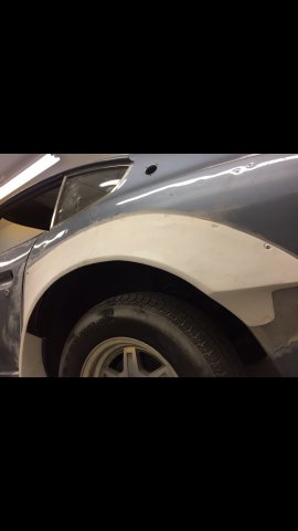

juliarosario 2 Posted March 29, 2018 (edited) Anyways, back to working on the rears! This is just about where we wanted them, so we riveted them in place and started to bond them to the car. I was SOOO happy with them at this point! However, my plans were to have them molded onto the car so I knew it wouldn't stay looking like this. I was a little scared of having them molded because lots of people expressed their doubts and warnings about having them molded! BUT, I have faith in my body guy!! Edited March 29, 2018 by juliarosario Share this post Link to post Share on other sites

juliarosario 2 Posted May 18, 2018 So after I got the last set of pictures, I didn't hear from my body guy for about two weeks. He was slammed at work and I don't blame him for taking some relax time for himself! I am in no immediate rush and he's done such a great job so far, I figured a few weeks off is no biggie. However, then he sent me some more pictures of my baby and I got all excited all over again! He was telling me that he had the most trouble blending in the flare to the little end piece that came with the flare, to the air dam. He explained that they all had different contorts and body lines and to get them to mesh together so clean took some work! HOWEVER, IT LOOKS AWESOME!!! It's starting to look like the front end is all one piece and that is something that I like! Share this post Link to post Share on other sites

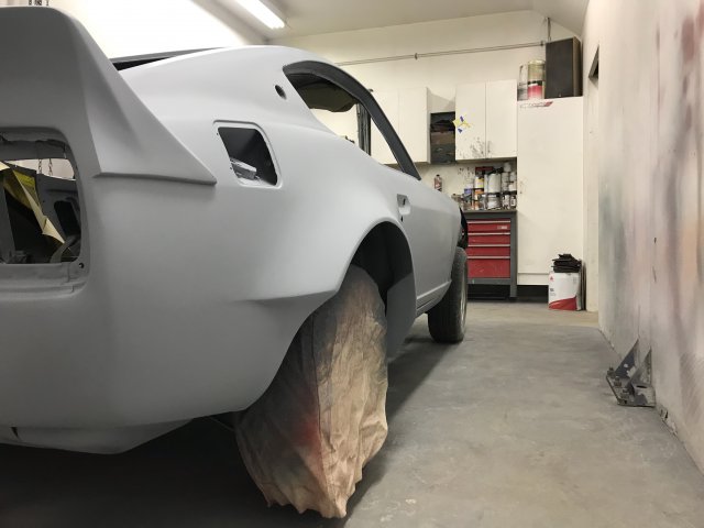

juliarosario 2 Posted May 18, 2018 Alright, so after I got the last pictures I was ACHING to see the car all one color! I just wanted to get an idea of how nice the body kit looked without all the colors distracting me! Then, a couple days ago, at around 11pm I got the NICEST text message. My body guy said he had finished up all the body work and was just about to primer it!! Within an hour or so, I got the coolest pics ever. Take a look and see how awesome the car looks! I WAS SOOOO HAPPY. The car looks insane. It looks like the wide body kit came stock on the car and that's exactly what I was going for!! Share this post Link to post Share on other sites
juliarosario 2 Posted May 18, 2018 (edited) The next night I stopped by to take a look at my baby in person, and let me say, the pictures do not do this car justice! Before this, I was trying to decide whether I liked the look of the car with no bumper, and I do, or if I wanted to add a bumper. I think I decided to put the bumper ends on to give the front end some contrast. I also propped the grille in there just to see how it would all look and DAMN I am psyched!! This is gonna be awesome! He said the next step is attaching the front bumper ends, either making them permanent or detachable. Either works for me, I trust his judgement! Then he's gonna block sand the car and fill any air bubbles the fiberglass flares have left, then sealing, AND THEN I THINK PAINT!!! Edited May 18, 2018 by juliarosario Share this post Link to post Share on other sites
