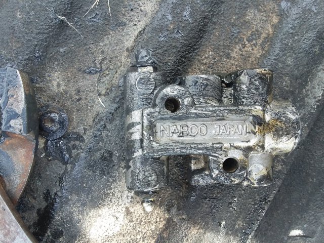

walkerbk Posted May 25, 2018 Share Posted May 25, 2018 Does anyone know how to disasimble these? I have tried everything that I know of, wd40, heat, soaking in paint thinner... I can't get the cone out that goes to the front in order to get the plunger out. Quote Link to comment Share on other sites More sharing options...

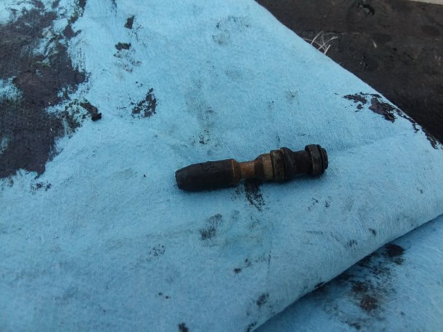

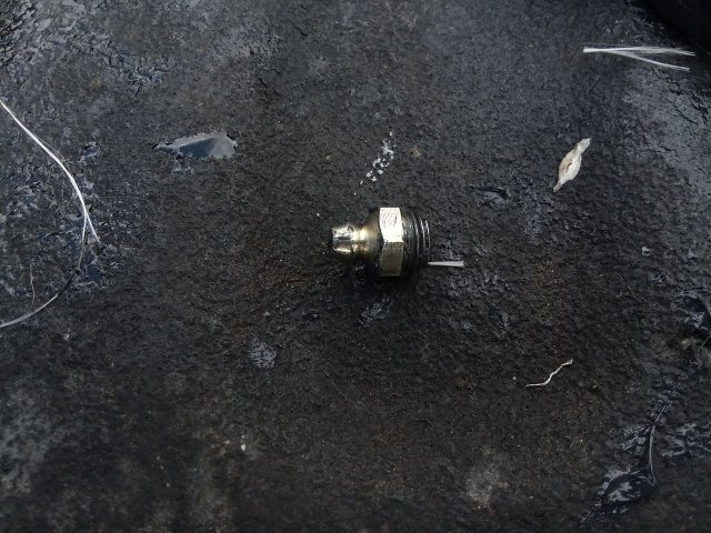

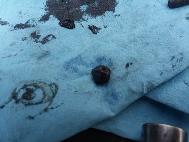

walkerbk Posted May 25, 2018 Author Share Posted May 25, 2018 Well I got it... After a full day of heating and working at it, I figured it out. I tried going at it with compressed air but that had no effect. My next to last Idea was to attack it with the grease gun. Napa has 10x1.00mm grease zerks (part number 715-2008) that I was able to mount on the ends. after attaching the grease gun to it and pumping it a few times, the plunger shifted. After that, I applied the blow torch and continued to pump with the grease gun until the end popped out sending burnt grease everywhere. it is now going to soak in the cleaner overnight again and tomorrow, I will clean up the bore and hopefully replace the seals. 77, DATSUN!!! (for real, make???), 280z 2+2. Quote Link to comment Share on other sites More sharing options...
