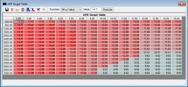

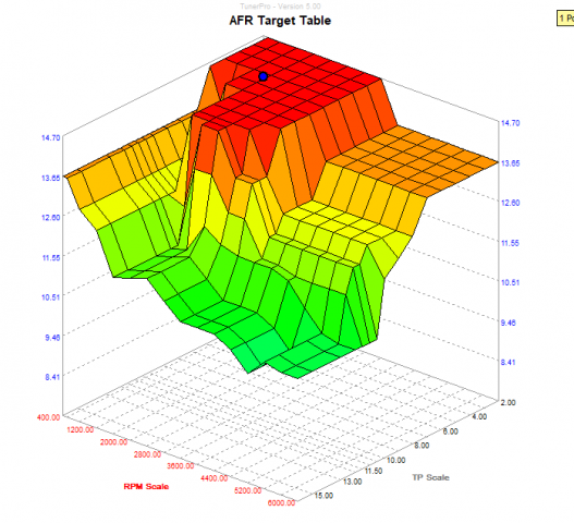

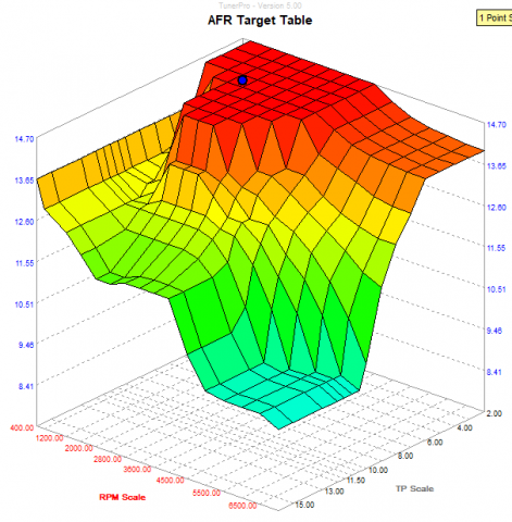

Here's what I've got on the AFR target table.  I cleaned it up a lot and got it running in the 11.5:1 range from 2800~6000rpm.
Additionally I've increased the closed loop range and leaned up the part throttle operation up to 0 boost significantly, this gave a lot more responsiveness and torque in the part throttle areas.
The part throttle areas, especially the 5th gear cruising for climbing hills is still a work in progress.
As I understand it so far, based on my testing and documentation on later ECCS systems the ECU calculates a theoretical pulse width for a lambda of 1.0, or 14.7:1 AFR based on current RPM and mass air flow.
After this TP value is calculated, the TP is used to look up an enrichment percentage from the AFR target table based on a TP (load) and RPM scale.
the AFR target value is a multiplier for the calculated TP before the injectors are actuated.
Several other enrichment tables are also referenced, I'll go into the details later when I have solid information on them.
The stock AFM becomes very inaccurate past 3500rpm or so, but does have consistent readings.
This is possible to correct by bumping the AFR values rich, I have 9.62 AFR targets to get a 11.5 measured AFR above 5000rpm.
Its much more time consuming to tune than something like megasquirt, but definitely has good results.

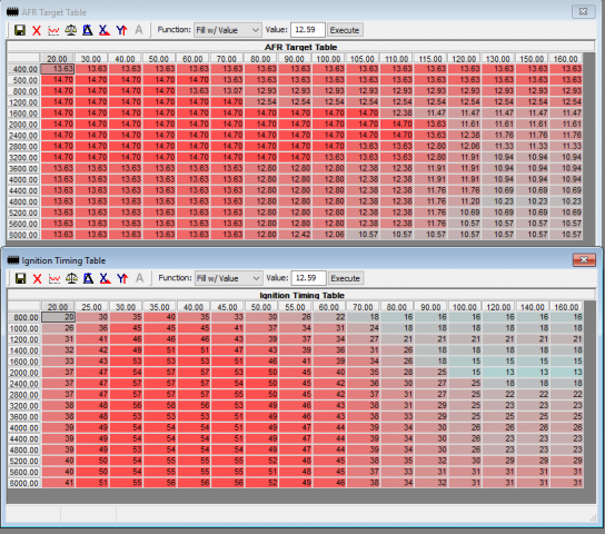

After chatting with Gollum about tuning and pouring over his megasquirt logs and comparing our timing charts, I got familiar with KPA.
I noticed something very interesting, the TP scale in the ECCS acts a lot like a KPA scale.
With some logging I compared it to the vacuum gauge, with an in/hg to KPA conversion table handy it looks that my hunch is confirmed.
The TP scale does convert to KPA!
So, here's some factory tables with the converted KPA scale for reference.
Please note, above 3600rpm and above around 120kpa the AFM is very inaccurate.
The KPA scale is accurate in same ranges that the AFR targets are accurate.
Also note in later ECCS models this is a 'theoretical pulse width' scale, and not KPA.
But its interesting that it does follow KPA in stock configuration.

Are your injectors perfectly linear? No. Is your fuel pump and pressure perfectly linear? No. Are the variances in expected thermal transfer ideals and reality? Yes. Unless you can put ALL your sensors INSIDE THE CHAMBER with absolutely ZERO unintended environment impact, you're going to need "non math-scientific" adjustments to get the results you want.
I was referring to your Megasquirt VE table. If you don't have "include AFR" active, it isn't a VE table, but rather a rescaled pulse width table. Maybe this was the issue.
Everything is an approximation anyways, but if the fueling table doesn't look at least a bit like the torque curve, there's an issue.
"Your" might be a bit misplaced there. I've always used include AFR target with my setup, so I'm not exactly clear on what stupid_fast was getting at when saying "air flow would be consistent". Maybe he's seeing or meaning commanded pulse width, which WOULD be similar with VE == VE areas all other variables staying constant.
But that last bit you said was the point of what I was getting at. Everything is just an approximation, and the idea of a VE table being "accurate" is a relative term. What matters at the end of the day is how the car drives with the tune.
