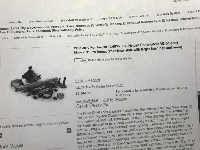

toolman Posted July 31, 2018 Share Posted July 31, 2018 (edited) I always been a Chevy man and installed a Chevy 327 into my 240z over 40 years ago. Now I am planning to install a LS3 crate motor in after I restore the rest of the car. While surfing the Net, I came across a post on a Australian 240z forum-Auscar. PeterAllen discussed putting a Holen differential into a 240Z. His donor car was a 2005VZ SS Ute which an Australian version of Chevrolet Camaro. Here are some of the pictures of the conversion: Holden conversion rear mounting bar differential mounting bracket CV 930 axles front differential mount tied to rear crossmember There are more detailed information on this post. The author offers the detailed plans to interested parties too. The thing that I like is that Chevy Performance parts are the cheapest and widely available( even in the junk yards). Also, Chevy is coming out with a 9" Holden differential in the Camaro, adjustable rear lower control arm and disc brake bracket Edited August 1, 2018 by toolman add text Quote Link to comment Share on other sites More sharing options...
Neverdone Posted July 31, 2018 Share Posted July 31, 2018 I don't think that's the same differential housing that the Camaro uses. Quote Link to comment Share on other sites More sharing options...
