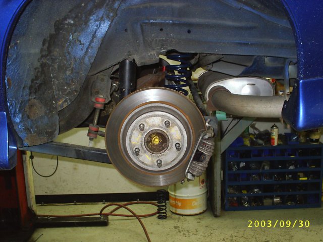

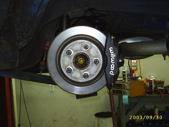

Chickenman Posted September 21, 2018 Share Posted September 21, 2018 Yeah... 15's would be really tight. The 280ZX rear rotors are not 300mm though. Only 256 mm. The PBR GM calipers should clear with that rotor. You'd have to try them and see what the clearance is. Here are a couple of Pictures from my Third gen Camaro. First picture is GM 1LE rear rotors ( 300mm / 11.8" ) with PBR Calipers. This required 16" rims to clear. Second Picture is same rear rotor with WilWood Forged Superlites. The Super Lites actually had more clearance than the PBR's. Quote Link to comment Share on other sites More sharing options...

SleeperZ Posted October 8, 2018 Author Share Posted October 8, 2018 Thanks for that link, very informative and encouraging. The silvermine kit looks great, but it requires 16" wheels, and I already have all the parts but rotors and pads for the rear. I've got about $200 spent on this so far so I will definitely try it before changing parts again. Interesting about the Porterfield equipped shoes, I would not have thought that would be supported. I've already been driving for years with the 280ZX front calipers and vented rotors, so I'll probably have to mess with proportioning in any case, and I really don't like drums. Ah well. I do appreciate the input. If I ever get this thing back on the track, I will give some more feedback, and eat as much crow as necessary. Quote Link to comment Share on other sites More sharing options...
