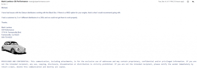

theczechone Posted December 5, 2018 Author Share Posted December 5, 2018 @lowrider @Enzo250gto Guys, a bit of bad news on the CB black box, i will dig down a bit deaper Quote Link to comment Share on other sites More sharing options...

lowrider Posted December 7, 2018 Share Posted December 7, 2018 On 12/5/2018 at 8:08 AM, theczechone said: @lowrider @Enzo250gto Guys, a bit of bad news on the CB black box, i will dig down a bit deaper @theczechone, I would be curious if this was using the stock inductive type dizzy or a points type. If I remember correctly (I don't want to spread misinformation) the 260Z dizzy had two inductive pickups, if that were the case I could see where that might cause problems. I would be interested in what you find digging deeper. Quote Link to comment Share on other sites More sharing options...
theczechone Posted December 7, 2018 Author Share Posted December 7, 2018 (edited) @lowrider I had similar thoughts, but if he had tried 3 or 4 different distributors I would assume he tried different types as well. i think my ZX dizzy should work well. I had also asked if he considered using this with an optical trigger such as the Crane/FAST xr700 but no response yet. Will update as i get more info. Edited December 7, 2018 by theczechone Quote Link to comment Share on other sites More sharing options...
