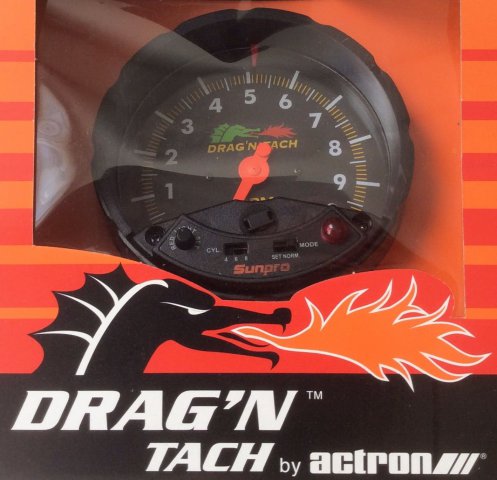

jvandyke Posted January 23, 2019 Author Share Posted January 23, 2019 We fired her up and the old Drag'n Tach actually still works. I had shorted out the bulb holder in it during an instrument lighting upgrade (LEDs). So for now I'm going to try to resurrect this abmonination. I tore it all down and a trace on the PCB was burned, I'll repair that and if it all still works and lights up then we'll live with it for now. It's one of these from the 90's (as is the whole car so I guess it's "period correct". BTW Does anyone have extra heater control cable clamps to spare? We're missing one. Quote Link to comment Share on other sites More sharing options...
