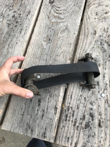

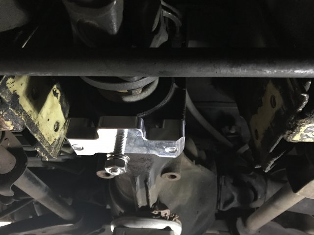

p7x Posted July 26, 2019 Author Share Posted July 26, 2019 (edited) 4 hours ago, Miles said: Just to be certain. These are the bolts you are working on: Yes they were... were as in I made a 3 foot breaker bar and that did the trick. Loud snap and I thought I broke the head off the bolt but once got about a quarter turn they were loose and hit them with the impact and came off / out no problem. Installed the new Mount easily and strap easily. Thanks for the replies and info. Edited July 26, 2019 by p7x Photo 1 Quote Link to comment Share on other sites More sharing options...
Miles Posted July 26, 2019 Share Posted July 26, 2019 The strap is no longer required. The stock rubber differential mount you replaced would flex and rip apart eventually. Nissan installed the strap to keep the nose of the differential from pitching up under load. For normal daily driving the solid mount works well. But the racers have reported that under hard driving the front cross member can crack and/or pull the center bolt through the cross member. I installed solid mounts in both of my Z cars 20 years ago and have not had a problem. Cars present us with lessons. The lesson is repeated until we get it and then we get another lesson etc etc. Quote Link to comment Share on other sites More sharing options...
p7x Posted July 26, 2019 Author Share Posted July 26, 2019 (edited) 12 hours ago, Miles said: The strap is no longer required. The stock rubber differential mount you replaced would flex and rip apart eventually. Nissan installed the strap to keep the nose of the differential from pitching up under load. For normal daily driving the solid mount works well. But the racers have reported that under hard driving the front cross member can crack and/or pull the center bolt through the cross member. I installed solid mounts in both of my Z cars 20 years ago and have not had a problem. Cars present us with lessons. The lesson is repeated until we get it and then we get another lesson etc etc. Ya I was tracking but replaced it as it was simple to do. UPDATE / Another lesson: The clunk is louder more pronounced than before. Worn diff mount might have contributed but now with the solid mount its exacerbated the clunk. Time to dive into the thread posted above and find the next item that needs tightening / replacing.... Thanks again for chiming in. Edited July 26, 2019 by p7x Quote Link to comment Share on other sites More sharing options...
