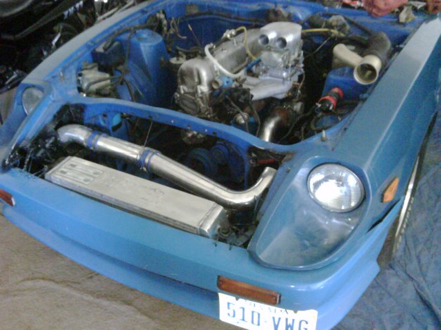

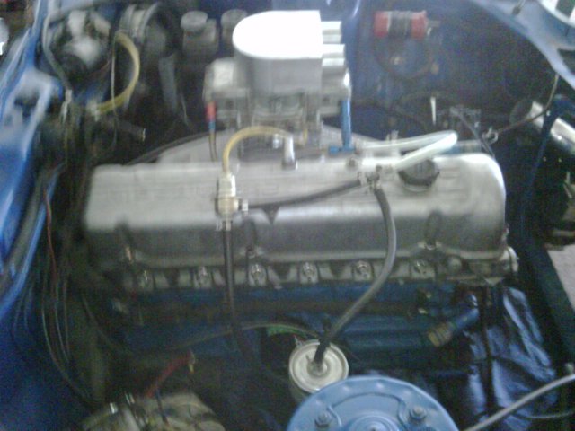

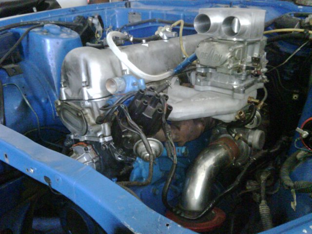

PanzerAce Posted October 29, 2009 Share Posted October 29, 2009 cool. Do you have any pictures available of the other part of the tank? Quote Link to comment Share on other sites More sharing options...
280zex Posted October 29, 2009 Share Posted October 29, 2009 I would like to see the whole assembley. For some research. Mabe there should be a sticky made up for blowthrough. I also have a design for twin turbo blowthrough using webber cabs. NOT tripple doubles but double tripples. I already have the carbs from another mid 70's twin turbo car. These webbers are for turbo charging!! What I need is the twin turbo exhaust manifold that TonyD posted up with. I have the pic but I'm not shure if its fotochoped or not. I'm shure someone has a TT exhaust mani or can make me one for a pair of GT25's...mmmmmmmmmm twin boost!!!!!!! Quote Link to comment Share on other sites More sharing options...
yetterben Posted October 30, 2009 Share Posted October 30, 2009 there was one for sale not long ago in fs section. Problem is they where made for rhd cars. They might not fit with are steering rack. there is nothing more to the tank really except a block off plate to cover what i showed you and a y inlet pipe. These tanks are not cheap and many of us dont want to disclose much about them Quote Link to comment Share on other sites More sharing options...
