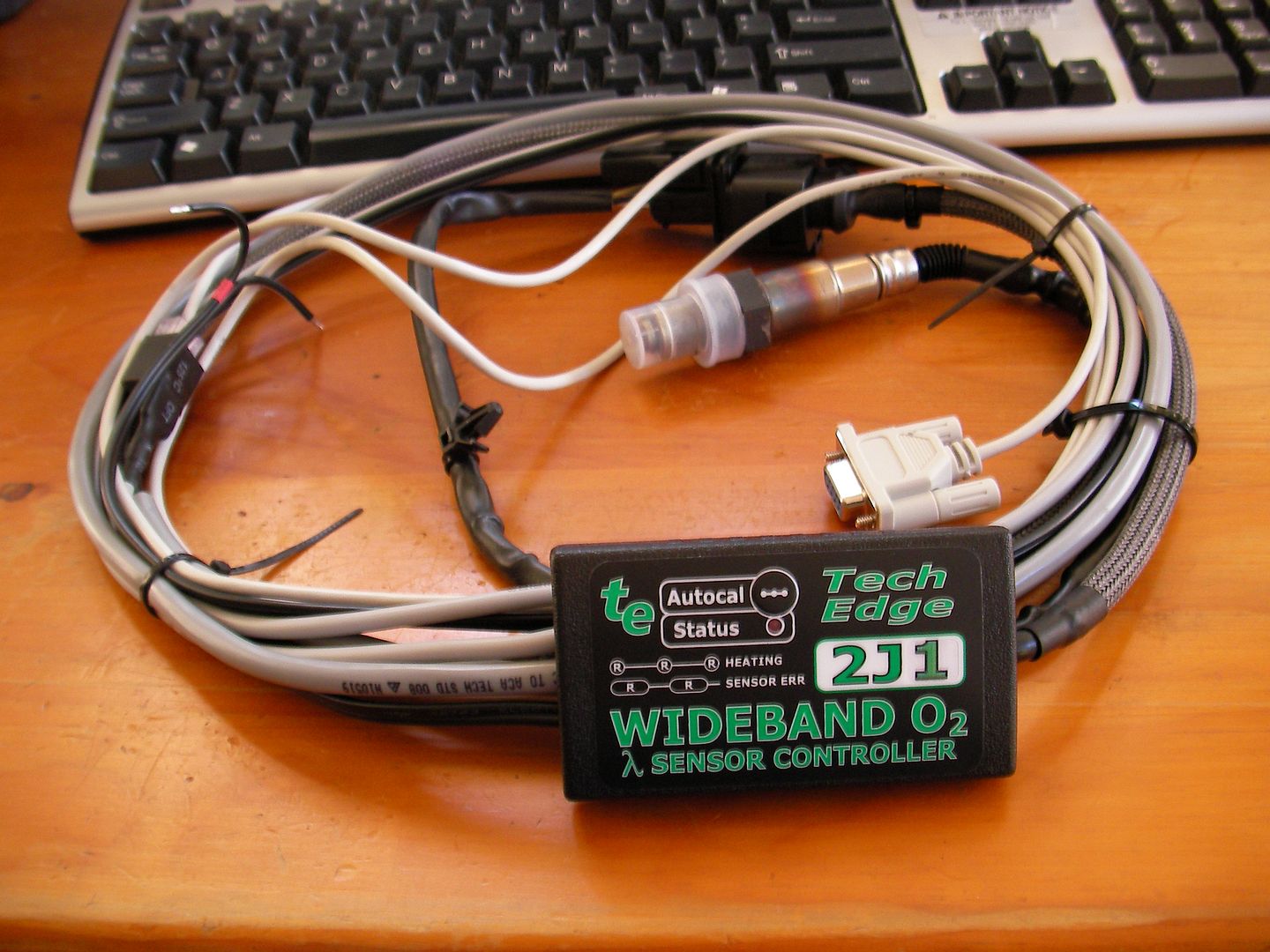

Speaking of wideband, I just bought one of these guys: http://www.wbo2.com/2j/default.htm
AU$256 (which works out to US$235 I spose) plus postage.
You can choose to buy the wideband with a display screen for real-time AFR, but if you want to use a laptop, the software that it uses is pretty simple. Just click one button to start recording AFRs before a run. It saves the result in a .txt file, which you can then cut and paste into MS Excel and have a chart against RPM.
I haven't installed it yet though, but plan to use to to fine tune my triples :)
