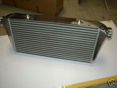

under 300 for big intercooler on ebay!!!!
stony
Looks like many of the other ones on ebay that go for ~250, same text atleast in the ad
"All of our intercooler has been tested to withstand more then 80psi pressure."
I've been looking at these units for some time, bar and plate, low psi drop, just how well do they cool?
I think I will pick one up with a ic piping kit from e-bay and stick it all together, let us know how it does Stoney :)
Where did you get yours at Sparks280zt? E-bay?
I actually got mine from a local shop here in town, but he sells them on eBay also. They are all the same thing, they come from asia and they are made from diesel truck cores that have ends tanks welded to them. Several people here in town have made over 400 hp with them.
I wouldnt, some people have success with those though, It all depends on what you want, if you want that polished aluminum pipe then i guess so. I am going with just normal steel and I am having it power coated. There is a great seller on ebay, do a search on his seller name UBendMan, he can hook you up with mandrel bends that you will need in any size. The rest of the pipe you can probally just buy at a hardware or auto parts store in town. I got all my bends and pipe for like $50 total. And like I was saying all those intercoolers on ebay that are cheap and arent name brand are all the same, so whatever is cheapest i would go with. Some sellers on there mark them up real high
Bar and plate design,
IF You ask me the only reason intercoolers are expensive is because HKS, Gready, garret or spearco puts there stamp in them. they all get there cores from the same place and weld end tanks on them for the applicable kit. This intercooler should be good for 800hp range just as the add says. if he wanted the standard 700-1000 for an intercooler this size i would have passed but 265 is a deal.

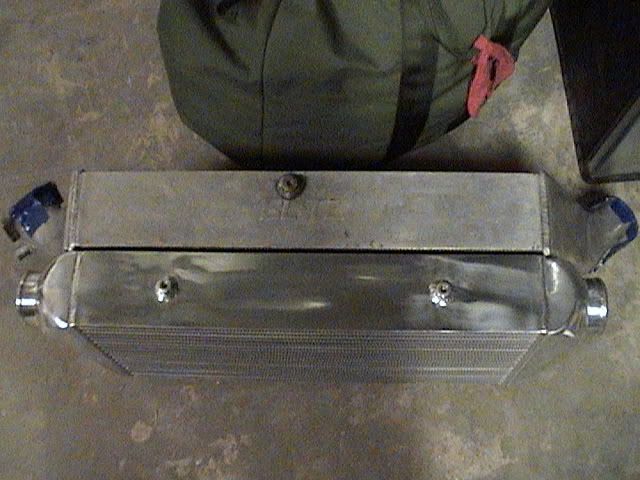

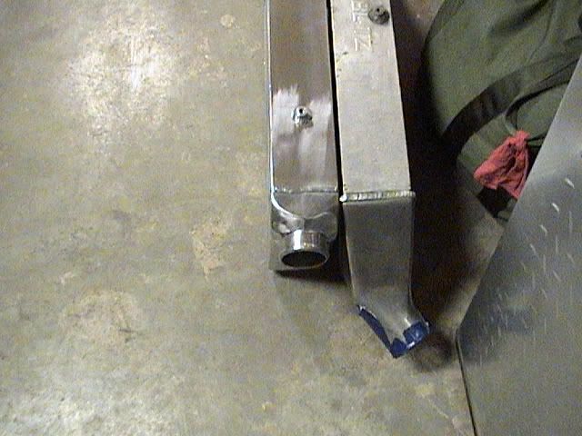

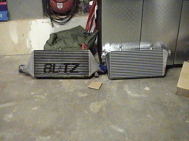

Woo got mine today, this thing is HUGE!!!! Even cutting the in/outlets out and welding 90's to it will still make it tight in a 83 zxt!! 4" wide looks very sick, no pictures yet (since it looks like above) but boy when I get it in there its going to look sick, very tight fit, only about 6" or so of a gap (12" tall) so its going to fit very nice.
Those look almost identical besides the end tanks! What skyline did that come off of?
