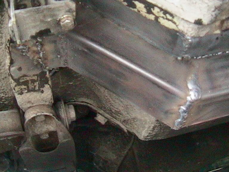

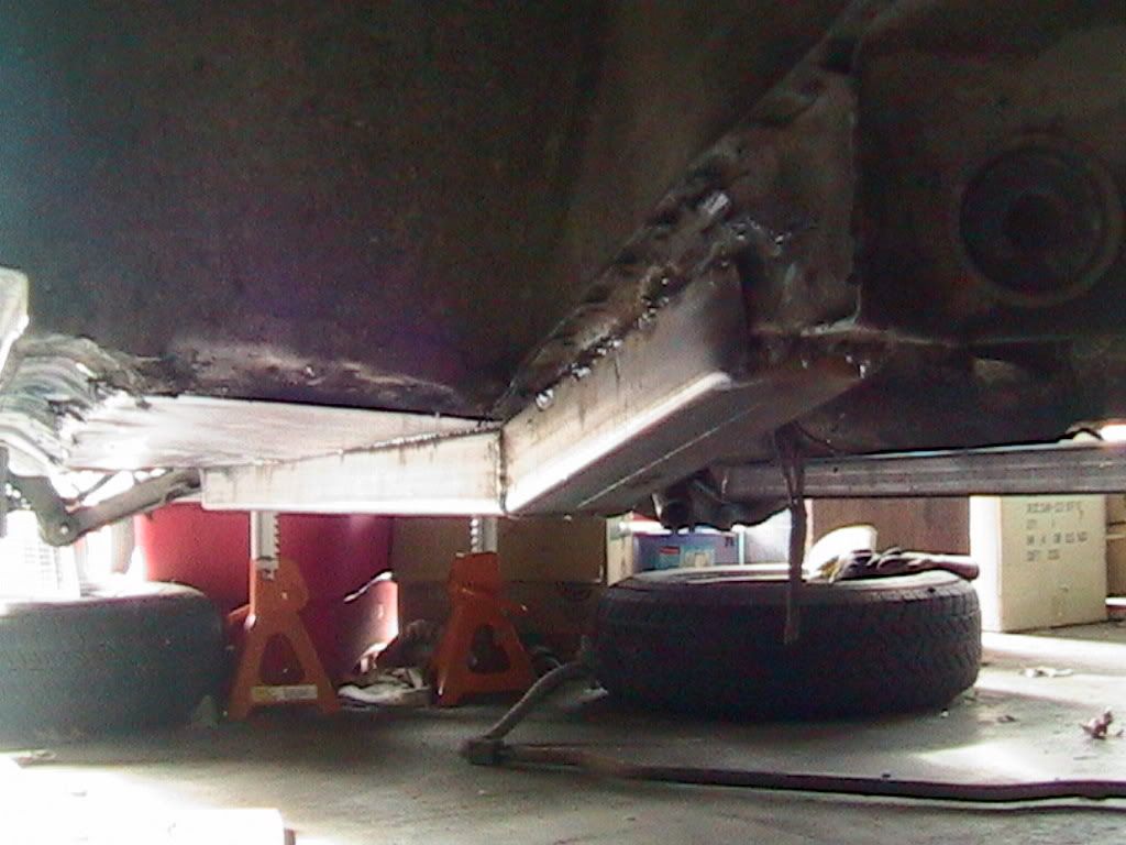

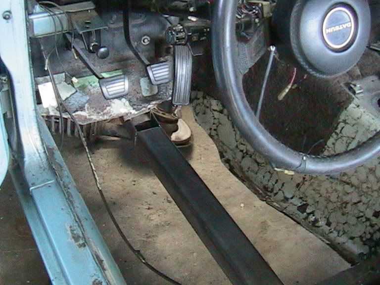

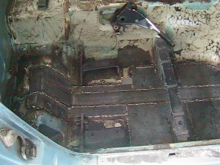

Sure, I thought these were up but I think the sony imagstation site isn't always working. Anyway, here are a couple of shots. I had to replace my floorpans so I installed the connectors after I cut out the floors and then tied in the new floors into the connectors. Everything is super rigid! I don't have a pic of the rails by themselves though... DOH! I used Pete Paraska's blueprints and modified them to work w/ my situation.
Test fit drivers side before welding everything up (you can see how it fits right over the front subframe).....
Shot of new floor pans and connector from the inside....
Underside from front to back, I basically cut the top off of the 2x3 tubing for the front pc so it would wrap around the existing frame. Cleaned and tacked and then finished seaming it all up. Takes a while due to the Z metal being crappy and thin...
Rear of connector, it's sectioned like pete's blueprint specs and fits around the rear subframe of the car....
