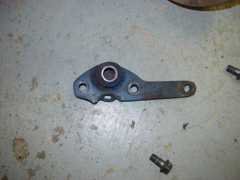

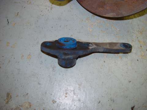

tube80z Posted June 25, 2006 Share Posted June 25, 2006 I thought that the "quick steering knuckles" were nothing more tham 510 stock knuckles. Am I mistaken? 510 arms will not bolt to the the Z unless you have ZX strut tubes. The spacing of the bolt holes is off by about 10 mm. 510 arms do have a twist but you could switch them side for side to gain ackerman. The problem is that they are longer than the stock Z arms. So I don't think you'd want to do this. Attached are a few pics of some arms that were built for a race car. These were flame cut from T3 steel plate. Another option for the DIYer. Cary Quote Link to comment Share on other sites More sharing options...
