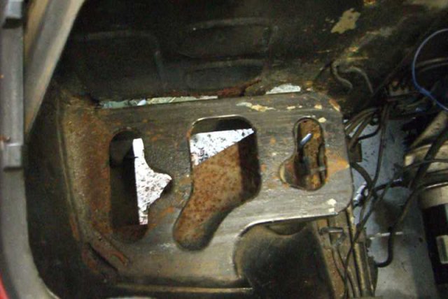

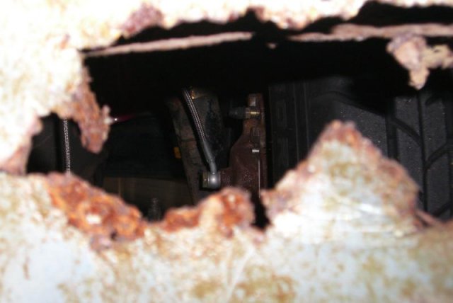

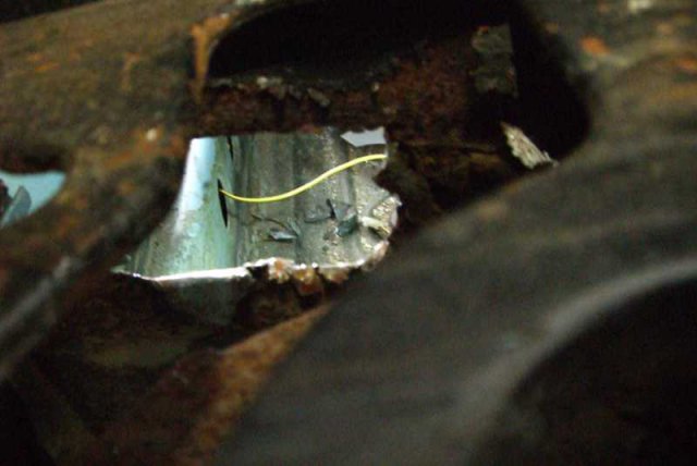

I knew I had rust under the battery and the vertical firewall in the wheelwell...just removed the inner lining and beat out the corruption. That and the passenger floorboards seem like the only big problems. I have a friend that said he will help me with replacing that stuff since he has a shop and a little MIG welder...I just don't have a welder at home...yet...
here is my corner of mull quality rust...at least the rest of the car is not this bad...
first is looking where the battery goes...
the second one is looking from the passenger seat...imagine doing a gravel rally and being the co-driver...lol
third is looking straight down at the battery support and nothing below it.
yep...I am going to be doing my flinstones conversion soon and redoing the floorboards and that passenger side frewall...
