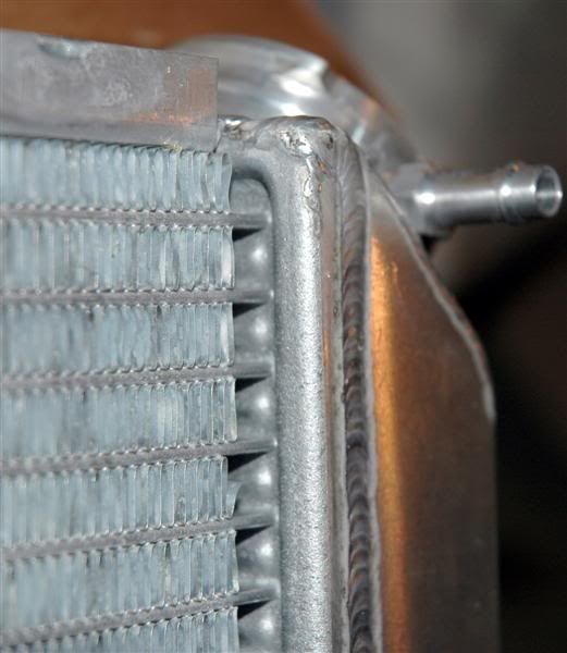

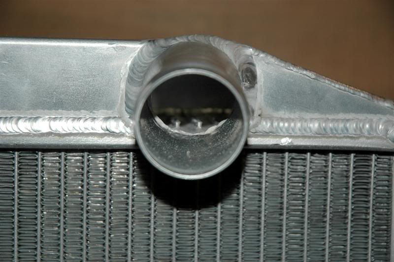

Administrators BRAAP Posted May 13, 2006 Administrators Share Posted May 13, 2006 We are a Ron Davis distributor and since 1997, all of the Ron Davis radiators that we have either used on our personal project Z cars or sold for V-8 and L-6 powered Z cars have been 100% welded and none have leaked, (or none of the customers have reported back to us with any leaking issues). I took one of the radiators out of our inventory that fits the ‘74 ½+ Z car with SBC, and took a few pics. It is hard to make out, but looking through the filler neck and both the inlet and outlet, these radiators use no epoxy and are indeed 100% welded. To our knowledge, Ron Davis has always been 100% welded, no epoxy, but that isn’t to say ALL Ron Davis radiators are this way, only the ones we have sold to customers and used our selves. As a side note, $800 seems pretty high for a Ron Davis radiator. Custom Radiators from Ron Davis made to our specifications for L-6 powered Z cars with specific inlet and outlets sizes, inlets and outlets angled to our specifications and with mounting tabs and another tab for mounting an aftermarket coolant recovery tank is less than $500. Is there a chance your radiator is a Be-cool or some other brand or is it just a “very†custom Ron Davis? As for mounting ANY radiator in a Z car that has had the chassis upgraded for improved handling and/or the car is driven aggressively, YES, the radiator should be mounted in such a manner as to be “free floatingâ€. Z cars are flexi-flyers and with aggressive chassis mods coupled with spirited driving, any radiator mounted as the OE intended will eventually get torn up, or at least have the mounting tabs ripped off. If you mount the radiator with two bolts at the top, that will allow it sway side to side as the core support racks back and forth, but that is only acceptable if there is ample room for the radiator to say without hitting the frame rails, which usually is not the case. We don’t offer “floating†radiator mounts, (though we may some time in the future), we leave mounting the radiator up to the individual customer. We do offer the radiators with the optional mounting tabs welded on the radiator tanks for mounting it to the OE core support, (as mentioned above), though we don’t recommend “solid†mounting to the core support , but to isolate or rubber mount it in some way, even using rubber grommets is better than solid mounting especially in Z cars that will experience heavy cornering or torsional loads. Here are some pics that sort of show the floating mounts I built for the Ron Davis radiator in my personal L-28 powered race Z. I machined some aluminum extrusion to accept rubber pads and then “captured†the radiator in those padded mounts so that it essentiality floats allowing the radiator core support to rack and flex all it wants without also trying flex and shred the radiator. Quote Link to comment Share on other sites More sharing options...
