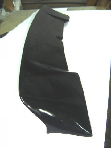

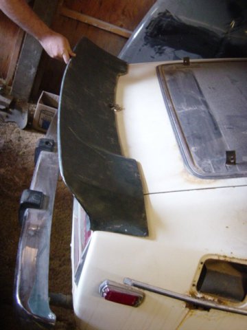

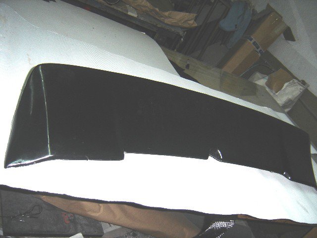

fazzt73 Posted June 6, 2006 Share Posted June 6, 2006 Hi guys just finished the mold and i will have this wing available if any of you are interested im shipping one to a fellow member in the next couple of days, so you will hear his opinion im sure, here are some pictures. PM me any questions you might have. Thanks, Paulo. Quote Link to comment Share on other sites More sharing options...
Corzette Posted June 6, 2006 Share Posted June 6, 2006 Paulo, looks good but how does it mount? Wouldnt it be better made in a three piece? Dont want to scrath the sides when opening the hatch etc. Whats the price? Terry Quote Link to comment Share on other sites More sharing options...
Lunar240z Posted June 6, 2006 Share Posted June 6, 2006 i second the 3 piece idear Quote Link to comment Share on other sites More sharing options...
OlderThanMe Posted June 6, 2006 Share Posted June 6, 2006 I would buy it as a 3 piece part...it looks very good. It will be interesting to see how well it mounts. Quote Link to comment Share on other sites More sharing options...
cygnusx1 Posted June 6, 2006 Share Posted June 6, 2006 I like the one piece design. You could put a small piece of clear Stonegaurd on the rear quarters to keep it from scuffing the paint. With three piece you always run into alignment issues and you end up drilling or bonding to the rear quarters....nevermind scuffing the paint. Quote Link to comment Share on other sites More sharing options...
WickedWild Posted June 6, 2006 Share Posted June 6, 2006 You could still get scratches from the wing flexing and vibrating under higher speeds. Not just from opening/closing the hatch. A thin felt on the underside of the wing over the rear quarters would prevent scratching. 1 Quote Link to comment Share on other sites More sharing options...
v8dats Posted June 6, 2006 Share Posted June 6, 2006 why not chop it after you buy it? Quote Link to comment Share on other sites More sharing options...
260DET Posted June 7, 2006 Share Posted June 7, 2006 A one piece is far better, the parts of it over the rear quarter can be relieved if they are likely to come in contact. A clearance of ~10mm should do it and that won't affect its effectiveness. Quote Link to comment Share on other sites More sharing options...
fazzt73 Posted June 7, 2006 Author Share Posted June 7, 2006 Paulo' date=' looks good but how does it mount? Wouldnt it be better made in a three piece? Dont want to scrath the sides when opening the hatch etc. Whats the price? Terry[/quote'] i like the one piece from a manufacturing point of view it the has 2 3/8" studs coming out from the wing they are placed to be acces from the inspection holes in the hatch, i will supply a drilling pattern this is a 1st genaration part it was modeled on top of the car the backside of the wing is a mirror image of the car. its fits like a glove, what i would use is double sided tape in the bottom of the hatch section that would give it the clearence and extra stiffnes. i dont think it will touch the sides if somekind of material is added between the wing and hatch, Thanks. Paulo. Quote Link to comment Share on other sites More sharing options...

wingnutthehutt Posted June 7, 2006 Share Posted June 7, 2006 Can you take some pictures from behind the car and from the side at the beltline so it's silhouetted please? Quote Link to comment Share on other sites More sharing options...

Dan Juday Posted June 8, 2006 Share Posted June 8, 2006 Molds get old too. They warp, distort, get sat on. New parts out of an old mold can be as bad as copies of copies of copies. I'm not really the spoiler/wing kind of guy but that looks nice. I second the request for more pics. And by the way: ...I have to spend every penny I make carefully on my car... Isn't that an oxymoron? Quote Link to comment Share on other sites More sharing options...

phantaz Posted June 10, 2006 Share Posted June 10, 2006 looks great.... definately a stand out.. great job. and yea more pictures please =0) Quote Link to comment Share on other sites More sharing options...
