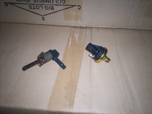

i had my 79 setup like that... it worked out beautiful, at like 8~9psi, no intercooler.
-hobbs switch on the csv, set at 3psi.
-locked mechanical advance (set at 19~20deg. at idle)
-didnt really mess with the afm, as it cuts out by 3500ish rpms, and the 7th injector took care of the rest.
i should have upped the fuel pressure, but the plugs were nice and brown, so i figured whatever...
worked like a champ! and then sold it only to do it again in an s30..!
I think he means the CSV is the cold start injector. A hobbs switch is a pressure actuated contact switch. You can buy them pretty cheap in different pressure actuations and contact patterns ( normally closed or normally open contacts). A normally open switch set at 3psi would close the electrical contact at around 3psi to send power to and actuate the cold start injector for extra fuel. most of the hobbs switches have 1/8th NPT threaded ends for installation. Hope that helps

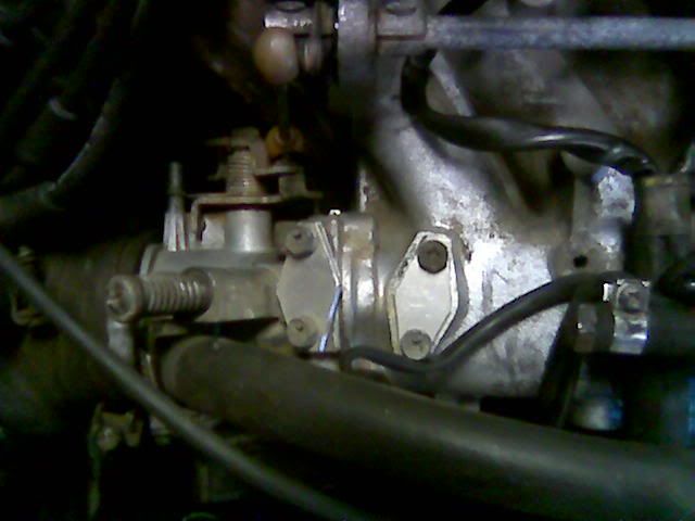

the cold start valve is right behind the throttle body on the intake. it has a 2prong clip like a notmal fuel injector. I ran the hobbs switch on the power side of the csv, so when i hit 3psi, it completed the power to the csv. the other wire just grounds it.
so yes... there were 7 injectors.
tonyD informed me in a very good email that this setup makes good for 8~9psi, and i think less during the winter.
the csv is on the left, hobbs switch on the right.
and the csv is located where that blockoff plate to the right is.
hope that explains a lot!

Thanks for the pics, but I have a question. You said you ran the hobbs switch on the power side for the csv. Where did you get power from?(random wire from battery?) You make it sound like you ran it in series with whatever power wire there was, which would mean it would only turn on when you were starting(cold start) and you were hitting 3psi.
