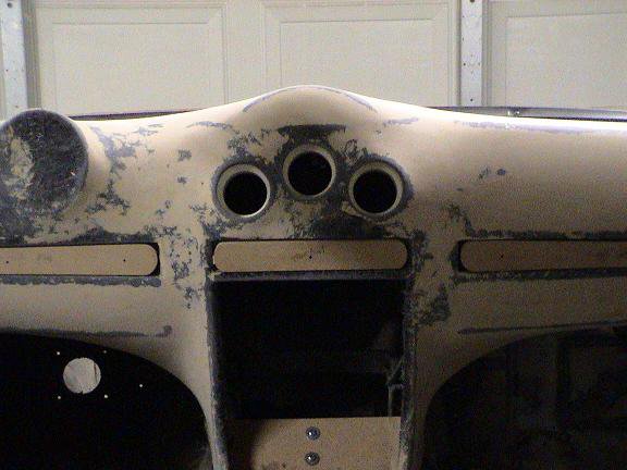

olie05 Posted September 25, 2006 Share Posted September 25, 2006 what is that little hump for on top of the center gauges? It looks kind of wierd, so I'm assuming it has a functional purpose as opposed to a design one. A clock maybe? Quote Link to comment Share on other sites More sharing options...
Guest Aguyandaredhead Posted September 25, 2006 Share Posted September 25, 2006 You got it, I plan on using one that came out of the Skyline clip I bought. That area will be smoothed and round whith it recessed.. Jeff Quote Link to comment Share on other sites More sharing options...

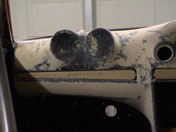

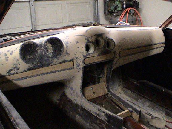

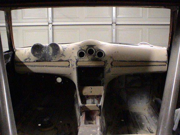

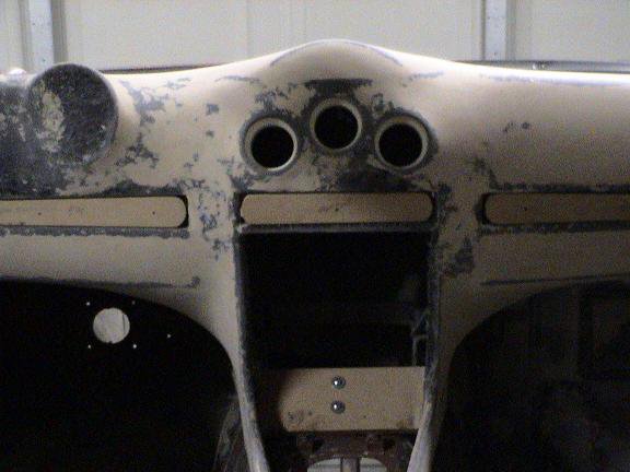

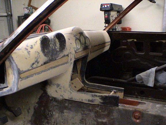

Guest Aguyandaredhead Posted October 2, 2006 Share Posted October 2, 2006 Ok a day late, but more pics as promised. My dang arm is tired and I am staring to loose my finger prints on my right hand. Even though this is supose to be a skim coat so I can pull it out and finish sand it out of the car I figured I might as well try and get it as close as I can in the car. I have used about 3/4 of a gal of lightweight body filler but as you can see from the pics there really is not that much left on the dash. It is mostly on the floor and you can see the glass in many places.I also have to fill the recesses where the trim pieces go at the ends to match the shape at the ends, then skim over the top of the trim pieces and sand to match the shape of the dash so they are not just flat. I will put a very thin skim over the whole dash just before I prime it and finish it off with 220 and then 360. At that time I will have to decide on the finish. Oh well, Enjoy.. How about some help deciding on the final finish. Wrap the entire thing in Black Suede (of which there will be other pieces in the car done) and do the inserts in Carbon fiber. Overlay the entire thing in Carbon Fiber and finish with a UV-Clear Surfboard resin finished down to 2000grit and then buffed to a high gloss (of course I will have to spray the top with a Matte agent to reduce glare) then paint the inserts body color. And Finally the Paint it Body color and then wrap the trim in Carbon Fiber. Ok I think they all would look good nut I can't decide. I know which ones will take less time, but I am trying not to let that play a roll in the decision.. Thanks and happy Looking. Jeff Quote Link to comment Share on other sites More sharing options...
Guest Aguyandaredhead Posted October 2, 2006 Share Posted October 2, 2006 A few more.. Jeff Quote Link to comment Share on other sites More sharing options...

olie05 Posted October 2, 2006 Share Posted October 2, 2006 How are you going to deal with the steering column finish? Are you going to use the stock nissan piece? it doesn't look like the column will integrate with the way the dash is laid out. Quote Link to comment Share on other sites More sharing options...
EZ-E Posted October 2, 2006 Share Posted October 2, 2006 Now what would Car and Driver say to that, no cup holders lol. I think the dash is looking really good. Do you plan to have a glove box or are you deleting it completely. I think the design is sound and its really coming together nicely. Im loving how its starting to come together and look. Quote Link to comment Share on other sites More sharing options...
Guest Aguyandaredhead Posted October 2, 2006 Share Posted October 2, 2006 I will cut out the circle for the steering column and insert a fiberglass tube that has been cut to a half circle. I will do that last. I think I agree all Carbon will be too much. I like the idea of the suede as well with carbon inserts. I have seen the carbon kevlar and I think the yellow will clash with the rest of the int. Nope no glove box, I decided to put the vents on the bottom of the dash as well. I only kept the defrost in the stock location. A glove box will only hold more crap ie.. Slow me down, HAHA.. Jeff Quote Link to comment Share on other sites More sharing options...
