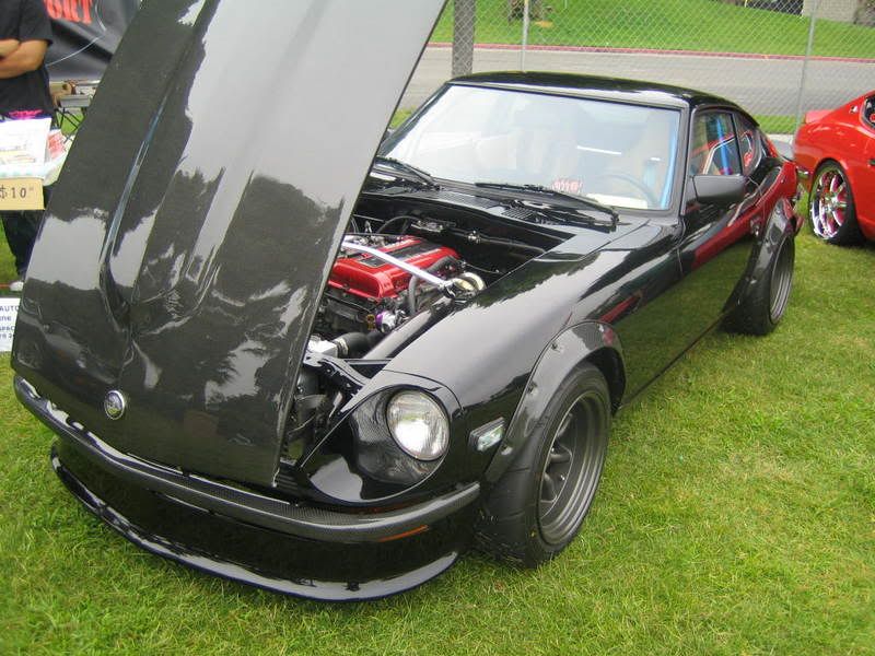

the mirrors are the flush mounted mirror kit from MSA:
http://www.thezstore.com/page/TZS/PROD/FMM/50-1160
More pics are available on our website as well. Here is a spec sheet of the car:

I saw you did this dash twice - here and on the black car pictured in the post above. Was it just bondo/fiberglass to mold it to that shape, then covered? Or did you do something different? Any pics of that in-process?
-Bob
the dashs were made by the previous owner of the red z which was a custom sound/video shop. Sorry no pics of in progress on that
The CF bumpers are from MSA and they did feel a bit lighter than the fiberglass ones but damn fitting them was one hell of a PITA
