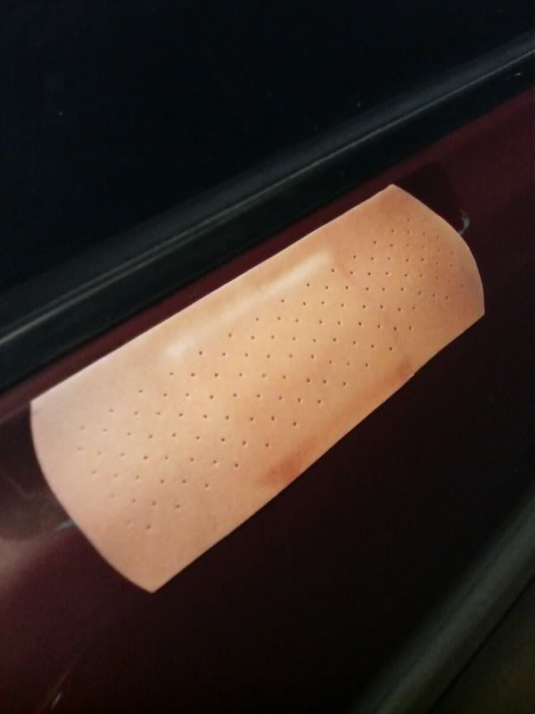

gokiburix Posted October 4, 2007 Share Posted October 4, 2007 well...for my temporary fix until i get my door repainted ... ...(drum roll)... Quote Link to comment Share on other sites More sharing options...
buZy Posted October 4, 2007 Share Posted October 4, 2007 ok...so does anyone have any pointers to do a spot patch? How about make an ABS cap. 1/8 ABS profiled to fit, break the rough edges/crown and paint your favorite color. Paint sticks to ABS great. Mount with 3M VHB tape at ACE hardware. Covers the holes, Seals from Water, NO body work and very easy and Cheap. I am on this one soon as my door mirrors are horrible and useless. Good fix untill the doors are repainted. Quote Link to comment Share on other sites More sharing options...
