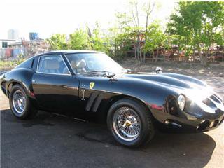

Con Brio Posted June 20, 2008 Share Posted June 20, 2008 Here are some pics...the headlight trim rings are still out for chrome, but everything else is in place Quote Link to comment Share on other sites More sharing options...

Zerrari GTO Posted June 21, 2008 Share Posted June 21, 2008 Yeaaaaaaaaaa! pics! It looks goooood (you need to make the pics larger). I love seeing the different interpretations of this car. Con Brio, you have gone the way I'm taking my build, kind of what this car might be if Enzo decided to produce the 250 as a street car and add it to the Ferrari line-up. Mine of course will have the convertible option which did not come out until 65' I love the grill you chose. It has that 60's Aston Martin, Ferrari, Jag feeling...very cool. Quote Link to comment Share on other sites More sharing options...
SidWell Posted June 23, 2008 Share Posted June 23, 2008 I have been considering ways to make the car look a little more current without violating the overall appearance of the car. I do like what you did with the grill. What did you use for grill material? Not that I would copy it, but, it may give me other ideas. Quote Link to comment Share on other sites More sharing options...
Con Brio Posted June 24, 2008 Share Posted June 24, 2008 Thanks guys... The grill was surprisingly easy to fabricate. I used a piece of 2' aluminum stock, needed about 8'. Then cut it into lengths, notched it and welded the joints on the backside. Then to eliminate any irregularities I ran a sander over the front to level it out. Took the idea/design from some of the later models (348 etc). To do it again I would have made the holes (rectangular openings) a little bigger, 1/4 inch wider. And started with a strip in the centre working my way out. Quote Link to comment Share on other sites More sharing options...
