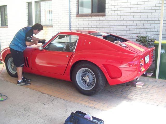

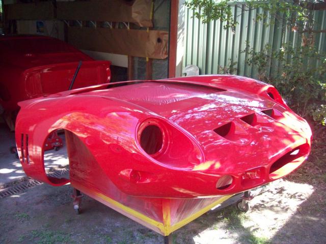

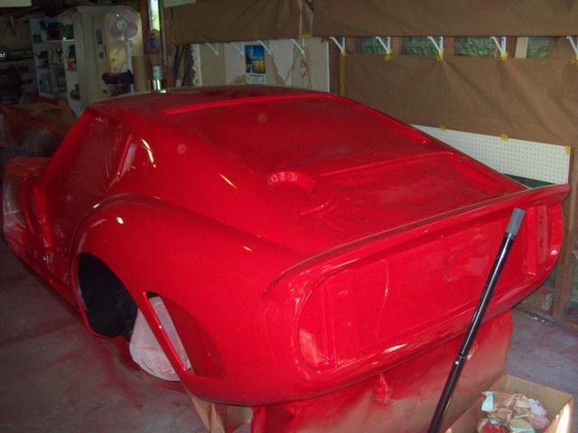

Boy from Oz Posted December 9, 2018 Share Posted December 9, 2018 (edited) With everything done to the bodywork that I'm prepared to do, the time came for the final painting. The original light coating - to seal the primer while a 12 month assessment was carried out - was rubbed back. Final coats applied Then rubbed back with 1000, then 2000 and finally 3000 grit wet-n-dry. I'd pushed my luck about as far as I was game by this stage so I engaged a professional car-detailer to do the final buffing. Really pleased with the outcome. Edited December 9, 2018 by Boy from Oz Quote Link to comment Share on other sites More sharing options...
chelle Posted December 9, 2018 Share Posted December 9, 2018 (edited) It's looking amazing!!!!! Thanks for sharing! Is it okay if I share these with the GTO replica fans on our Facebook group ? Edited December 9, 2018 by chelle Forgot to ask if I could share Quote Link to comment Share on other sites More sharing options...
Enzo250gto Posted December 9, 2018 Share Posted December 9, 2018 Looking good. Very impressive. Paint looks a million dollars.💰 Quote Link to comment Share on other sites More sharing options...

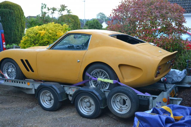

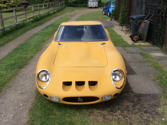

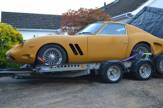

Jeff H Posted January 25, 2019 Share Posted January 25, 2019 On 1/25/2019 at 7:26 PM, chelle said: Can't wait to see your progress pics! Expand Hi Chelle, I was very impressed with your car, I actually had a few pics of it from the net before I saw it on here and Face Book. These pics are from the advert and I have only really stripped the car down and taken the primer off. Quote Link to comment Share on other sites More sharing options...

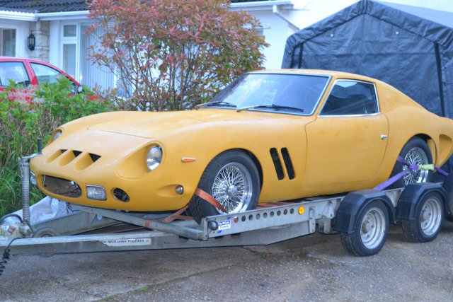

Jeff H Posted January 25, 2019 Share Posted January 25, 2019 And these are when I got it home. Quote Link to comment Share on other sites More sharing options...

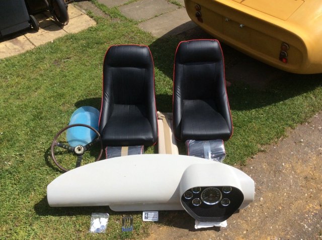

Jeff H Posted January 25, 2019 Share Posted January 25, 2019 Sadly the gauges are all labeled Smiths, A very common gauge over here, I am hoping to cheat a bit and get them re labeled, I also got the hard to find parts with car like the headlamp covers and stainless rims plus the bonnet fixings and perspex vents. It also has the correct Marchal spot lights and the correct wing repeaters, the rear lights are BMC Mini so they will be replaced, I do have a set of Hillman Imp ones which may suite better. The car drove on and off the trailer ok so I am hoping to not have to get too involved with that side of the build. Quote Link to comment Share on other sites More sharing options...
chelle Posted January 25, 2019 Share Posted January 25, 2019 Thanks! The nose on yours looks more like an Alpha1 that someone cut the hood down on though. I'm going on the shape of the carious openings in the nose and the shape of the area around the parking lights, primarily. Looks like a great start!! Did you join the Facebook group too? Quote Link to comment Share on other sites More sharing options...
Jeff H Posted January 25, 2019 Share Posted January 25, 2019 Hi Chelle, Yes I have applied to join the FB group it is pending at the moment. The chap I bought the car from extended the hood toward the screen which i do think suits it quite nicely. Quote Link to comment Share on other sites More sharing options...

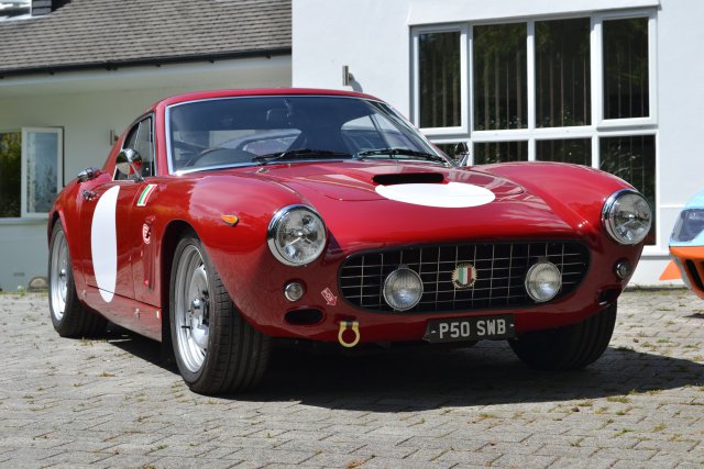

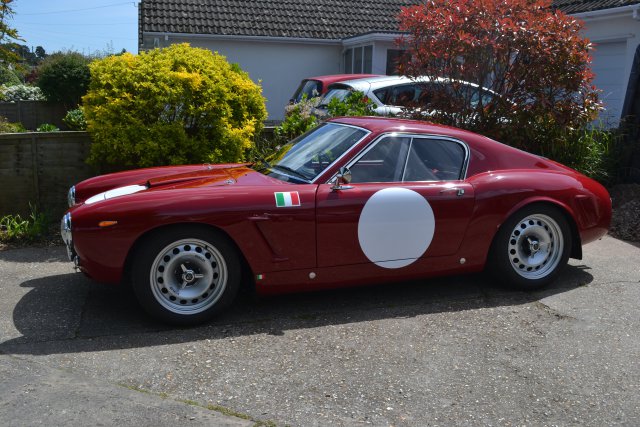

Jeff H Posted January 27, 2019 Share Posted January 27, 2019 On 1/27/2019 at 12:33 AM, Boy from Oz said: Welcome Jeff. Always great to have a new member and vehicle. I'm fascinated by the prospect of a 250 SWB kit. Although it sounds like it was some time ago I'm sure we would all appreciate any information and photos you may have. Thanks. Expand Hi Peter, Thanks for the welcome, I fully read your build thread yesterday from the link you gave me, I am so tempted to mod the doors on mine to make them look more original, I wont be extending the wheelbase as Chell has done as that is a massive undertaking. The 250 SWB was a kit from Tribute over here in the uk, some of you may be familiar with them ? they do the GTO kit for the Mazda MX5 (Miato) that was actually taken from a Scorpian kit and then cut n shut to fit the Mazda, it is IMHO another one that doesn't work (No offence to anybody who has one) as the front is too short and the roof too long. The SWB was based on a BMW Z3 Convertible, the quality of the kit left a bit to be desired but it was in fact a very clever and well thought out kit, we are able to register them properly over here as a rebody so no expensive and time consuming IVA test required. I altered the kit quite a bit on mine, they were designed for a MGB Coupe rear screen to be fitted these were too recessed and too small so I changed that, I also raised the doors and sills as you have done, I also put a curve in the door to try and get it to look a bit more original. The front end on the SWB was far too short but their was nothing I could do to overcome that , also the screen angle was miles out but again it was never intended to be an exact replica more of a look a like, I did square the body off at the top corners of the screen and fitted a moulding to reduce the slabbiness of the screen. Any way I realize I am rambling on and don't want to spam up the thread with pics that are not GTO so will put a few up and leave it at that. Quote Link to comment Share on other sites More sharing options...

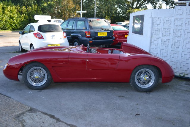

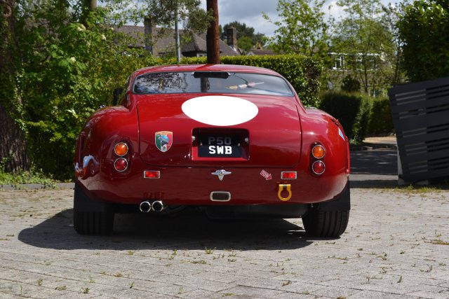

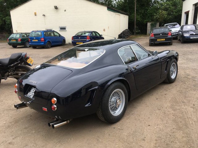

Jeff H Posted January 27, 2019 Share Posted January 27, 2019 (edited) This was my 250 SWB attempt. Edited January 27, 2019 by Jeff H Better pics Quote Link to comment Share on other sites More sharing options...

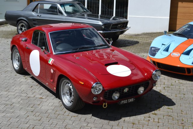

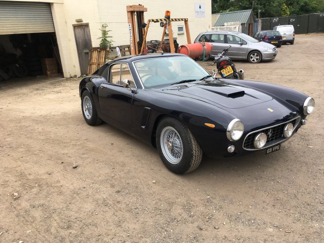

Jeff H Posted January 27, 2019 Share Posted January 27, 2019 And this was one that I built for a customer, he went the whole hog and fitted Borrani wheels and had me fit a genuine SWB rear screen, we also modded the doors and sills on this one to, also moved the fuel filler to the other side. Quote Link to comment Share on other sites More sharing options...
Boy from Oz Posted January 29, 2019 Share Posted January 29, 2019 Jeff, they are a couple of very impressive examples, I'm anticipating something special from you on the GTO. You seem to have a similar issue with modification limits as we have down here. Stretching the wheelbase (a la 'chelle') would require extensive testing and re-engineering approval. Quote Link to comment Share on other sites More sharing options...

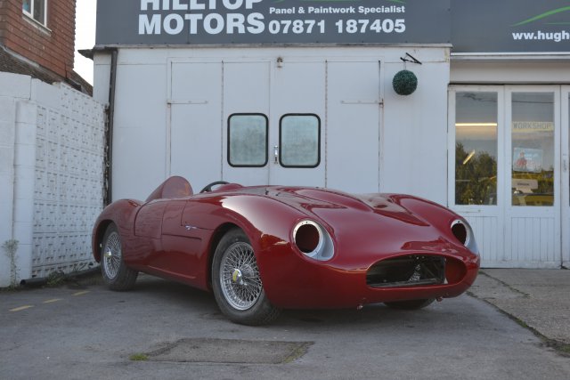

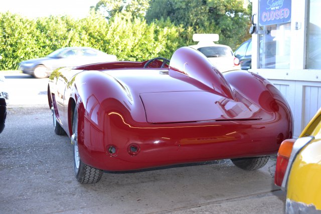

Jeff H Posted January 29, 2019 Share Posted January 29, 2019 Hi Peter, Yes under the rebody rules we are not allowed to cut in to the chassis or monocoque of the vehicle, once we do that we are in for a world of pain and have to go down the IVA route. People do of course snip the odd bit off here and there like brackets and have to cut holes to re route pipes etc but it is no major drama. This is a kit I painted for a chap local to me who makes the Formosa 120 GR, it is a rebody for a Herald or Vittesse and uses the original bulkhead for the pedals, servo etc, he also makes them fit the Scimitar which is a good doner. Quote Link to comment Share on other sites More sharing options...
