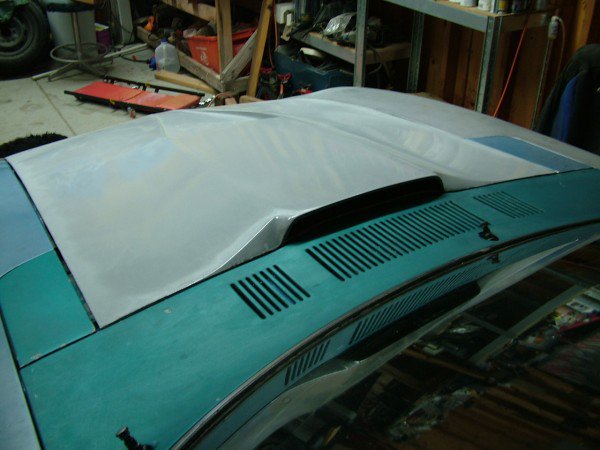

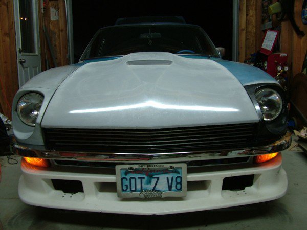

Bartman Posted November 13, 2006 Share Posted November 13, 2006 So I have four hoods now, but I think this is the one I'm going to wind up using. It took some time, but it's completely installed including the factory latch and hinges. In general the hood is pretty cool, but I wish it would have come with rolled edges. Quote Link to comment Share on other sites More sharing options...
Guest 280ZForce Posted November 13, 2006 Share Posted November 13, 2006 looks sweet! i like that SS look. you gonna open up the vent up front or leave it closed up? Quote Link to comment Share on other sites More sharing options...

Guest ZFury Posted November 13, 2006 Share Posted November 13, 2006 looks sweet! i like that SS look. you gonna open up the vent up front or leave it closed up? I thought that scoop looked useless. Quote Link to comment Share on other sites More sharing options...

Bartman Posted November 13, 2006 Author Share Posted November 13, 2006 I'm not planning on opening up the front, because there would be no benefit...in fact it would probably be a hinderance. I think the rear vent will help allow the heat to escape at low speed conditions. My air intake comes from under the hood before the radiator support, so the front vent wouldn't help for my install. I do want the front vent to appear open at a distance, so I will likely paint the front vent area flat black or something similar. Quote Link to comment Share on other sites More sharing options...
AK-Z Posted November 13, 2006 Share Posted November 13, 2006 I'm not planning on opening up the front, because there would be no benefit...in fact it would probably be a hinderance. I think the rear vent will help allow the heat to escape at low speed conditions. My air intake comes from under the hood before the radiator support, so the front vent wouldn't help for my install. I do want the front vent to appear open at a distance, so I will likely paint the front vent area flat black or something similar. Wasn't there a whole thread on this? Like aerodynamics of something? Thought I remember someone saying that there is a high air preasure area at the base of the windshield and a "lower" high preasure inside the engine bay, causing air to enter the engine bay from the rear (cowl induction hood). Quote Link to comment Share on other sites More sharing options...
COZY Z COLE Posted November 13, 2006 Share Posted November 13, 2006 This was an interesting read on cowl hoods and over heating problems... http://forums.hybridz.org/showthread.php?t=113540 LARRY Quote Link to comment Share on other sites More sharing options...
Bartman Posted November 13, 2006 Author Share Posted November 13, 2006 Wasn't there a whole thread on this? Like aerodynamics of something? Thought I remember someone saying that there is a high air preasure area at the base of the windshield and a "lower" high preasure inside the engine bay, causing air to enter the engine bay from the rear (cowl induction hood).Yes, there has been several discussions regarding this, but I'm more concerned with low speed venting. Without much speed to create this high pressure area, it comes down to the simple fact that hot air rises and the rear vent allows this heat to escape. Quote Link to comment Share on other sites More sharing options...
Bartman Posted November 13, 2006 Author Share Posted November 13, 2006 Bartman, Looks good! That's the same hood Bil aka 93awdgsx has on his car except I believe his is CF. Unfortunately I cannot find the the link where he shared some pics. Is that the Kaminari air dam? I see lines drawn on the foglamp holes - will you be doing some mods to this? Ernie/RacerX awd92gsx has the exact same hood, but he painted his black.http://forums.hybridz.org/showthread.php?t=101130 The airdam is the Kaminari unit, and I'm not planning on any other mods to it other than installing some fog lamps. I'm thinking smaller oval units instead of the big ones that it was originally designed for. A special thanks to boate for making me a great deal on the hood. Quote Link to comment Share on other sites More sharing options...

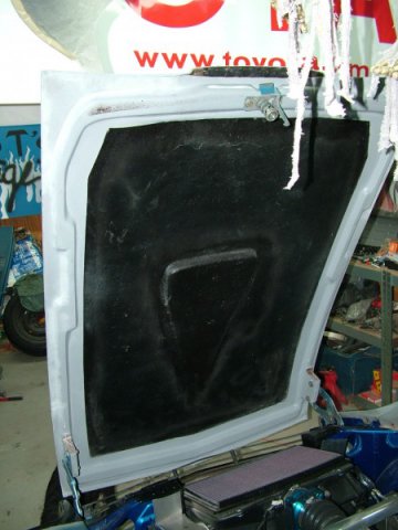

Bartman Posted November 18, 2006 Author Share Posted November 18, 2006 So I've got the hood installed using the stock hinges (with the springs removed), and I have a little problem. When I drive the car the under hood pressure pushs the hood up a little. It really bugs me to see the hood higher than the fender while I'm driving. When I stop I can push the hood back down, but when I'm driving it stays up. The only solution I can think of is to put in a couple of hood pins on top of the radiator support. Anyone else have any other suggestions? Quote Link to comment Share on other sites More sharing options...
280Zone Posted November 18, 2006 Share Posted November 18, 2006 Where along the hood is it lifting? I think you ended up with a hood I sold to a local guy that ended up selling his car with the hood. I am trying to remember which configuration he requested. Quote Link to comment Share on other sites More sharing options...
buZy Posted November 18, 2006 Share Posted November 18, 2006 So I've got the hood installed using the stock hinges (with the springs removed), and I have a little problem. When I drive the car the under hood pressure pushs the hood up a little. It really bugs me to see the hood higher than the fender while I'm driving. When I stop I can push the hood back down, but when I'm driving it stays up. The only solution I can think of is to put in a couple of hood pins on top of the radiator support. Anyone else have any other suggestions? Is there any way to fasten the hood like oem with mods? Just wondering as I see you still have stock latch on the firewall. Quote Link to comment Share on other sites More sharing options...

Bartman Posted November 18, 2006 Author Share Posted November 18, 2006 Where along the hood is it lifting? I think you ended up with a hood I sold to a local guy that ended up selling his car with the hood. I am trying to remember which configuration he requested. The hood is lifting at the front hinges. The hood itself is not bending at all, it is raising up because the hinge is raising up. I probably do have the hood your talking about. I got it from boate who told me that it came with his car. Is there any way to fasten the hood like oem with mods? Just wondering as I see you still have stock latch on the firewall.It is fastened like oem, and it works fine except for this lift that I think is caused because the hinges no longer have the springs to keep them down when closed. Quote Link to comment Share on other sites More sharing options...
280Zone Posted November 18, 2006 Share Posted November 18, 2006 Bartman, Can you email me a close up picture of the hood mounted to the hinges? I just went and tried to pull up on my hood and I get a little bit of movement due to hinge "sloppyness". It only moves about 1/16". The missing hood springs should not be causing the problem since they are only for holding the hood up. I don't have my springs in either. Quote Link to comment Share on other sites More sharing options...
