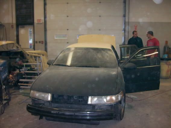

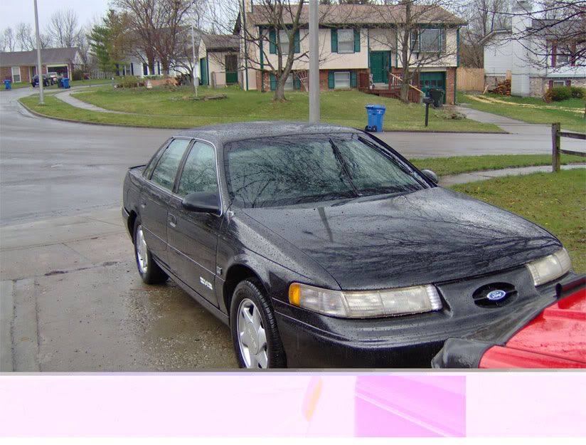

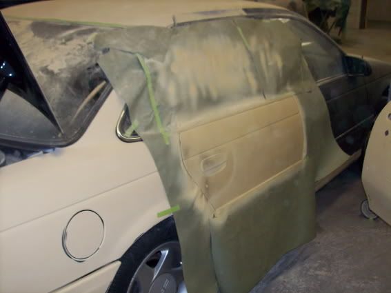

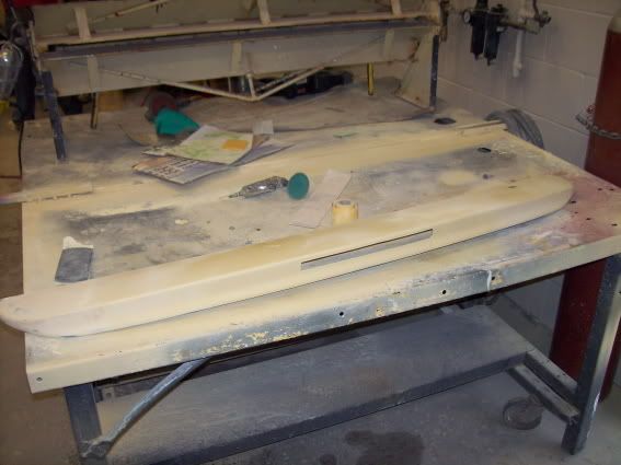

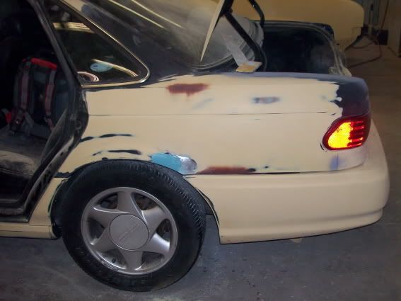

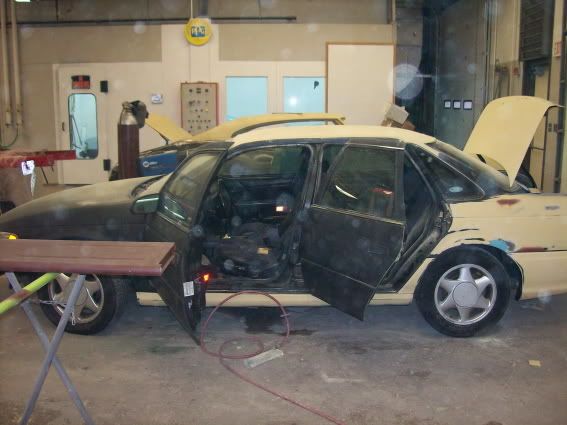

MusPuppis Posted November 17, 2006 Share Posted November 17, 2006 Still body working the poor thing. Rags saw it a while back and it looks a *little* better now. We can all thank a hit and run in Wal-Mart parking lot for this.. I dont get alot of time to work on it, nor do I have the money when I have the time, but I'm making a push to get it done, or as done as I can manage by the end of this month. We (by we I mean three guys at school who are actually worth a damn and myself.) finished the body work up today, less the spoiler from hell and the front bumper from somewhere beneath hell. Monday when I get to school I'l turn the body over to Bryan, Jordan and Bob who will put the final primer coat on everything you see in the pics that isnt black while I sort out the front bumper and spoiler.. If they go well I'll have them in primer by the end of the day.. Next day is wetsanding, then sealing. Now, annoyingly enough, sealing will be the last thing i do for quite a while. Its just to even the color out and protect the primer and body work. Also make the car look more 'complete' since its actually going up for sale as soon as its in sealer.. 1500$ unpainted but ready, 2000$ once I get color down. When it comes time to paint all I'll have to do is scuff up the sealer and lay another coat before paint. Interestingly enough, I was in school for over 13 hours yesterday.. On my way to school one of the motor mounts finally gave out. They've been dieing for a while and basicly surviving by the limiters.. One of the limiters failed.. So, after I got some space in the shop and finished what I had to do on a couple little minor things in the shop I pulled it in and we pulled the mounts out, I re-welded the limiters and put some pretty tough and large bolts through the mounts to sandwich them back together. Its not perfect but its about as good as stock would have been, slightly better really. New mounts for this car are extremely expensive, so.. they got repaired instead of replaced. It took from noon-ish to 8pm to accomplish it. Those mounts are JAMMED in there, jeebus. Oh.. ha, color? Dunno. Maybe black pearl like on the Z, maybe that kinda off-black on some Mercedes I see or maybe just plain old friggen black, ha. Ya know, one of these cars done in (I beleive this is the correct name) Parchment White Pearl would be dope. If you've seen that white on some new caddies and escalades that almost has a pink hue to it in good light? Thats the color.. Would look great on a SHO but my car was already black, so I dont want to go through a whole color change just to sell the damn car. I'm hoping the spoiler works out. It was shattered. Not cracked.. shattered.. So i ground out the back of the spoiler, building channels along the cracks that i filled with fiberglass resin and laid over with mat, then on the other side I ground down channels along the cracks and filled them with semi ridged bumper repair gook, sanded them flush and coated with filler. I tried just coating with filler but the cracks on the outside re-appeared immediatly, so i chose to go with something that would adhere to the plastic and hopefully keep the cracks from re-appearing. Very similar repair planned for the bumper, except I'll be using the bumper repair gook all around, no fiberglass (bumper is ultra flexible). Quote Link to comment Share on other sites More sharing options...

MusPuppis Posted November 19, 2006 Author Share Posted November 19, 2006 haha, nice. It'll be black for sure. I really would like it plainted that parchment color, but I'm not going through the trouble of a complete color change and the hell of trying to get that engine bay one color when all I intend to do is sell the car.. oooohhh no. It was black before and by god its gonna be black again, haha. They do look sharp in black to. I need to take a trip to a Mercedes dealer, or track down my aunt. She has a sharp Benz thats an off-black that I really like. Its pretty much solid but has a very very light tint of grey to it, I'd like to get the color code and give it some thought. Quote Link to comment Share on other sites More sharing options...

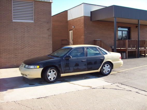

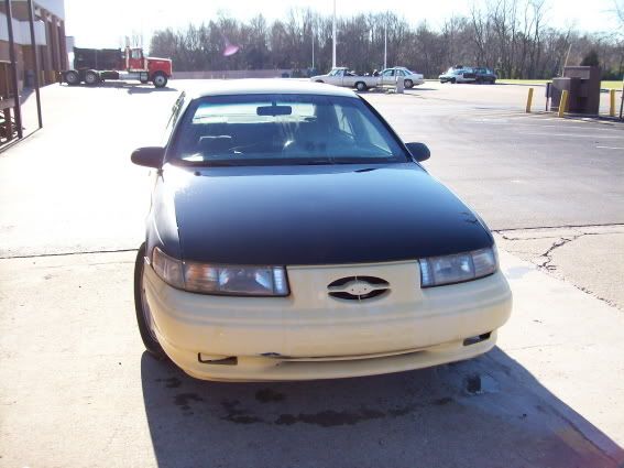

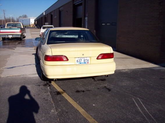

MusPuppis Posted November 23, 2006 Author Share Posted November 23, 2006 More shots of the SHO now that its 'done'. Its 100% finished up and if I had paint, it would be in it now, lol. I'm gonna seal it Monday, just so its all one color, but its not exactly required, ha. Its also now officially up for sale.. 1500$..(1700$ with cd player and my TR mids, ha) Any takers? It'll be in sealer before the buyer pics it up. Im gonna make a proper post here and a few other places soon, but I need to get the interior and engine bay cleaned and detailed before-hand so I can get a whole assortment of pics. The one shot of the front of the car is a bit unfair, ha. The hood was still wet so it was shiny, its overly flattering, lol. The actual color is the same black you see on the doors. Urethane primer thats been wet-sanded, so its a flat color. I know you all dig my super-duper two tone eh? CUSTOM! Ha. Spoiler isnt on in the pics but its finished as well and installed now. Quote Link to comment Share on other sites More sharing options...
rags Posted November 24, 2006 Share Posted November 24, 2006 Car looks great man! Are you getting sick of hearing me say that yet? Maybe another payment for painting the black pearl would get you the paint for the SHO? Black huh? If I get the GN down there your gonna be sick of painting cars black! See ya in a couple of weeks, Mus. Joe Quote Link to comment Share on other sites More sharing options...
