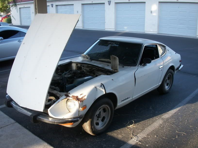

its just food for thought now. i would love to get a quick z going but right now im still trying to bring her back from the grave.

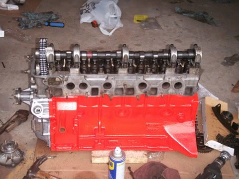

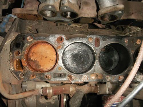

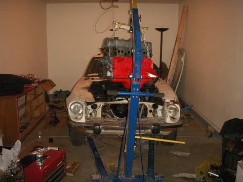

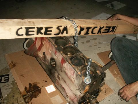

i appreciate all the responses and ill leave you guys with a few pics...
droogie
(im cheap...17 bucks on a chain and 4*4 beats 200 for a cherry picker)
