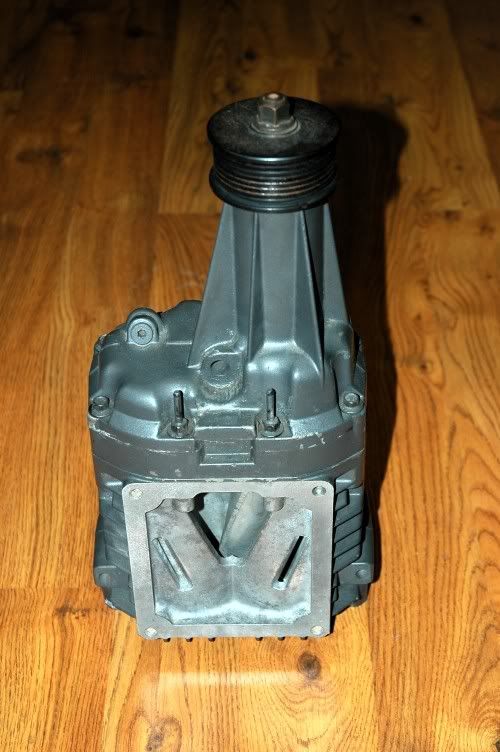

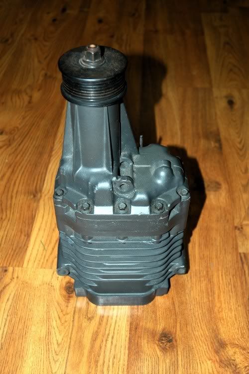

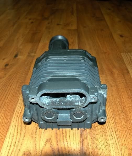

Administrators RTz Posted January 10, 2007 Administrators Share Posted January 10, 2007 I'm going to try to mount a M90 from a pontiac GTP where the alternator goes I considered the same thing... makes intercooling straightforward as well. Here are a few picts of an early Eaton M90 I picked up on ebay for a fair price... . . . . Weighs 21lbs on my atomic bathroom scale. Quote Link to comment Share on other sites More sharing options...
mario_82_ZXT Posted January 11, 2007 Share Posted January 11, 2007 Yea it's heavier then I thought it'd be. Also, mine is made to mount on a v6 manifold, so it's not like yours that you can buy the intake attachment like the thunderbirds have. Also mine has a monster TB on it (it's removal but I'm going to use it). Looks like there's going to be more SC'd Zs running around. Mario Quote Link to comment Share on other sites More sharing options...

mario_82_ZXT Posted January 20, 2007 Share Posted January 20, 2007 Ron, Mine also comes with a vacuum bypass, but also a little electronic valve that controls it. Basically I'm hoping to be able to choose between sensible gas mileage and best performance at a flick of the switch. I need to post pics of the monster because it has more ports than yours that I have no idea what to do with. Mario Quote Link to comment Share on other sites More sharing options...
