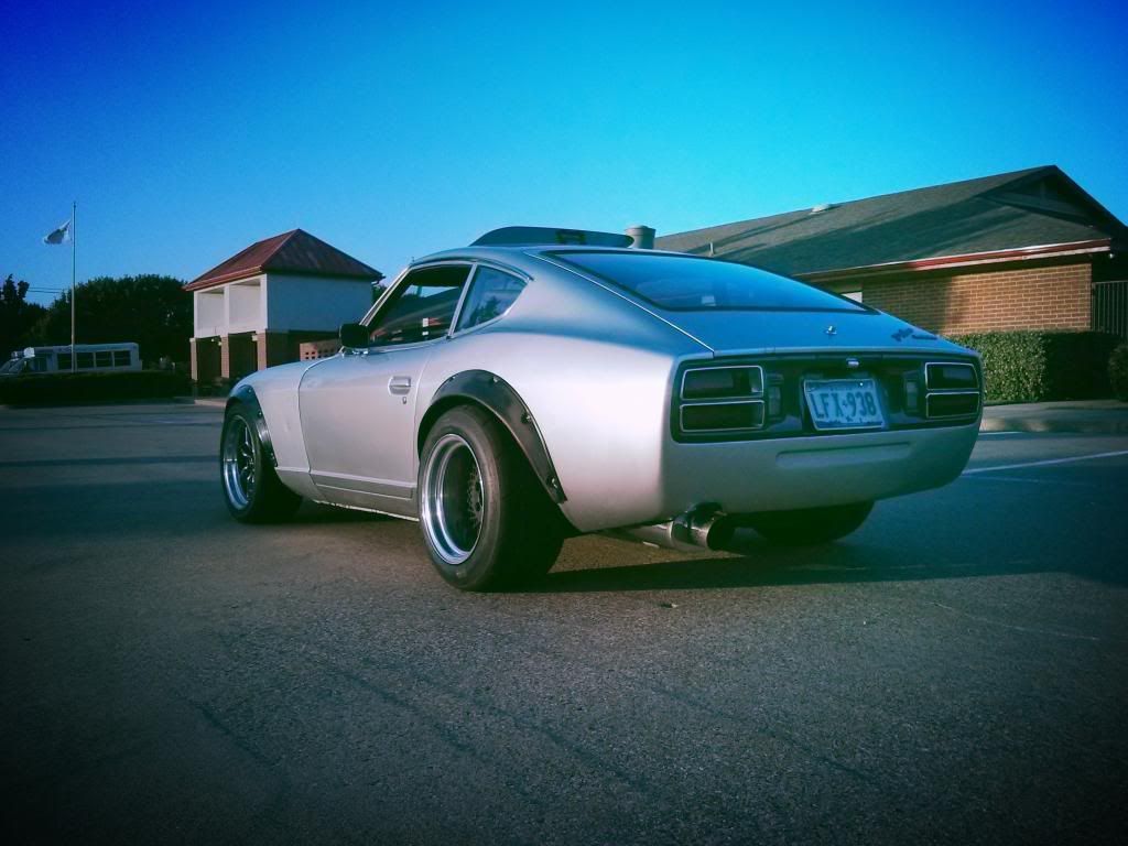

Kevin.pk Posted January 22, 2013 Author Share Posted January 22, 2013 Finished up the passenger side and took a few more pics of the process... Taped off... rough mockup with sheet metal screws holding the flare in place... flare marked off.... quarter panel and inner fender well cut away. nut-serts installed as well. installed nut sert from the back side. Lots of tack welds... didn't take pics of seam sealer/prime and paint.... Done... Quote Link to comment Share on other sites More sharing options...
Leon Posted January 22, 2013 Share Posted January 22, 2013 Damn, that looks fantastic! Quote Link to comment Share on other sites More sharing options...

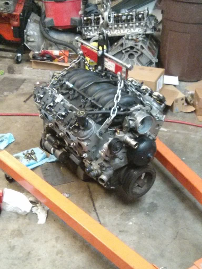

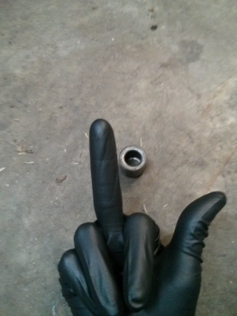

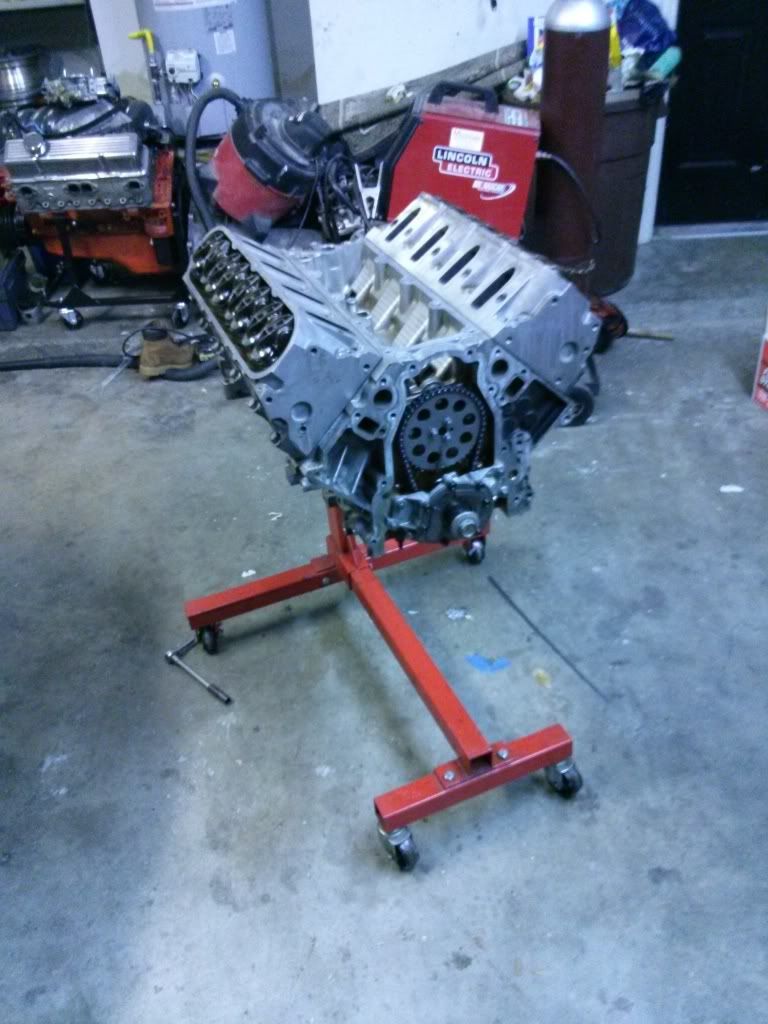

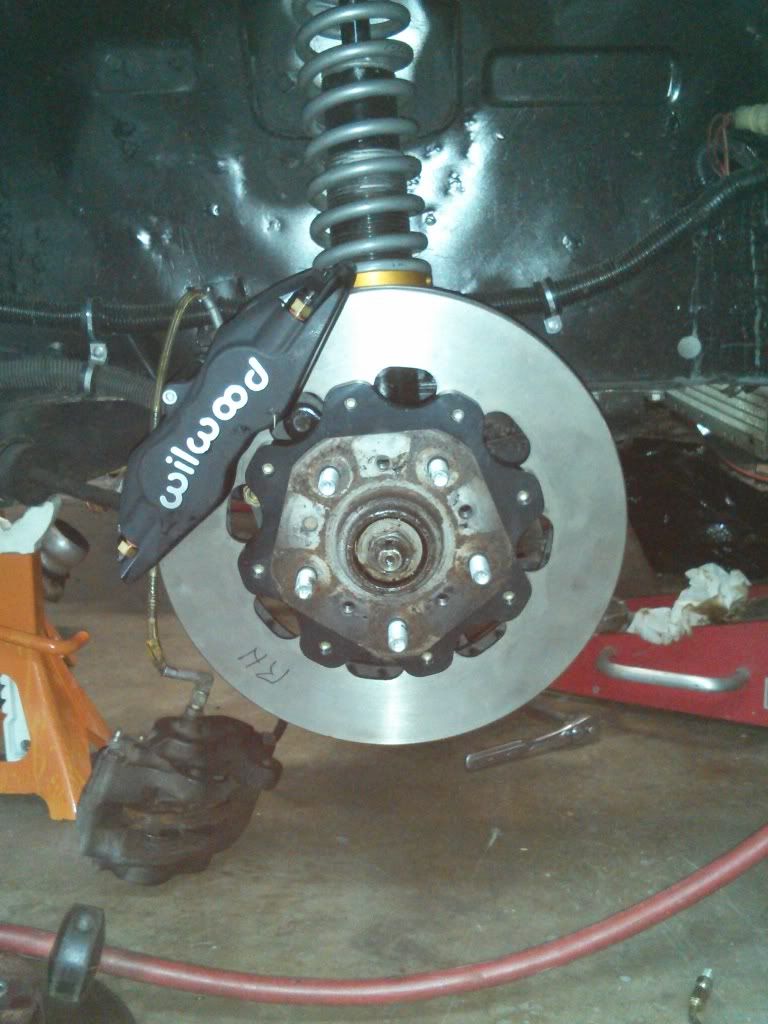

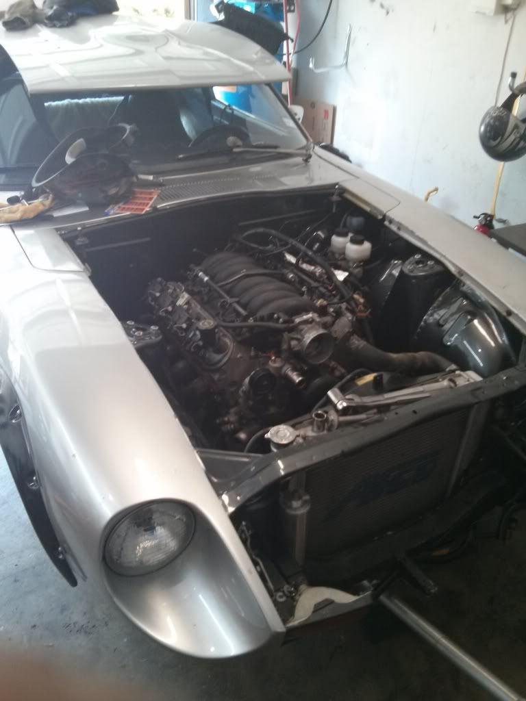

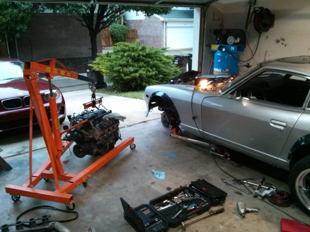

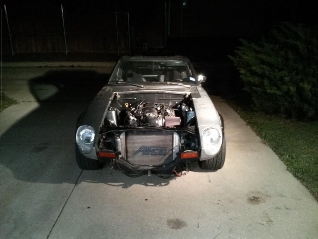

Kevin.pk Posted May 23, 2013 Author Share Posted May 23, 2013 Welp. I spun a couple bearings back in January..... the car sat for a while. I gathered some parts and now its is mostly all back together Picked up a new ls1. Its got a cam with supposedly only 35k miles on the motor. Installed it this past weekend Long block Ready to go in in Vroom. Drove it around the block on sunday ..... lots of vibration through the trans.... crap... pilot bearing was f'ed Got it home... yanked the motor on tuesday... replaced the pilot bearing... no shaft play on the trans...YAY.. put it back together... all is well again. in other news... got a JSk kit for 5 lug hubs from member on here. Still gathering some parts, but this is the rotor and caliper mocked up. Quote Link to comment Share on other sites More sharing options...

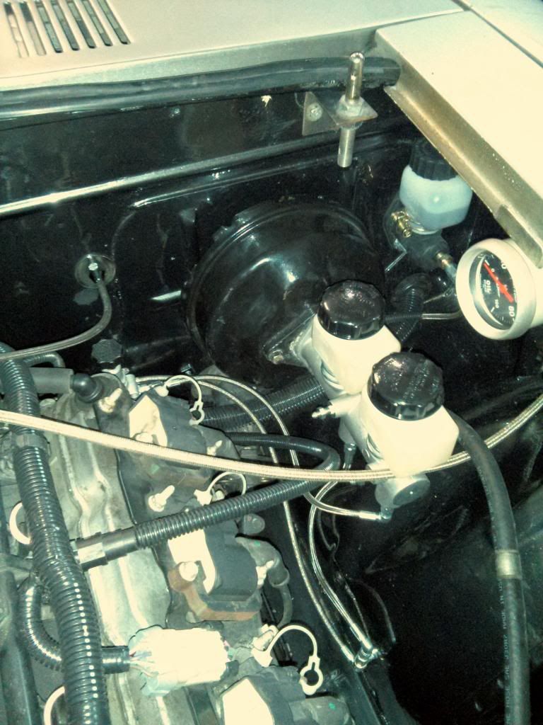

Kevin.pk Posted June 11, 2013 Author Share Posted June 11, 2013 Wilwood setup completely installed. Crappy pic, but shows new 1" Wilwood master cylinder and All stainless braided lines coming off the master and just the top of my proportioning valve along the firewall. Bulkhead "tee" connector through fender wheel to front left wheel. Also a pic of temporary location for Oil pressure gauge. Mechanical gauge, need to get a bulkhead connector route it back into the dash. Quote Link to comment Share on other sites More sharing options...

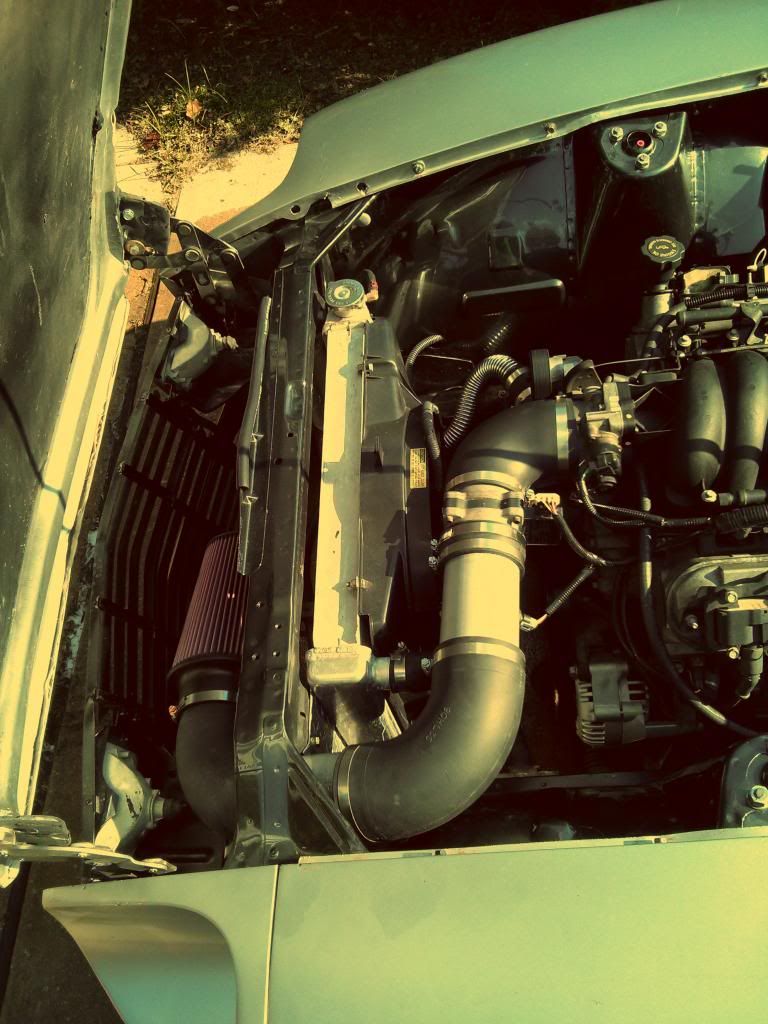

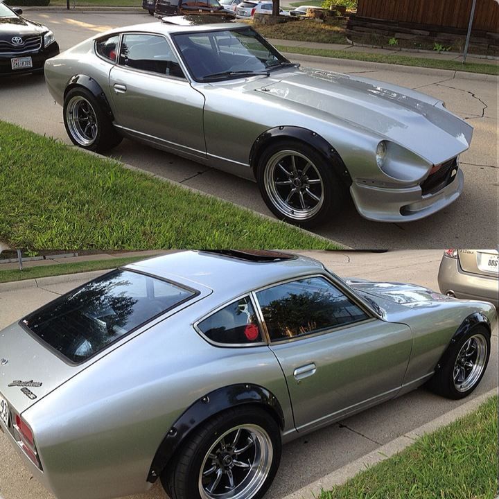

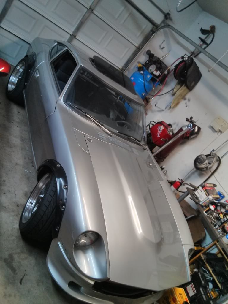

Kevin.pk Posted June 28, 2013 Author Share Posted June 28, 2013 (edited) Finally bought a new filter and mounted it out in front of the radiator. Also went and got the car inspected today. The guy who was inspecting it was a bit perplexed when he wen to check the mileage.... no speedometer or odometer... so he put that the car has 5 miles lol... I have a new speedometer coming tomorrow. Couple Random pics of the car... Edited June 28, 2013 by 280zcar Quote Link to comment Share on other sites More sharing options...

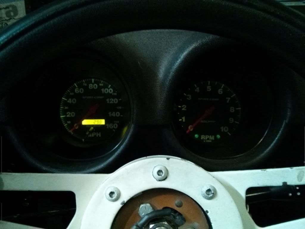

Kevin.pk Posted July 3, 2013 Author Share Posted July 3, 2013 I hate your guts for not answering my question, but I love every update you do. I love seeing the transformation of this car and the awesome work you do to it. Now if I could just save more money! Thanks, sorry for not answering before. I didn't do much with the old SBC in terms racing. I took it to the 1/8 mile one time and ran a 8.3 with a 2.1 60 ft. It had quite a bit left in it. Hopefully will be able to get a comparison pretty soon with the ls motor. Installed autometer speedometer in the stock gauge pod just like the tach that I already had. Quote Link to comment Share on other sites More sharing options...

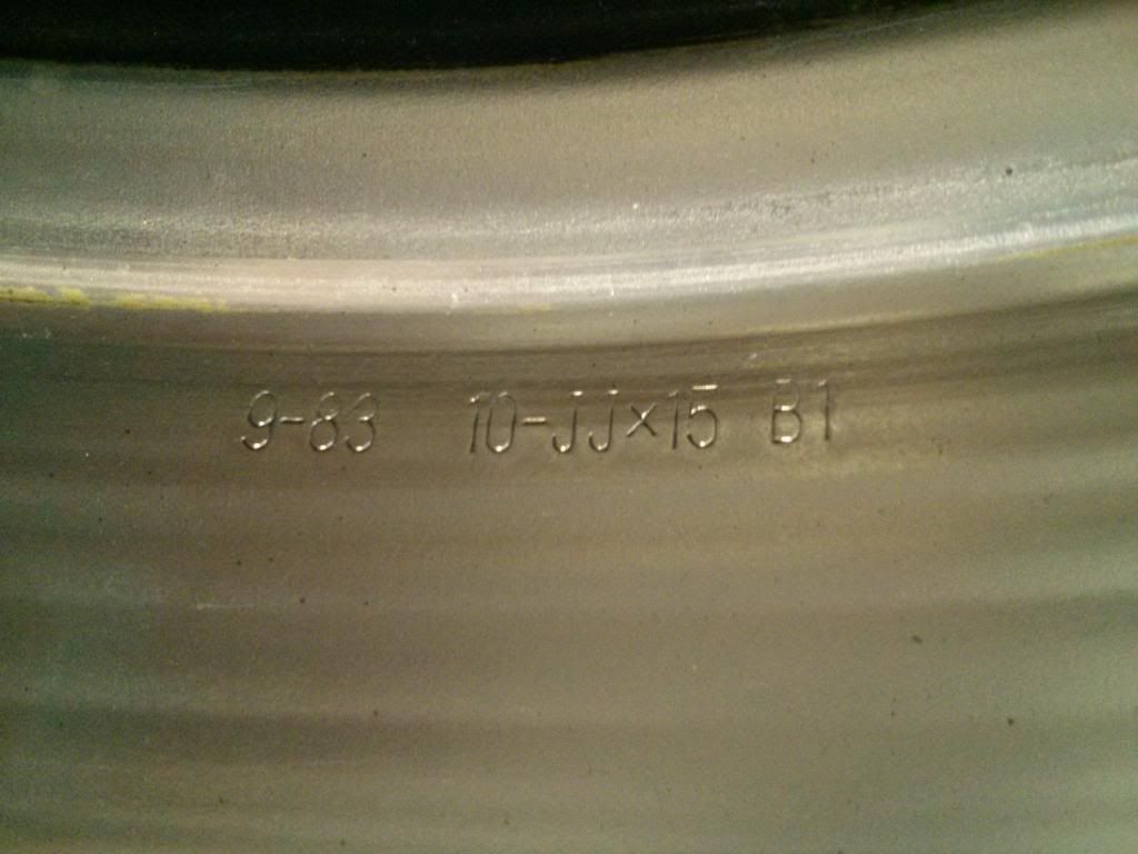

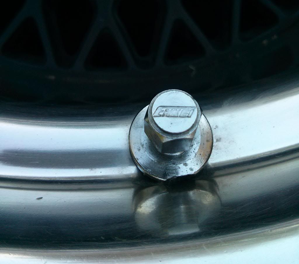

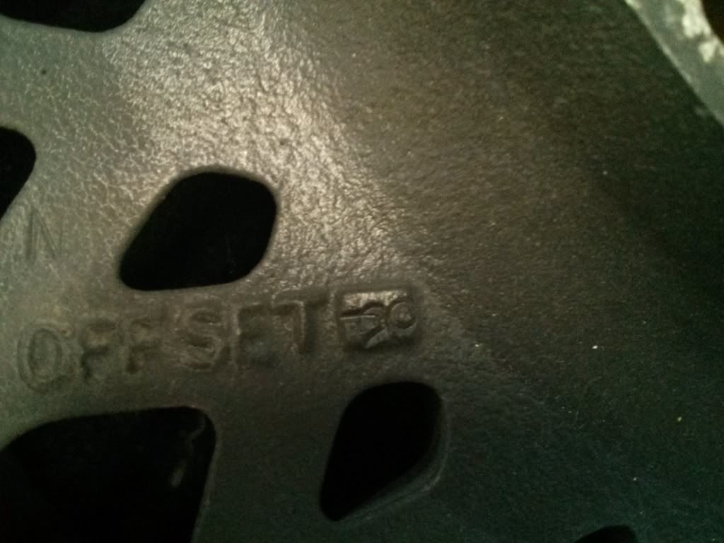

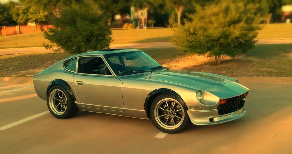

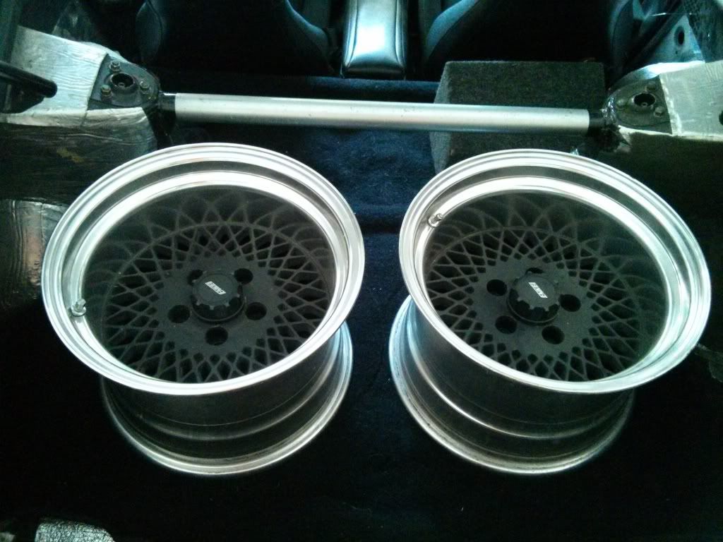

Kevin.pk Posted July 28, 2013 Author Share Posted July 28, 2013 Haven't done much with the car other than drive it lately. Took it up to Oklahoma to visit a friend one weekend and it drove wonderfully. I've put 600 miles on the car since the speedo install. Picked up some wheels. Not exactly sure what I am going to do with them, but the price was right. 15x10 -29 enkei 92s The guy had these just sitting in storage for 17 years. One thing that was kind of neat is the valve stem caps even have Enkei on them. They were originally gold, but were painted over. I may just end up selling them, or throw something sticky on them. Quote Link to comment Share on other sites More sharing options...

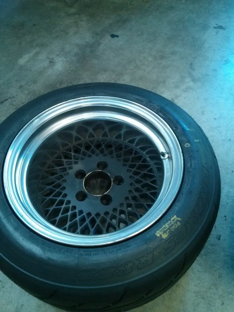

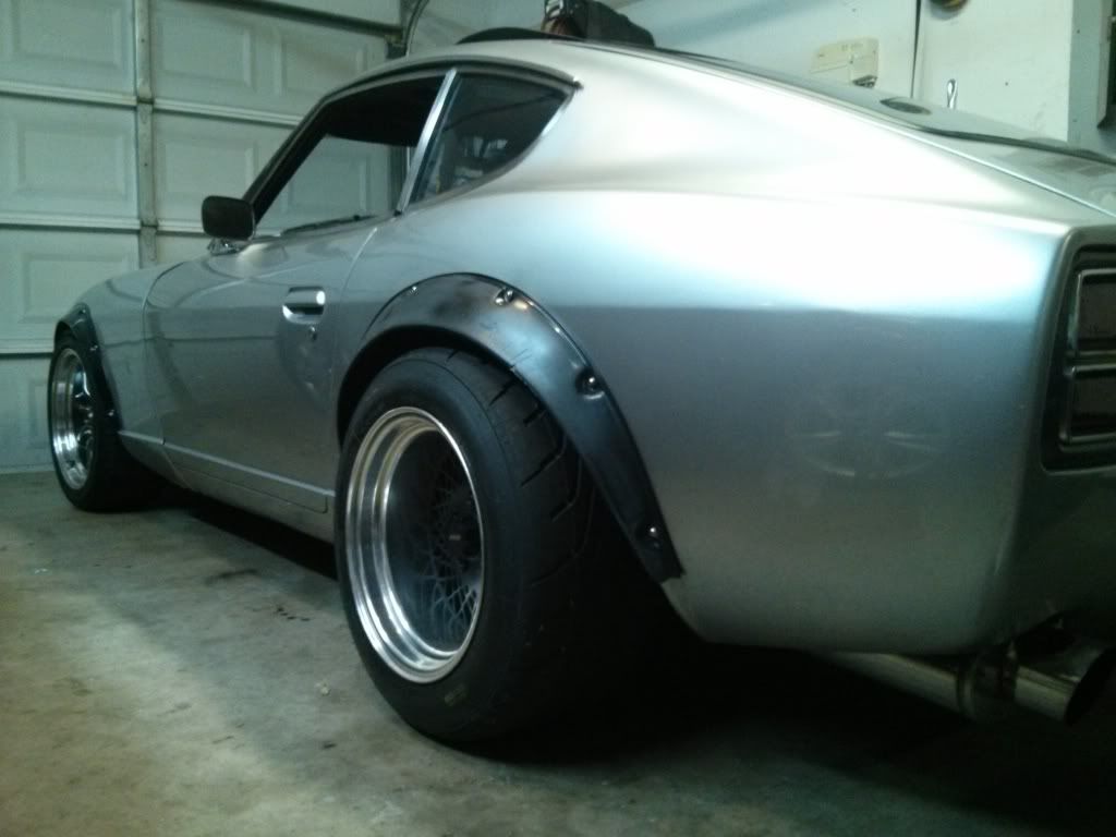

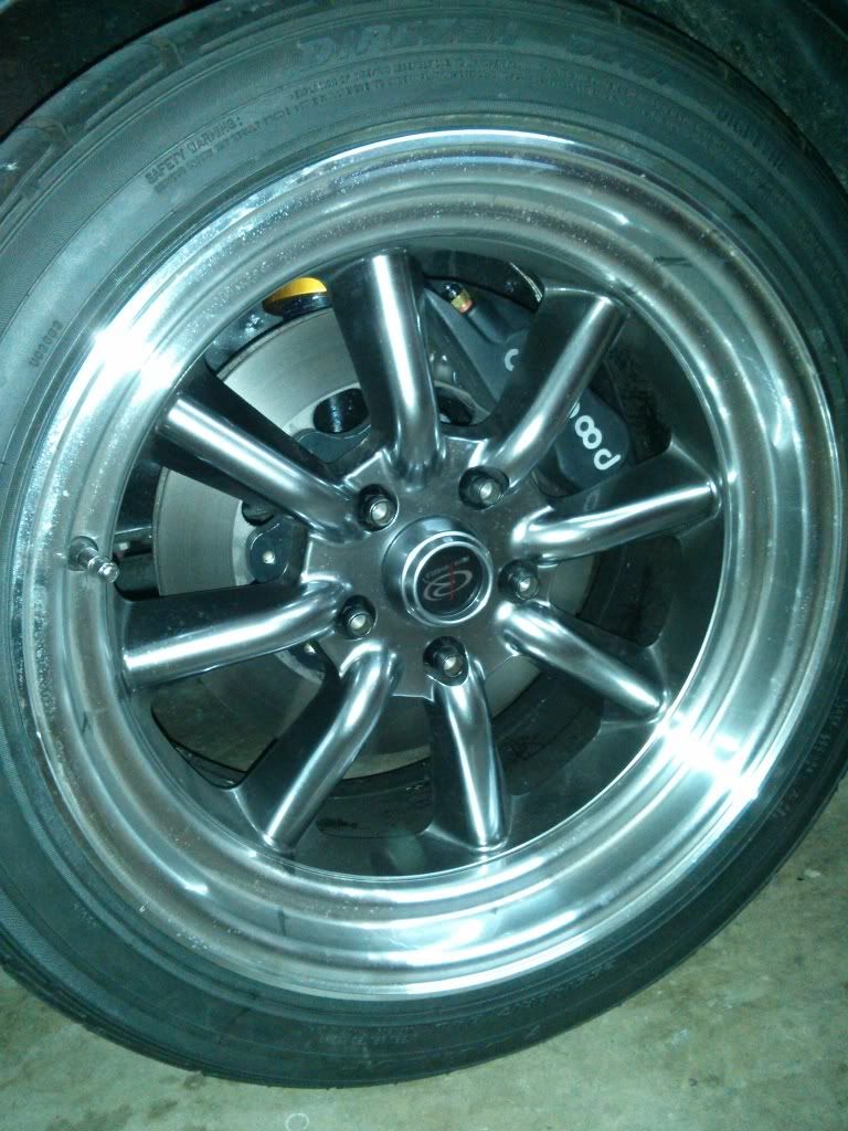

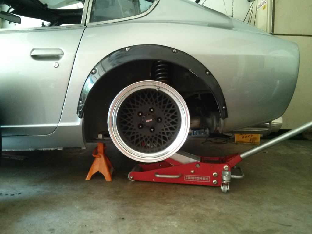

Kevin.pk Posted August 7, 2013 Author Share Posted August 7, 2013 Well, decided to stick with the wheels for a bit. Got tires mounted. 235/50/r15 Toyo Proxes r888 They are quite a bit shorter in overall diameter than my regular street tires. If I wanted to go any lower I would need to redo the back section of my exhaust. Need to track down some wheels for the front now. Quote Link to comment Share on other sites More sharing options...

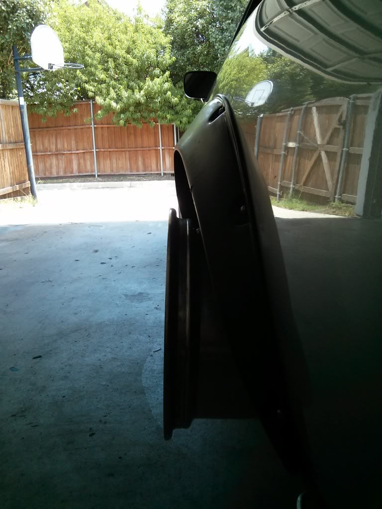

ol doc gully Posted August 27, 2013 Share Posted August 27, 2013 Oh man, great setup! How much room do you have to the spring coil with those rims/tires? I've been wondering if I can fit 235/50 R888s on stock fenders with a 15x9 and as much backspace as possible -- any thoughts? Quote Link to comment Share on other sites More sharing options...
Kevin.pk Posted October 2, 2013 Author Share Posted October 2, 2013 That size may fit, the R888s run fairly wide. Wheel is maybe a little more than an inch from the strut tube Had some spare time and some scrap metal.... So.... Made a front strut brace. The mount still need some final trimming and welding but its mostly finished. Still debating on whether to tie it back to the firewall, but I realize that is what will provide the most strength. Quote Link to comment Share on other sites More sharing options...
