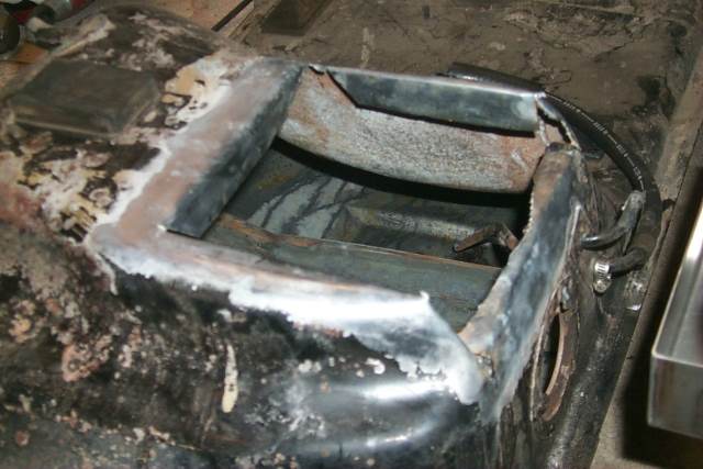

I gave my tank to a radiator shop to build me a wall or baffle around the pickup and they've cut my tank open and called me to tell me that there is already one in there!
Here are the pics..
Pic1
Pic2
Pic3
I new there was some kind of baffle in a 240 tank but not such a large one. Can anyone give me some advice to pass on to them as they dont know what else they can do really... :roll:

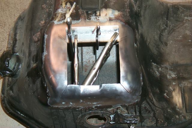

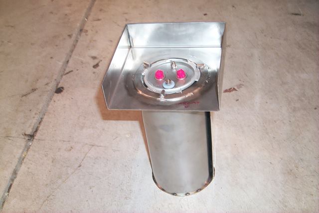

I ended up going to an intank sump - but not the kind that hangs down below the tank. I think that's unsightly and doesn't really fix the problem for EFI that well. I had Rock Valley Antique Auto Parts make me a correct height "Tuned Port Injection Sump Kit" http://www.rockvalleyantiqueautoparts.com/catalog/tune_port_info_and_kits.pdf
Here it is:
Note the vertical "slit" in the side of the "can" it's how fuel gets into the sump and out. They assured me this system has been tested on many vehicles and works well to keep the fuel in the sump. Since the fuel returns to the sump, I can imagine why. One concern is heated fuel returning to the sump and warming the fuel in the sump first. Tradeoff I suppose. Do you want no fuel or warm fuel?

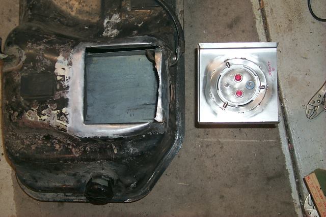

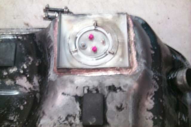

I cut a rectangular hole in the top of the tank for it, and mounted in the front-ish area of the tank.
tanksumpbrazed
(sorry about the out-of-focus photo!)
I used various fittings and 1/2" aluminum hard line from the outlet fitting (red plug in it) and fittings and 3/8" steel hard line from the return fitting. These lines run down in front of the tank and are secured to the now brazed shut stock supply and return lines on the front of the tank. From there I connected my existing return and supply hoses to my in line pump. I had the car at the body shop getting the rear end damage fixed, so this was a quick fix to just replace the tank with this one. I also sealed off all of the vent pipes on the tank. I will go back and put an intank pump in the place it was provided on the insert that goes into the sump when I move back to EFI.
This made the stock sender not fit. I bent the arm for the sender around the sump, but it fluctuates wildly as I go around corners. A better solution would be to get one of their fuel sending units and install it in the top of the tank. I may go back and do that. While I did have the system running on the car, but using a piece of hose in place of the in-tank pump, I had no problems with my TBI setup gasping for fuel while going around corners hard even with 1/4 tank, like I used to have even with 1/2 tank or more with just the stock tank pickup.
I'm very satisfied with this setup, other than the fuel sending unit, which I may rectify with one of their units and stiffening plates into the top of the tank at a later date.
