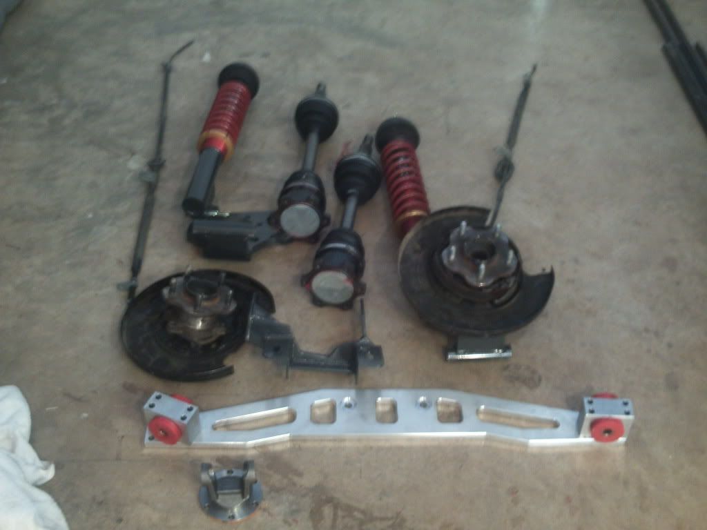

stony Posted June 21, 2008 Share Posted June 21, 2008 What is invested in this picture??? Link to comment Share on other sites More sharing options...
Bowtiez Posted June 21, 2008 Share Posted June 21, 2008 $2544 if you include the used TT R230 not show. Backing Plates $550 Moustache bar $250 Front Diff Mount $150 Axles $480 Struts prepped for coilovers $240 Coilovers for rear strut casings $199 Shocks for rear strut casings $240 Nissan TT/Chevy 1310 Yoke - $85 Used Hubs, Axles, R230 Diff, backing plates less brakes - $300 Moser Installed Axles (FREE-Shipping to Cal $50.) Link to comment Share on other sites More sharing options...
