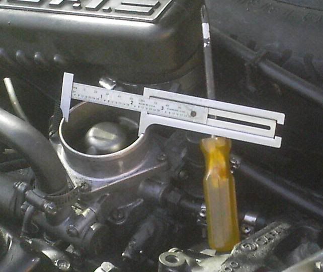

Daeron Posted October 29, 2007 Share Posted October 29, 2007 I can't see any reason, other than the "stealth" desire, to go for the SU body. Try the TB from an SPFI 80s Subaru: times two. You might need to upgrade the injector in the TB, and I know nothing about possibilities for that, but I don't know... i cannot recall the flow rate on the injector at the moment. I had honestly come across the idea for doing the exact setup Z-ya has done, when he did, FROM having thought and spoken extensively with my uncle, about making a setup for one of his roadsters, using MS, SU manifold, and two subaru throttle bodies. If not the subaru piece, then find one thats more appropriate; there are thousands of TBI cars in the junkyard. Quote Link to comment Share on other sites More sharing options...
TABrinn Posted October 29, 2007 Share Posted October 29, 2007 I can't see any reason, other than the "stealth" desire, to go for the SU body. The biggest reason being that it fits with no modification, and I wouldn't need to fabricate any linkage. Besides just from looking I'd say a hollowed out SU would flow more than that Subaru TB with that big obstruction stuck in its throat. What is that, a MAF sensor? You could do better. Quote Link to comment Share on other sites More sharing options...
Administrators RTz Posted October 29, 2007 Administrators Share Posted October 29, 2007 Try the TB from an SPFI 80s Subaru: A couple of day's ago I was combing a JY and spotted the same thing. What detracted me from it was the throttle size. I didn't measure it but it struck me as quite small. Quote Link to comment Share on other sites More sharing options...
Daeron Posted October 29, 2007 Share Posted October 29, 2007 The biggest reason being that it fits with no modification, and I wouldn't need to fabricate any linkage. Besides just from looking I'd say a hollowed out SU would flow more than that Subaru TB with that big obstruction stuck in its throat. What is that, a MAF sensor? You could do better. It is the fuel injector. A couple of day's ago I was combing a JY and spotted the same thing. What detracted me from it was the throttle size. I didn't measure it but it struck me as quite small. Well, after posting last night I dug out my FSM and couldn't find a throttle diameter or injector flow rate, but just now I stepped out front and measured it. 60mm opening. It tapers down at the actual throttle plate to something like 40-45, and thats being conservative. Times two, even with the restriction caused by the schnozzle for the injector, I think should be ample, certainly for a roadster (maybe a turbo roadster??) and possibly, use roadster SU manifolds on a Z to use three??? Potentiometer-style TPS fitted, IAC fitted, cable throttle drum...... it wouldn't be difficult to drill up some holes. I will have to look further into the size and shape of the footprint, but... Overall, my point was that through some simple junkyard picking, ideal throttle bodies would probably start to fall in your lap. Quote Link to comment Share on other sites More sharing options...
Administrators RTz Posted October 29, 2007 Administrators Share Posted October 29, 2007 It tapers down at the actual throttle plate to something like 40-45, and thats being conservative. Hmm.... well, I could be mistaken. I'll check next time I'm out there. That's an EA82 you're looking at correct? Times two Its not that simple. Only one intake valve is open at any given time, so separating the cylinders into two banks and using two TB's, doesn't change much. Adding six, one per cylinder, gains you little. Also, even if the throttle is 45mm, an L28 intake valve is 44mm. While the valve doesn't open completely, and has a stem, don't dismiss the throttle shaft/screws. Its quite restrictive. My point is, even at 45mm its cutting things a little close, in my opinion. I'd like to see about 15-20% more flow through the throttle than the valve. Thats a reasonable compromise between 'enough' and 'too much'. Overall, my point was that through some simple junkyard picking, ideal throttle bodies would probably start to fall in your lap. Point taken... and its a good one at that. Some of the best ideas have sprouted from the JY. Quote Link to comment Share on other sites More sharing options...
