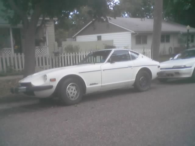

tech9 Posted August 6, 2007 Share Posted August 6, 2007 I thought I would make this interesting and have a few pictures showing the progress on my car. I will update it as progress happens. Here is the car on the street right before I bought it. It didn't look too nice, but was defiantly worth it. Ended up tearing apart the motor, changing the head gasket, cleaning up the emissions, etc. Finally got it running.... Decided to try the rustoleum paint job. Didn't find too many surprises while sanding, normal bondo here and there. Quote Link to comment Share on other sites More sharing options...
