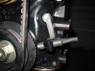

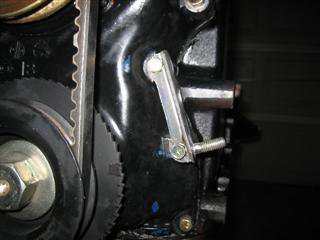

fp280z Posted February 13, 2008 Share Posted February 13, 2008 I found your thread and the same lack of information about the XDI on this forum as well. That's fine, just means very few have really been there yet. I think most Z folks are Megasquirt users by nature. That's cool, but all I wanted was spark since I'm running carbs. Anyway, I'll try to post my findings with the XDI system to hopefully help others like you. There may be 1 or 2 more out there. The motor I bought for my car had the Electromotive trigger wheel already installed and the distributor port already plugged so I decided to try out the crank trigger thing. I bought the XDI box from Steve at TEP since he had the best price on the XDI, DFU, and sensor package. The only thing missing at that point was the crank trigger sensor mount. I bought an aluminum Porsche crank trigger mount off of eBay and fabricated the attachment to the front cover. I had to add a layer of heat shrink to the sensor so it would be snug in the Porsche mount. Some pics are attached. For more info and bigger pics check out my website: http://www.typeischeap.com/new.html As you can see from my webpage, I',ve mounted the box, coils, and sensor but haven't wired everything up yet. That's planned for this weekend. Hope that helps. Let me know if you have any other questions. -Rick Quote Link to comment Share on other sites More sharing options...

JMortensen Posted February 14, 2008 Share Posted February 14, 2008 If the pics from Rick show the mounts for the crank trigger that TEP sells, I'd be hesitant to buy it from him. I haven't used XDI, but my friend did. He had a machinist make up a super cool looking bracket that looked similar to that one and when he got up to about 8000 rpm (L18) the bracket vibrated enough that the sensor hit the trigger wheel killing it instantly, right in the middle of an autox run. Then he made his own bracket from 3/8 plate aluminum that bolts to the driver's side of the block (what is that the AC compressor mount) and hasn't had any trouble since. I also saw Vic Sias kill his trigger on his street car at an autox once, same deal. The flexible mount vibrated at high rpms. When it comes to crank triggers, go overkill on the mount is my advice. Quote Link to comment Share on other sites More sharing options...
fp280z Posted February 14, 2008 Share Posted February 14, 2008 Good info, Jon. This bracket is one that I made myself, not the TEP bracket but it is similar. I'll keep an eye out for vibration issues and redesign if necessary. -Rick Quote Link to comment Share on other sites More sharing options...
