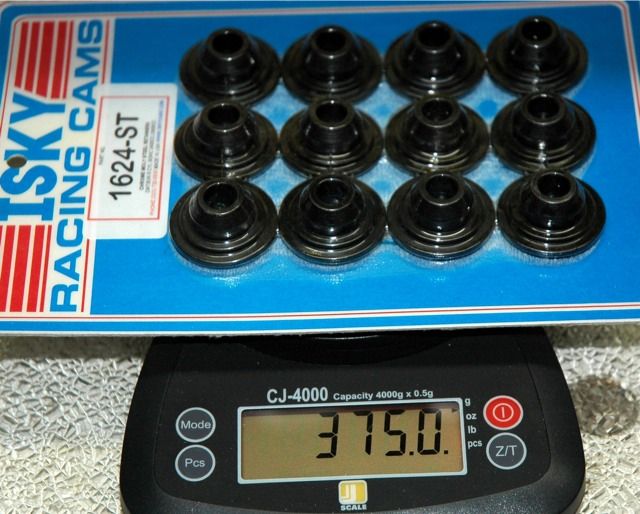

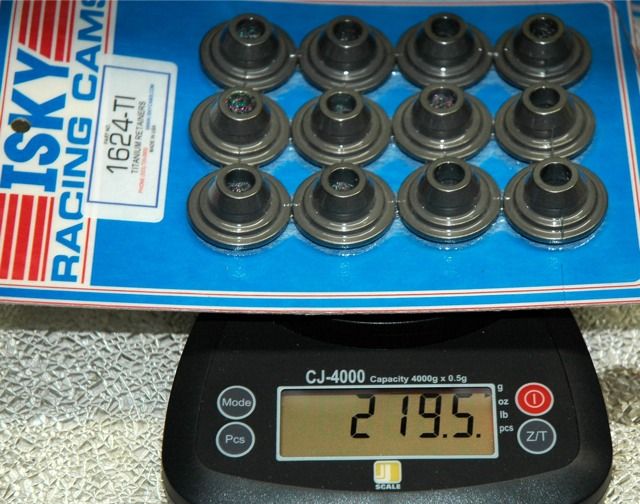

Administrators BRAAP Posted December 29, 2009 Administrators Share Posted December 29, 2009 Just finishing up 3 custom L-series road race cylinder heads, all three receiving new Isky springs and retainers. 2 received the titanium retainers, the other steel. Thought you all might be interested in a weight comparison of Isky's Steel vs Titanium retainers, gives a good perspective as to what that extra expense in titanium retainers is actually getting you in weight savings at the valve. Almost a 60% weight savings in retainer weight, (assuming the packaging weight is similar of course). Isky Steel; Isky Titanium; Link to comment Share on other sites More sharing options...
