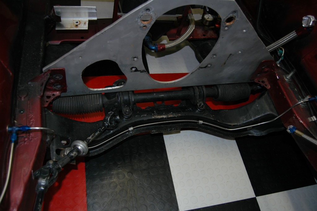

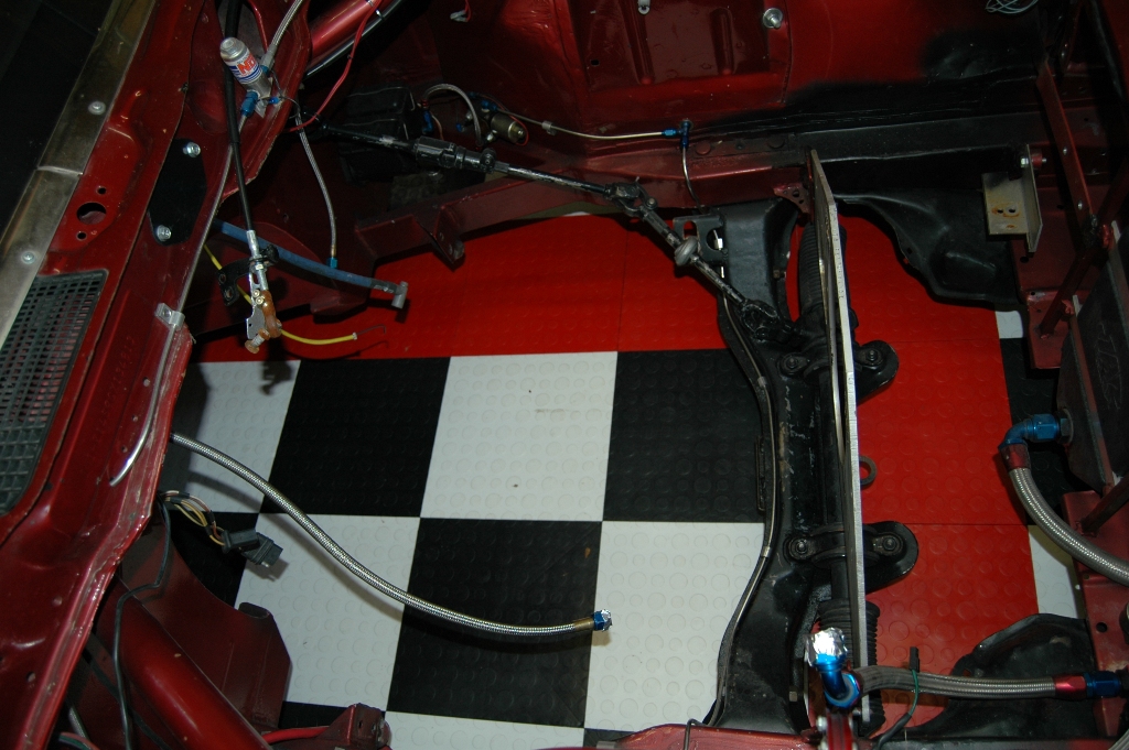

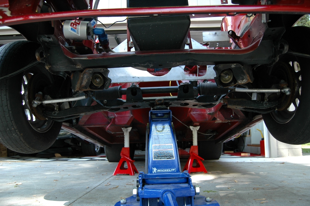

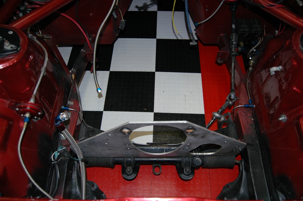

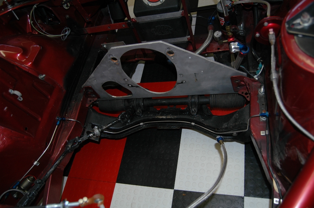

DLC Posted April 30, 2008 Share Posted April 30, 2008 Here are some pics of the rack. Let me know if you need anything else. Quote Link to comment Share on other sites More sharing options...

DLC Posted April 30, 2008 Share Posted April 30, 2008 zcarnut said: I'm a little confused here(?). I thought that the Z31 has its steering rack behind the front axle. Beats me! Sure looks like it should be from the picture you posted. This is how the car was when I bought it. This is my first Z car and I was only trying to help. As you can see, it is not your typical 300ZX. Here's another picture: Quote Link to comment Share on other sites More sharing options...
kenny_b Posted May 3, 2008 Author Share Posted May 3, 2008 Boohoooo! *whine* I don't know how, but mine is completely different. Looks like someone has taken pretty much the whole front axle and turned it around, including the axle-pivots and knuckles and brakes... Sure looks very nice and it is a genious idea - only that I already welded the motor mounts onto the axle and don't want to tear it all apart again. Bummer. Thanks very much anyway. This is definitely a great alternative in case I won't find anything else Quote Link to comment Share on other sites More sharing options...
