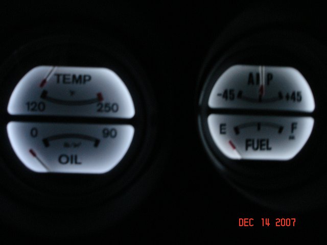

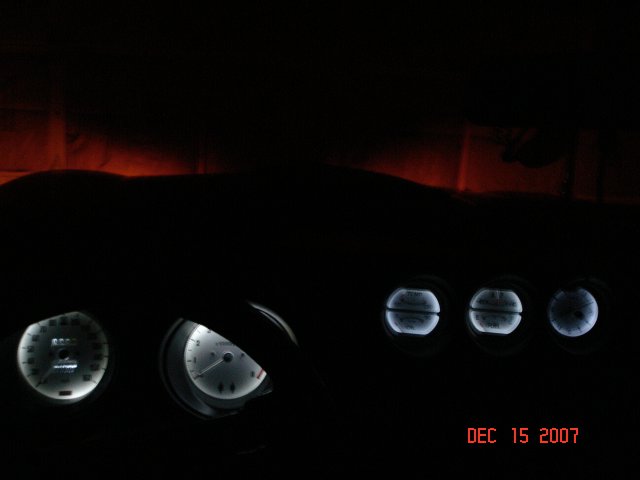

The pics tell the rest. I also threw in a pic of the new white face gauges I just put in.

Where did you get those gauges? They look stock, only, of course, white.
Here's a forum on the whole gaguge refacing I did. http://www.classiczcars.com/forums/showthread.php?t=28936
White face gauge kit from MSA, http://superbriteleds.com BA9s White Wide Angle bayonet bulbs in each gauge, My parking light relay upgrade (see signiture for more info) Painted the back of each face plate chrome.
Also painted the other internals silver to cover the old white color.
