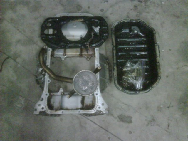

  8. Im no expert but i have swapped this engine in my car and got it running well enough to daily it. So to answer your question to get the 1uz from the ls400 to work in the 240z you will need to convert it to a rear sump from a lexus sc400. The ls400 sump sits to far forward and will sit on the steering rack. As far as i know there are no conversion kits just go to a junkyard( auto recycler) and see if they have a sc400 to pull parts from. you will need the these parts.(see picture source:clublexus) I am doing this very thing i snapped a rod on my boosted 1uz setup and had to get a new engine best one i could find was from a ls400 so i have to swap everything over to fit. I am using the stock ecu with a apexi neo for fuel control(turbo setup), i bypassed the neutral safety switch for the auto and i run a toyota r154 transmission. No immobilizer on my setup. i also got a pre 1995 engine as they have stronger rods(better for boost) and are non interference(better for when i break things lol). Im not on here much but i hope this helps in some way.

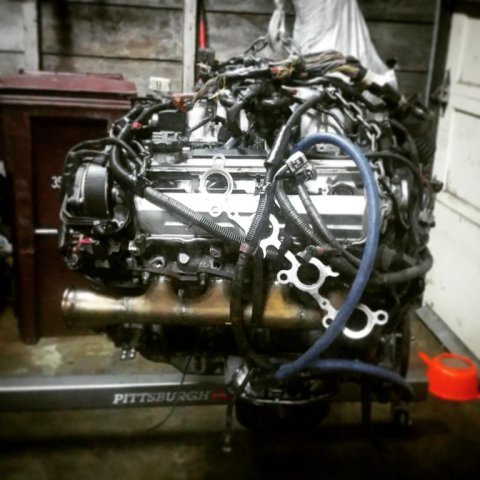

  11. I know there are 1uz swaps out there. My question is are there any other turbo 1uz 240z's.
  12. Almost finished with this project and wanted to see were there any other documented 240z specific 1uz turbo swaps out there. I can't seem to find anything would be dope if I were the first 240z specfic. This isn't a show car and never will be so any of you who don't like, gtfo. No specfic plans for the car other than learning more of what I don't know while having fun and making good power without spending ludicrous amounts of money. Sorry for the sideways picture, anyone on instgram feel free to add me for more pictures and videos I will post more here once I get home. IG 510s30kees

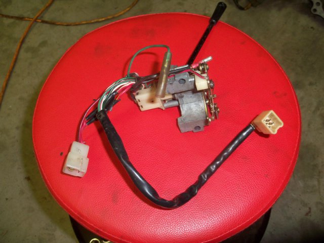

  14. Looking to find out what the green wire is in this photo is it a ground or need 12v? I can't find where it goes to the dash harness. Thanks
