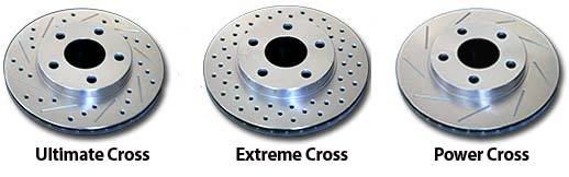

Guest ladyz Posted December 2, 2007 Share Posted December 2, 2007 i might be picking a set of these rotors for my z. but i have a quick question... would it be a good idea to mix match them or would it be better and safer to use all 4 same designs? i was thinking about getting the power cross for my front and Stream Cross for my rears.. any suggestions? Thanks -Mark Quote Link to comment Share on other sites More sharing options...

JMortensen Posted December 2, 2007 Share Posted December 2, 2007 bjhines said: But they do nothing for your braking performance on the street or track. In fact they will make humming noises when you come to a hard stop because of the pretty little partterns on them. Cross drilling reduces weight but hurts the ability of the rotor to absorb heat. Reducing weight will improve braking performance. Cross drilled solid rotors, especially in the rear of a Z, do indeed make a whirring or buzzing noise as the air expands in the hole but is trapped by the brake pad and then is released when the rotor turns. It never really bothered me when I ran them. I actually thought it was kind of cool sounding. Like a baseball card in your spokes for grownups.... Slotting supposedly provides a path for gases to escape between the rotor and the pad. I haven't used them myself but I know lots of people who have and you see them on race cars on TV all the time. It seems like pro racer types wouldn't use them if they did nothing... I think both do something. The question is do you want or need them to do the something that they do? If you have stock rotors you probably don't want to cross drill them, although if you're racing you might want them slotted. If you have vented rotors you probably don't need either, although if you have huge 13" brakes on a 2300 lb car you could probably justify cross drilling to reduce the effect of the heavier rotor and reduce the mass out at the end of the rotating lever which is the rotor. For 99% of people, they buy them for style and drive around on the street thinking it looks cool. If you're one of those, get whichever style tickles your fancy. If you want different front and rear it won't make the slightest bit of difference. Quote Link to comment Share on other sites More sharing options...

Guest ladyz Posted December 3, 2007 Share Posted December 3, 2007 cool thanks for the help everyone. yeah the z is my daily driver im not going to be doing track or anything. i am going to replace all 4 of my rotors. i think im definately going to get the power cross in the fronts and stream cross in my rears. have to email the guy tomorrow. Thanks! once i get them in i'll post some images and how they perform on my z... anyone know how to break in rotors on a fresh install with new pads? thanks! -Mark Quote Link to comment Share on other sites More sharing options...

MrFancypants Posted December 3, 2007 Share Posted December 3, 2007 Dude... you have to get the Extreme Cross ones... they go to 11. - Greg - Quote Link to comment Share on other sites More sharing options...

Pop N Wood Posted December 4, 2007 Share Posted December 4, 2007 If you call they may sell you their cross dress model. They don't list it in their catalog. You have to ask. Quote Link to comment Share on other sites More sharing options...

jerryb Posted December 4, 2007 Share Posted December 4, 2007 Just curious what makes you choose one design for the front and another for the rear. What is the criteria for this decision? Quote Link to comment Share on other sites More sharing options...
LS1 240Z Posted December 4, 2007 Share Posted December 4, 2007 are these suppose to be vented direct replacement rotors.. or what.. Quote Link to comment Share on other sites More sharing options...
Savage42 Posted December 4, 2007 Share Posted December 4, 2007 I talked at length with guys at Brembo and Wilwood about the different designs. Bottom line is that slots are a good thing, as mentioned before, that it lets the hot gas between the pad and rotor escape and helps keep the pad surface clean, helping increase braking and cutting down on brake fade. Cross drilling is only done for looks, as people pay to have them that way, even though they dojn't add anything over slots. In extreme cases, they stress crack around the holes and can cause premature rotor failure. (in their own words) So, I went with the GT slotted rotors with my Wilwood setup and most of the race cars I've driven are only slotted. I've run all my cars hard for over 15 years of autocross, hillclimbs and track days and have had great results with just slotted. Just my .46 cents. Quote Link to comment Share on other sites More sharing options...
