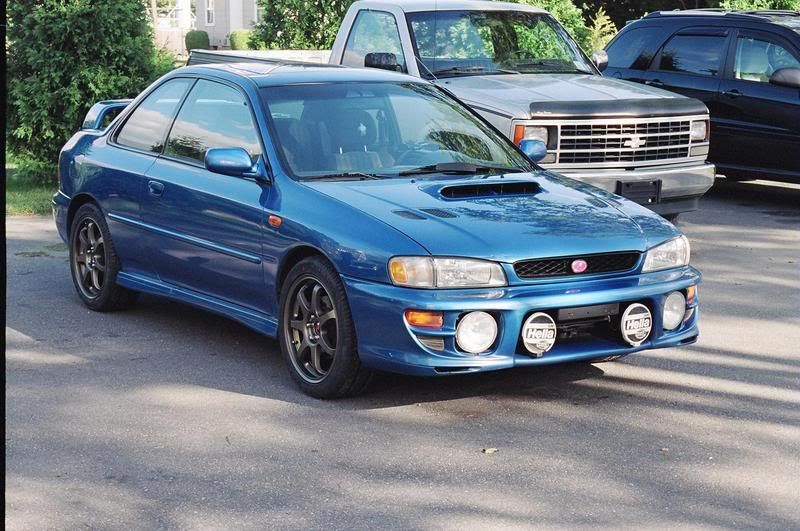

cygnusx1 Posted December 13, 2007 Author Share Posted December 13, 2007 I scraped off the pitting paint with a steel chisel, then I scrubbed them for about 10 minutes each with a scotchbrite pad. I wiped them down with alcohol. I warmed up the wheels and rattle can with a hair dryer because it was cold in the garage. It took just a little over one can to do all four wheels with about three coats of semi-gloss black duplicolor. I didn't even mask off the tires and they look great. Unfortunately, the semi-gloss is more glossy than I would like, and up close you can see the pitting underneath. Not really a big deal. I might buy a can of flat black and go over them again next season. I will post a pic later. We are supposed to get about 10-12" of snow today and I have an hour drive home so the pics might be snowy. Quote Link to comment Share on other sites More sharing options...

cygnusx1 Posted December 13, 2007 Author Share Posted December 13, 2007 My company closed at 12:30 to spare me the bonehead traffic. I took the less travelled route home, enjoyed the snowy landscape, and fed some snow to the Subie. Quote Link to comment Share on other sites More sharing options...
