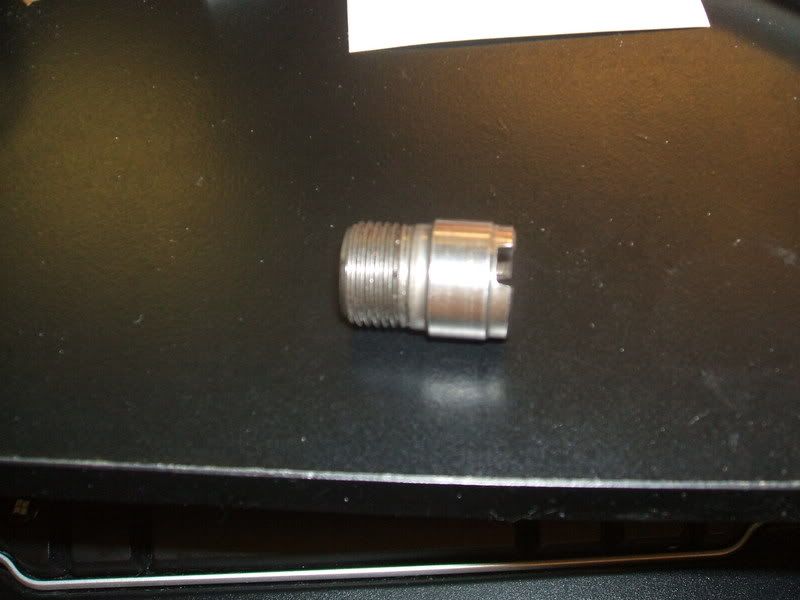

05plsrt-4 Posted January 18, 2008 Share Posted January 18, 2008 I have an RB25DET that I'm trying to install an external oil cooler on. For anyone who has removed the oil cooler on these engines know that where the adapter in the block is, its not threaded. I need it threaded. I removed it from the engine and it has threads on one side (metric something or other) and nothing on the other. I need one that has the metric thread on one side, and 3/4 16unf on the other side I ordered a oil filter adapter from a RB20DET without an oil cooler and it came in the same part as I origionally had. Can anyone help? Quote Link to comment Share on other sites More sharing options...

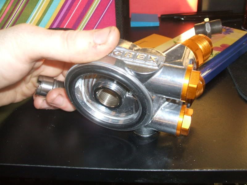

05plsrt-4 Posted January 25, 2008 Author Share Posted January 25, 2008 I'm trying to completly remove the water to oil oil cooler and install a air one up front. The first pic is of the oil cooler adapter I'm planning on using. The second is of the adapter peice that I need. I've talked to a few Nissan dealers now and I've ordered a few different numbers and keep ending up with the same peice (as shown in the pic) So I'm just going to have a machine shop put threads on the unthreaded part of the adapter (second pic) Quote Link to comment Share on other sites More sharing options...

05plsrt-4 Posted January 26, 2008 Author Share Posted January 26, 2008 The part in the second pic is the one I keep getting. I've given them a few different part numbers and they seem to all get superceded to the same part. I'll try ordering the other one and we'll see what happens. Quote Link to comment Share on other sites More sharing options...

05plsrt-4 Posted February 4, 2008 Author Share Posted February 4, 2008 Oil filter spins onto the greddy part I showed in the pic. The greddy part bolts to the block with the adapter I was looking for. Then the oil cooler runs off the an fittings. It completely eliminates the water/oil cooler. Which is what I wanted. Quote Link to comment Share on other sites More sharing options...
