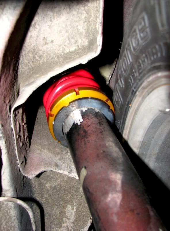

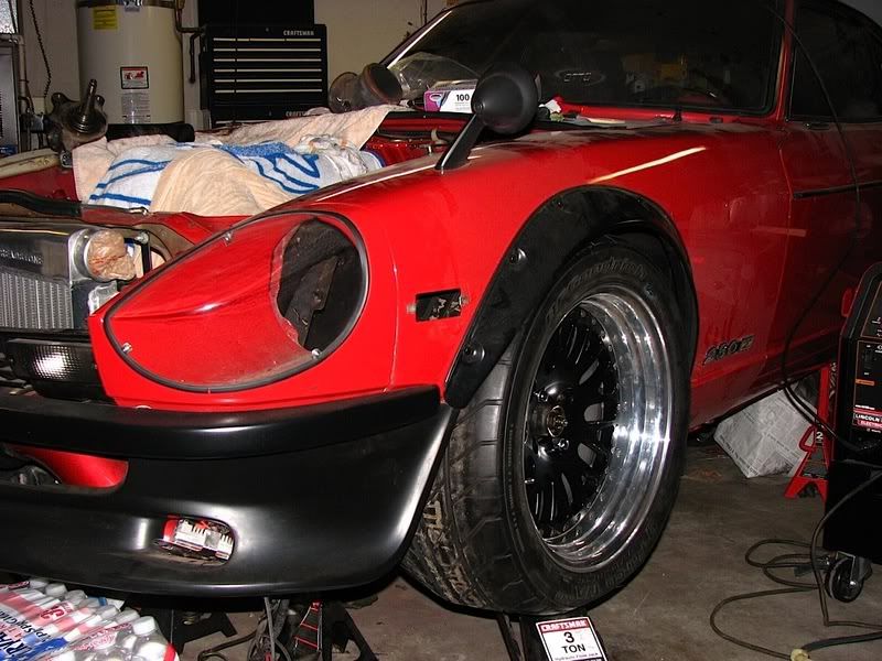

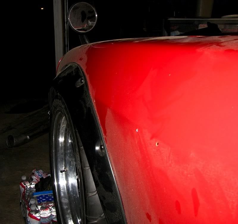

Guest 280ZForce Posted February 1, 2008 Share Posted February 1, 2008 I am looking for some 17x10.5 adn 17x9 wheels for my tt car. I need about a 5 3/4 backspacing on the 10.5 and a 5 on the 9, atleast from my calculations. I will be running ZG flares. I am having a hard time finding off the shelf units, without going custom (expensive) I will be running a 315/35 and a 275/40 tire. I do not mind using used wheels either. Please correct me if I am wrong on my calculations. Obviously I am using coilovers as well. I'm running 17x9.5 (5.25" backspace/0 offset)(275/40 tire) and 17x10.5 (5.5" backspace/-6 offset)(315/35 tire) and I'll tell you right now normal ZGs will not clear properly in the rear. I'm actually gonna need like 3mm spacers on the rear so the tire clears the coil adjuster, possibly the same on the front. I've gone to a wider rear ZG that gives another 1.5" of flare over a normal one. It's a very rare ZG that I was extremely lucky to get ahold of. To give you an idea here are some pics of the suspension compressed front and back w/ my setup. Ignore the dirtyness of my Z... it's been a jackstand racer for sometime now and has been going through a lot of changes. If you're interested in a set of rear flares like mine, I've made a mold and working on perfecting it and making a set for me and a friend 1st, then I can make anyone else a set for a price TBD. I'll make a thread when I'm ready. Quote Link to comment Share on other sites More sharing options...
mario_82_ZXT Posted February 1, 2008 Share Posted February 1, 2008 280zforce, Do you have the wider one in the front as well? I have a friend with no internet access building a TT LS1 car thats been looking for that exact flare. I could give you his contact info as I'm sure he'd be interested in a set. Mario Quote Link to comment Share on other sites More sharing options...
rudypoochris Posted February 1, 2008 Share Posted February 1, 2008 That rear flare is beautiful, count me in! I'm of the opinion that the rear flares were always too small compared to the front (at least from pictures I have seen). I think this rear flare goes well with an appropriate size front (as shown in the pictures). Quote Link to comment Share on other sites More sharing options...
Guest 280ZForce Posted February 1, 2008 Share Posted February 1, 2008 280zforce, Do you have the wider one in the front as well? I have a friend with no internet access building a TT LS1 car thats been looking for that exact flare. I could give you his contact info as I'm sure he'd be interested in a set. Mario The front flares that go with these are actually smaller than normal front ZGs. Quote Link to comment Share on other sites More sharing options...
1 fast z Posted February 1, 2008 Author Share Posted February 1, 2008 How close is your tire and wheel (rear) to the STRUT tube, not the adjuster nut. Also, what size spring are you running, 8"? Clifton fits a 275 tire under stock rear quaters, others run this as well. The zg flares SHOULD give another 2" of clearence, and that is more than the difference in the width of the tires. Correct me if I am wrong. Quote Link to comment Share on other sites More sharing options...
Guest 280ZForce Posted February 1, 2008 Share Posted February 1, 2008 How close is your tire and wheel (rear) to the STRUT tube, not the adjuster nut. Also, what size spring are you running, 8"? Clifton fits a 275 tire under stock rear quaters, others run this as well. The zg flares SHOULD give another 2" of clearence, and that is more than the difference in the width of the tires. Correct me if I am wrong. The adjuster nut just barely touches the tire... but it's far enough away from the strut tube. This is w/ the camber set all the way outward (when strut is most vertical). 8" springs, I'm using the Ground Control coilovers w/ sectioned struts and tokico HTS shocks. Clifton and others run that size tire w/ big + offset and good size spacers I believe. I was trying to give you more along the specs you were shooting for. The actual ZG clearance is deceiving because of how they mount onto the curves of the Z, the top portion of the flare gets set in more cuz of the body lines, thus not providing as much clearance as assumed. So 2" more clearance on standard ZG can vary slightly depending on where 1 mounts it. Here's a normal ZG vs. wider version ZG... Quote Link to comment Share on other sites More sharing options...
