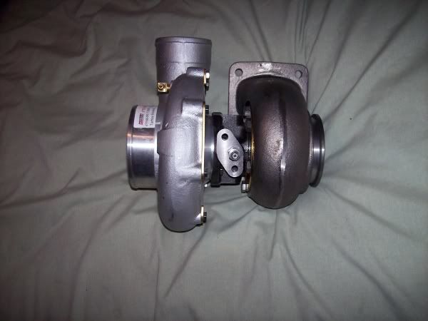

triple B Posted February 9, 2008 Author Share Posted February 9, 2008 yeah that was some good info man thanks i actually got the turbo today i decided on a PT67 and i had it built with the .81 exahust A/R here she is Quote Link to comment Share on other sites More sharing options...
Racinjitter Posted February 10, 2008 Share Posted February 10, 2008 Very Nice snail you got there.... I am jealous. Quote Link to comment Share on other sites More sharing options...
