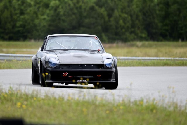

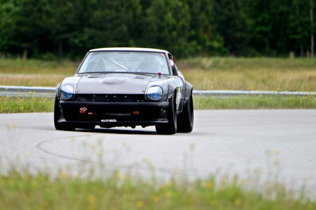

Mikelly Posted June 12, 2013 Author Share Posted June 12, 2013 (edited) Matt, last weekend was the first weekend I got to drive the car at speed for several laps and the car was rock solid stable. I can only assume that sealing off the hood and letting the air escape through the hood vents and the fender vents helped a fair amount with stability. My car only lost grip when I hit puddles on track while passing other cars. Otherwise, it was glued to the tarmac. I know the smart kids in class will argue that my fender vents are to small or to poorly positioned as with everything else I do. Funny, but I see none of their handy work, but lots of snipes at mine, and yours!!! What's even more funny is that the smartest kid in the room is sending PMs to others to try to win their support in his cause to harrass me. Shame that I was actually the guy who went to bat for him when we first made him a moderator here... POS for sure. Be interested in hearing about your brake kit!! Mike Edited June 12, 2013 by Mikelly Quote Link to comment Share on other sites More sharing options...

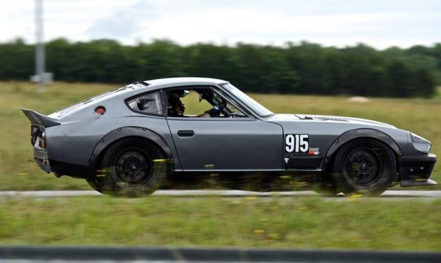

Mikelly Posted June 13, 2013 Author Share Posted June 13, 2013 (edited) They sure seemed to! The car was very stable at speed and I didn't feel like it had any issues. As you can see from the suspension compression, I was really applying a bunch of grip. my trackmate was showing 1.5Gs thru that big 270 degree corner. At no point did we bottom out and I am seeing zero evidence of any rubbing on any bodywork. I also noticed that during the 6-7 laps the car ran around the course it had zero issues with oil pressure (sustained in the 30-60PSI range according to the data log), Oil temps (never got above 212 according to the data logs) and coolant temps (Never got above 193 according to the data logs). I was considering sectioning the struts but I really don't need to adjust for travel anymore. I do plan to wire in two more analog sensors and log them. One for differential temp and one for trans temp. My focus in the coming days/weeks will be to clean up the front end by installing a spoiler on the leading edge of the front end, and to fabricate some rocker lower panels. Mike Edited June 13, 2013 by Mikelly Quote Link to comment Share on other sites More sharing options...
