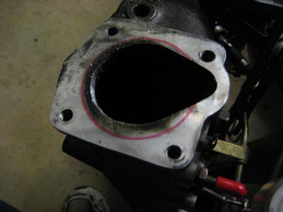

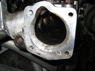

TrumpetRhapsody Posted December 3, 2008 Author Share Posted December 3, 2008 So far so good on the new ZX alternator. Crossing my fingers that it'll last. Took off the intake manifold last night and gasket matched it for the 240sx throttle body I've been running. I did a minor amount of actual porting, but this exercise was mainly to remove the ridiculous wall of metal the air was having to deal with. Throttle response seems to be a bit more predictable now, and I'm having to adjust my map a smidgen. Before and after pics: Quote Link to comment Share on other sites More sharing options...

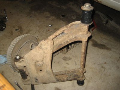

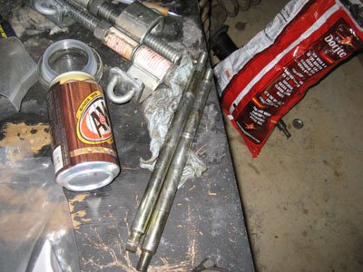

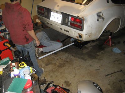

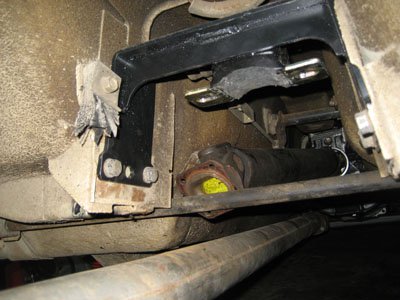

TrumpetRhapsody Posted January 13, 2009 Author Share Posted January 13, 2009 About time I'm getting around to posting this... Last week from about Monday through Thursday was spent replacing all the bushings in the rear with poly, and attempting to install a LSD and RT mount. The LSD was a bust, come to find out it requires 30 spline axles, where I have 29 spline. The seller was unaware of this, and everyone is trying to work toward an affordable fix. For now I've put my old R180 back in, and it'll do fine for now. The rear shocks were completely blown, and the diff mount was separated, allowing the diff to rise up about 1.5" and slap the retaining strap every time I accelerated. So, with new poly bushings, the updated diff mount, Mat's old cut springs from flatblack, and his old tokicos, the car is SOLID. We also pulled the spindle pins to replace that joint's bushings, which is nice to have done. The pins were actually in good shape, so I reused them, and need to sell the ones I bought. Now it's a completely different car to drive, I LOVE IT. Quote Link to comment Share on other sites More sharing options...

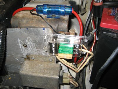

TrumpetRhapsody Posted January 13, 2009 Author Share Posted January 13, 2009 As for today, I ditched the fusible links! After my alternator fiasco, the 80amp one got a bit melty (I think the PO just replaced it with wire ) Got the idea to use the Scosche audio blocks from Walmart from the atlanticz website, and got it installed and working in like 10min. W00t! Just need to work on wire routing and mount it permanently sometime down the road. Quote Link to comment Share on other sites More sharing options...

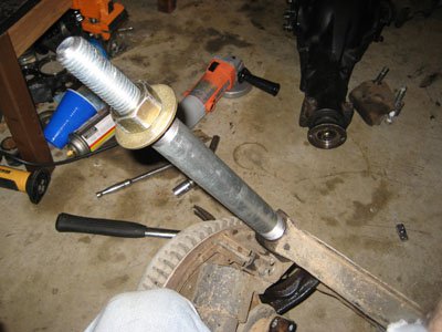

FlatBlack Posted January 13, 2009 Share Posted January 13, 2009 Did you drive the car at all today? I'm getting off at 4 and you know what we're doing to the flat black car Just look at me get to town on that spacer! --> http://forums.hybridz.org/attachment.php?attachmentid=11413&d=1231804962 Quote Link to comment Share on other sites More sharing options...

FlatBlack Posted January 13, 2009 Share Posted January 13, 2009 Heh you missed him getting so pissed off putting the spindle back in that he smashed the chair he was working on haha. He doesn't drink enough beer when he does Z work... Quote Link to comment Share on other sites More sharing options...
TrumpetRhapsody Posted January 13, 2009 Author Share Posted January 13, 2009 Car drove awesome today, loving the solid... everything That wasn't the spindle pin, that was trying to get the metal part of the inner LCA bushing to go in using your flawed installation method... Remember? Quote Link to comment Share on other sites More sharing options...
