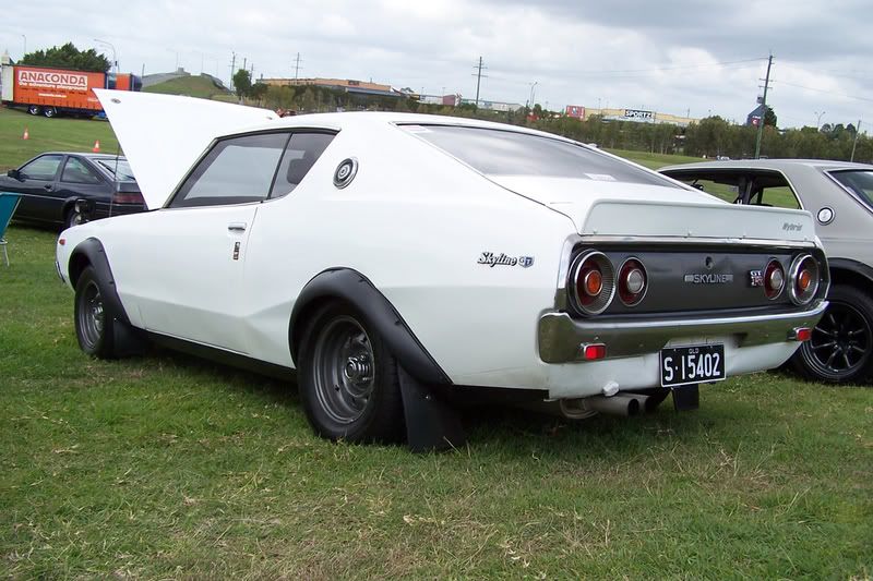

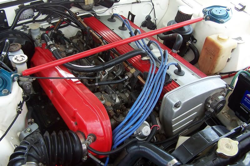

Now... if someone can find what other mods that Rocky Auto or that jap s130 had... that'd be sweet. Hold on, I'll post some pics soon =)
