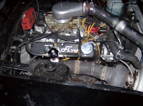

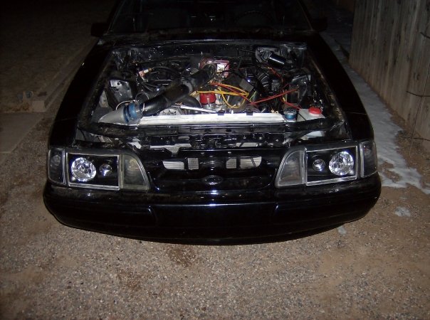

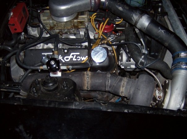

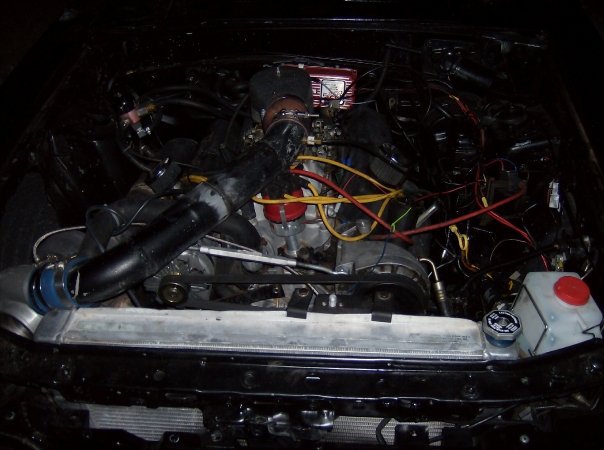

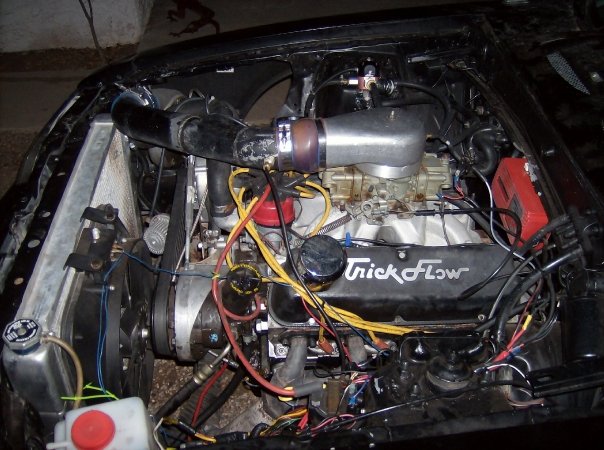

steeto_burrito Posted November 17, 2008 Share Posted November 17, 2008 im running a 306 turbo in my drag car, a little tip to save some time and money. get a set of stock fox body 5.0 headers. put the left on the right and the right on the left. all the bolt holes line up and you end up with an outlet toward the front of the car. viola there is your manifold, just work your piping from there. It works great my time slip will vouch for that . Quote Link to comment Share on other sites More sharing options...
blueovalz Posted November 17, 2008 Share Posted November 17, 2008 Which would be? Pictures....lots of pictures. Quote Link to comment Share on other sites More sharing options...
steeto_burrito Posted November 17, 2008 Share Posted November 17, 2008 86 Foxbody. Quote Link to comment Share on other sites More sharing options...

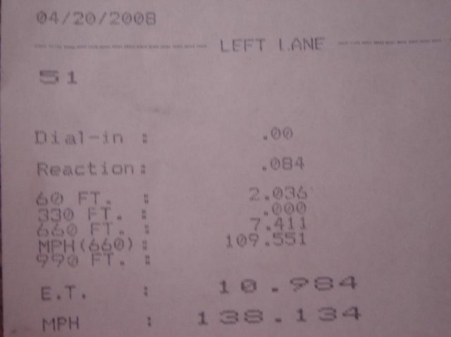

Administrators BRAAP Posted November 17, 2008 Administrators Share Posted November 17, 2008 im running a 306 turbo in my drag car, a little tip to save some time and money. get a set of stock fox body 5.0 headers. put the left on the right and the right on the left. all the bolt holes line up and you end up with an outlet toward the front of the car. viola there is your manifold, just work your piping from there. It works great my time slip will vouch for that . 86 Foxbody. You can't tease us like that and not post up the time slips. I like your simple get-it-done approach. Looks like a fun machine to drive... Quote Link to comment Share on other sites More sharing options...
steeto_burrito Posted November 17, 2008 Share Posted November 17, 2008 You can't tease us like that and not post up the time slips. I like your simple get-it-done approach. Looks like a fun machine to drive... I just love the thing. Its a blast to drive, once in a while she gets out on the streets. Just have to turn the boost waaaaaaaay down. Otherwise she gets a little out of hand. Anyways heres the timeslip. That one is my best. Quote Link to comment Share on other sites More sharing options...
