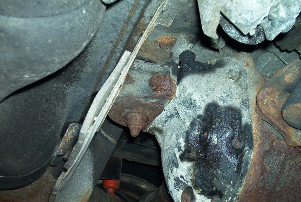

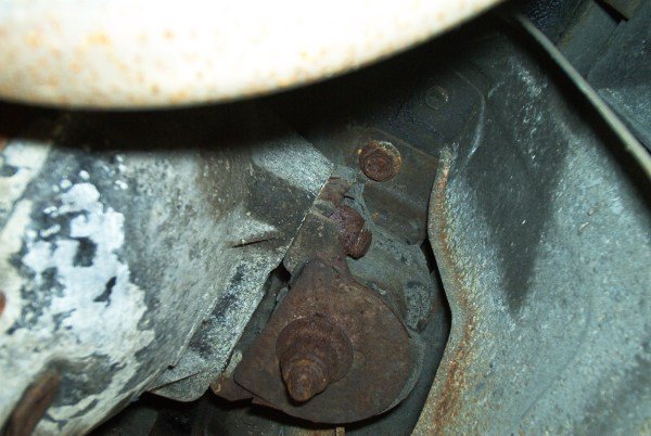

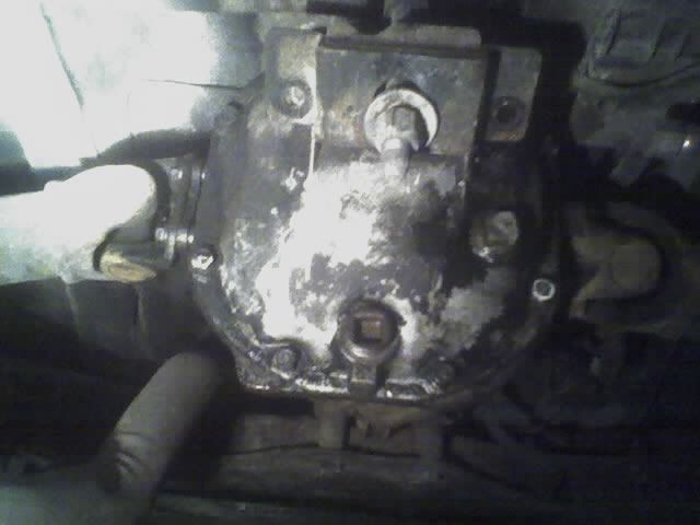

stock s130 diff pics please!
i think only the autos were r180s, that should be an r200 in yours. theres a sticky in the drivetrain section.
Differential / CV / LSD / HP / Torque / R160 / R180 / R200 / R230 / Diff Mount
i read that for the 280zx's they all had/have the r200. autos had a different gear ratio. the r180s where for the s30's and when the chasis changed to the zx so did the rearend to the r200. however i dont remember where i read this though, it was a while ago when i was woundering what rear end i had in my 280zx.
i could be wrong or misinformed.
R180 - Came in 240, 260, 77-78 280Z automatic, and 280ZX automatic, among others. Also in the new WRX STi
Longnose R200 -weight 76 lbs - Came in 260Z 2+2, 280Z manual, 75-76 automatic and 2+2, S130, Z31, 200SXT
Here this might clear some stuff up
Looks like if it's an auto then it's R180 other wise it should be a R200
