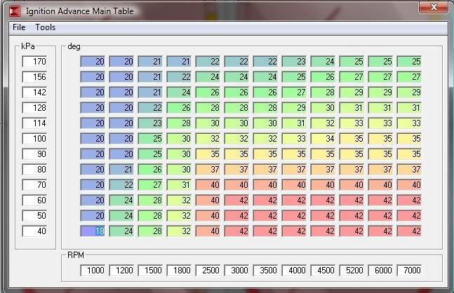

X64v Posted April 7, 2008 Share Posted April 7, 2008 I've been having a problem with my fresh turbo motor. From 4000-5500rpm, I get a very audible sound that I thought was pinging. However, it will not go away, now matter how much timing I pull or fuel I add. Motor specs: Fresh L28et stock bottom end '73 E88 head (N33, 47.8cc chambers, sharp edges rounded) Stock nissan head gasket, making for 7.9:1 SCR V3.0 MS I, MSnS-E code Stock T3 turbo, stock manifold. Stock wastegate at 7psi. Walbro 255lph external fuel pump 338cc injectors 1g dsm bov, no intercooler BPR6ES-11 plugs The thing is, this noise acts completely like ping. Only comes on under boost after 3800 or 4000rpm, disappears by 5500 or 5700 rpm (basically just during peak torque ranges), isn't as bad in 1st because of the lighter load, etc. My normal tune is about 11.7:1 afr, 30 degrees of timing at 130kpa and 29 degrees of timing at 140kpa (at this altitude '7psi' bounces between 130-140kpa). At these settings the sound is pretty bad, happening probably 40-50 times on a second gear pull. BUT, I can pull my timing to 20 degrees under boost and richen my fuel to 10.8:1, and it still happens 10-20 times on a second gear pull (even though it feels like I've lost 40ft. lbs. of torque). It also seems to start at 110kpa, which is practically no boost, just about 2psi (ambient here is about 90kpa) Could this still be detonation? If not, what is it? I'm running 91 octane gas. This exact same cylinder head/turbo/megasquirt combo ran fine on my L24 bottom end at 8.9:1 SCR. Also, I blew a head gasket because of some major knock/detonation caused by fuel starvation on a hard left-hand turn, but this 'ping sound' itself will not blow my head gasket, no matter how long I let it happen. I can rev the motor free or under light load slowly or quickly from idle to 7000rpm with no problems, no ping sound. My next diagnostic step will be to run my gas tank low and then put 4 or 5 gallons of 100 or 105 octane in to see how that affects things. Any ideas or suggestions as to what's going on? Quote Link to comment Share on other sites More sharing options...

X64v Posted April 11, 2008 Author Share Posted April 11, 2008 Well, I think I've confirmed that it really is ping. On 97 octane, the ping sound was totally gone in 1st and 2nd gear, and was greatly reduced in 3rd and 4th. Now, I have two more questions. First, why would this engine setup be pinging now, and so badly? Everything's identical to my previous engine set up with the exception of the bore/stroke size and the compression ratio. And second, why isn't this ping blowing my head gasket? I blew a head gasket a few weeks ago from fuel starvation on a hard left-hander (the light ping turned to heavy knock), but otherwise I can hammer on the motor all day with this light ping and it doesn't seem to do anything. Edit: Here's the spark map I've been running the past week or two. Quote Link to comment Share on other sites More sharing options...
X64v Posted April 13, 2008 Author Share Posted April 13, 2008 A little update: I filled back up on 91 octane and switched to BPR7ES plugs gapped at .028", and that actually worked even better than the race gas. Ping is gone in first and second, just barely there in 3rd, and not nearly as bad in 4th and 5th. I think if I pull 2-3 degrees of timing I can eliminate it completely. My only question now is why am I having to run a 7 heat range plug to get rid of ping? I'm only at 7psi and 7.9:1 cr, and my manifold air temps never really rise above 170 (I do most of my driving at night). Quote Link to comment Share on other sites More sharing options...

Administrators BRAAP Posted April 13, 2008 Administrators Share Posted April 13, 2008 In reading over this, a couple things come to mind. Possibly your damper inertia ring has spun, (elastomer let go), and the timing mark on the damper is not showing actual piston TDC when verifying with a Timing light? Maybe try pulling out a lot of ignition timing, I mean an exaggerated amount of timing, say on order of 15-20 degrees across the board. If the car still runs and runs good, then chances are when you set your base ignition timing, your damper mark had spun, OR, possibly the pointer is on the wrong side of the front cover for that damper? Another possible issue might be the coolant flow through the head and around the chambers themselves, as has been discussed before, (link to an INCREDIBLE discussion below). With your Turbo engine, I would definitely recommend sticking with at least the NGK heat range 7 plugs. You might even try the 8’s though you may find that at partial cruise, the 8’s might carbon out, not getting hot enough, though under boost may be just right. A slightly leaner cruise mixture will help keep that from happening, but wont cure that 100%. Plug heat range is very dependent on each engine. For example, my N/A 8:1 L-28 loved the NGK BPR7ET’s. 6 were to hot, and 8’s were perfect while at the track, but too cold for the street. Outside of that, I’m at a loss as well. 1) Verify without doubt that your damper pointer IS point to TDC when the number one pistons is actually at TDC! 2) Try next colder heat range spark bolt, 8’s in this case, you may have to lean out cruise mixtures if you try this. 3) Install a colder Thermostat such as the 160 degree which should help cool combustion temps a little more. Also along those lines, I have read reports from others whom I trust in this arena, that coolant additives such as Red Lines Water Wetter and NPG-R coolant helped noticeably reduce the common L-series ping. Theory is it softens the coolants surface tension allowing the heat from the chambers to transfer that heat to the coolant more efficiently therefore keeping combustion temps cooler which WILL reduce ping. Here is that thread that goes into incredible detail regarding blowing the head gasket at cyl #5 and coolant flow, water wetter, etc. It is a deep subject, but VERY informative; http://forums.hybridz.org/showthread.php?t=125186 Quote Link to comment Share on other sites More sharing options...

X64v Posted April 13, 2008 Author Share Posted April 13, 2008 Thanks for the response Paul. The bit about your N/A engine wanting 7s clears it up: if this heat range is what the engine wants, I'll just run them. I know for a fact the timing mark is correct. I verified it when I built the engine a month ago, and immediately set my trigger angle in Megasquirt to match. As far as the thermostat goes, I was under the impression that 160 degree thermostats were run to keep the engine at about 170 degrees normally, correct? Well, with my 180 degree thermostat, Megatune reads 170 degrees around town. Also, I already run distilled water with Water Wetter and a JTR aluminum radiator. I have read through that thread, and it wouldn't surprise me if my E88 head has different coolant flow patterns or casting flashing in different places that make it just a tad more susceptible to ping. But like I said, if the engine likes 7s on the street, 7s are what I'll run. Quote Link to comment Share on other sites More sharing options...
X64v Posted April 15, 2008 Author Share Posted April 15, 2008 Alright, I've been running the BPR7ES plugs, and I pulled my timing to 25-26 degrees at 7psi, but I'm still getting moderate detonation with 85 degree ambient temps and 175 degree water temps. I'm going to try some BPR8ES plugs, but it's strange that I should have to go so cold. My L24 turbo motor was fine on 6's all the way through 10psi even with outside temps pushing 115, with the only difference being the bottom end (which had a much higher comp ratio, 8.9:1). Quote Link to comment Share on other sites More sharing options...
