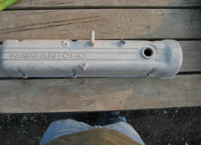

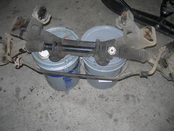

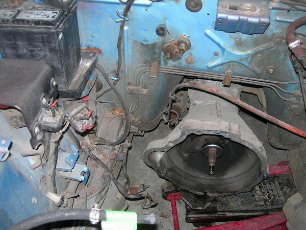

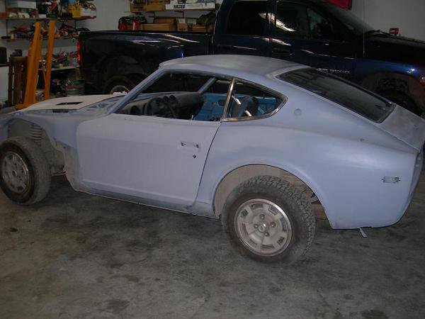

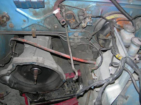

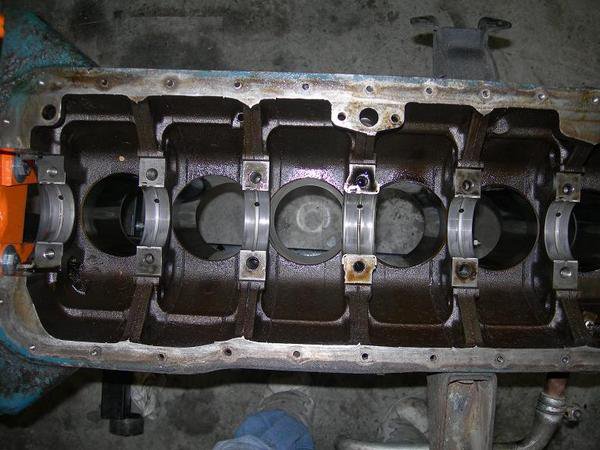

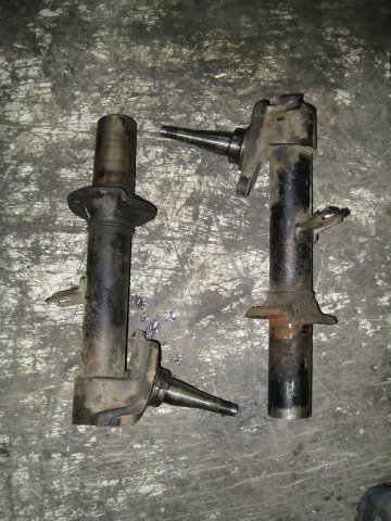

shift00 Posted April 10, 2008 Share Posted April 10, 2008 I just thought i would show you guys what ive done to restore my car... sorry i didn't have any pics of my body work in progress. I will continue to post pics of the progress Quote Link to comment Share on other sites More sharing options...

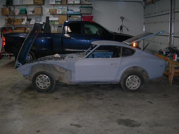

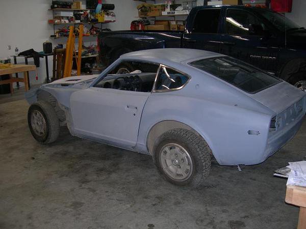

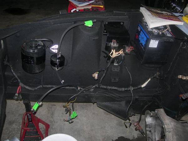

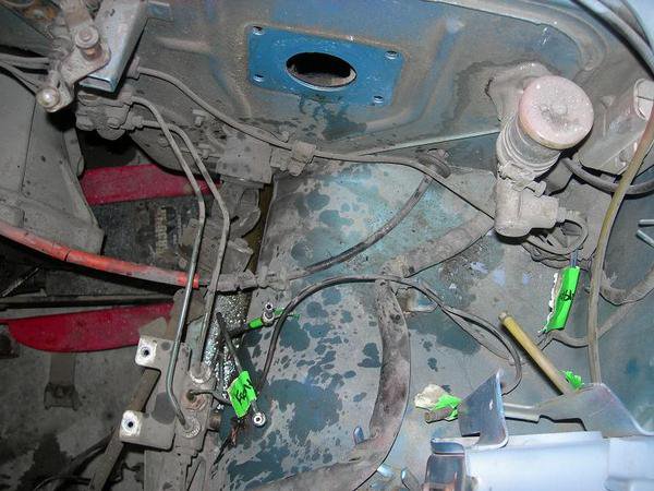

shift00 Posted April 10, 2008 Author Share Posted April 10, 2008 out with the old Quote Link to comment Share on other sites More sharing options...

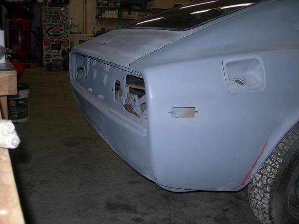

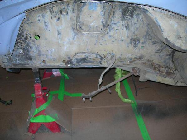

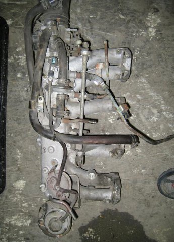

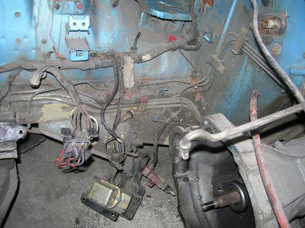

shift00 Posted April 10, 2008 Author Share Posted April 10, 2008 in with the new Quote Link to comment Share on other sites More sharing options...

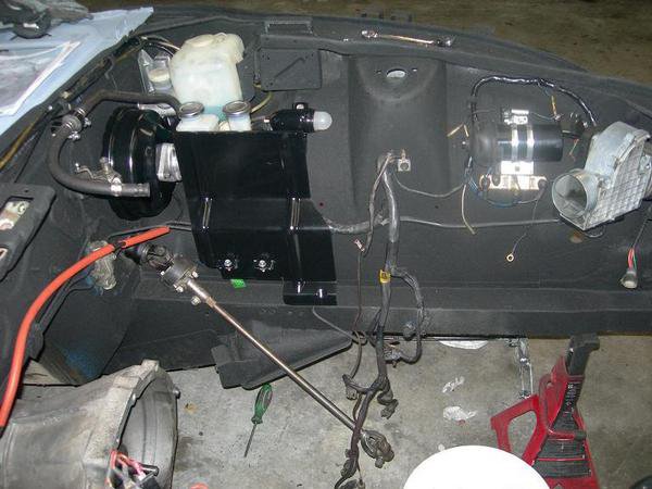

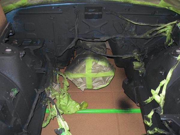

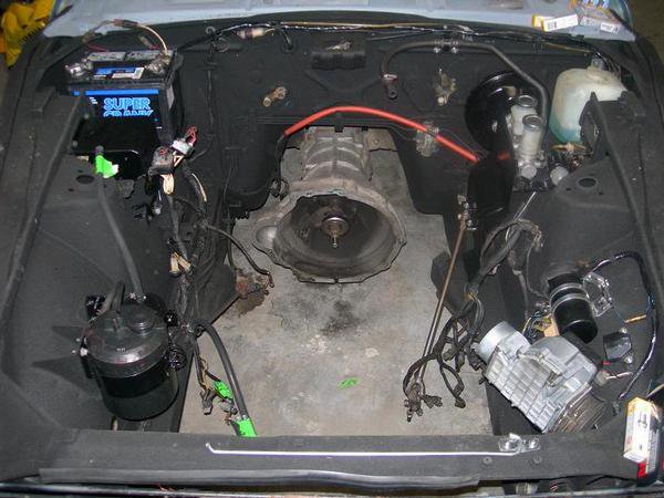

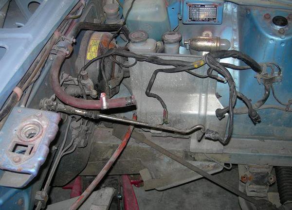

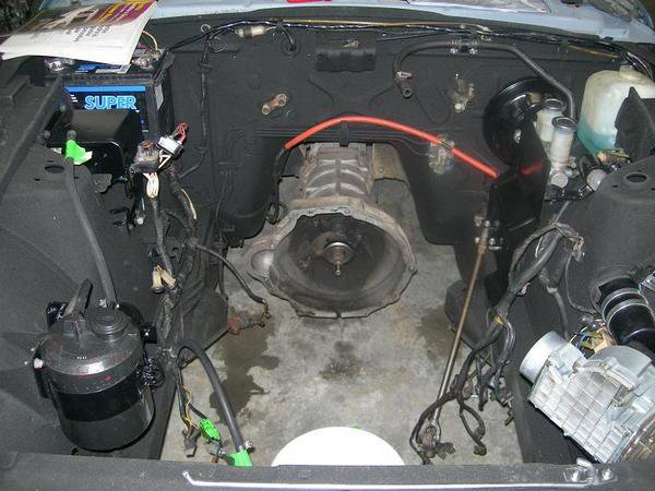

shift00 Posted April 10, 2008 Author Share Posted April 10, 2008 ill have some more pics shortly. What do you think about undercoating the engine bay? Quote Link to comment Share on other sites More sharing options...
V8ZRACER260Z Posted April 10, 2008 Share Posted April 10, 2008 Looks Ok. but I still prefer them painted not undercoated. You will find undercoating will rub off and is not resistant to gas or other fluids. I like the initive though keep us updated. Quote Link to comment Share on other sites More sharing options...

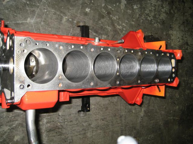

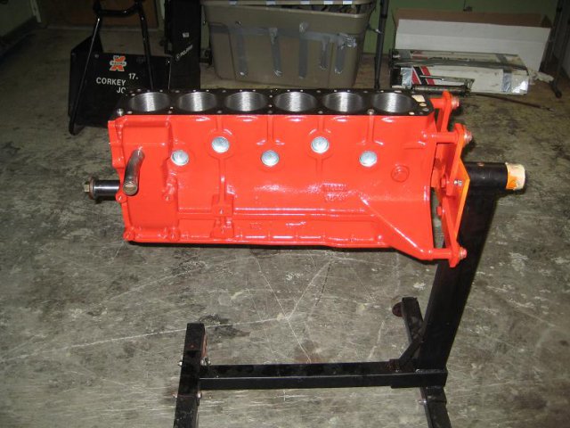

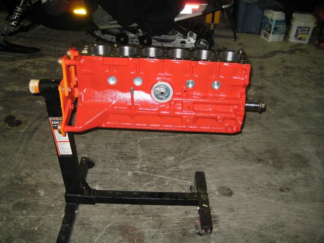

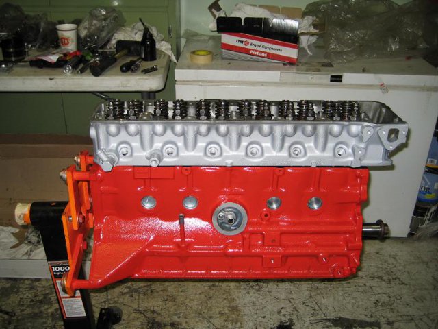

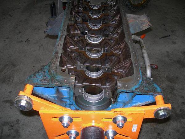

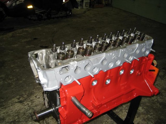

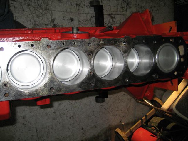

shift00 Posted April 14, 2008 Author Share Posted April 14, 2008 This is what the motor looks like right now. Painted it high temp chrystler red. The head is not bolted on the block it was just sitting on there for the picture. Quote Link to comment Share on other sites More sharing options...

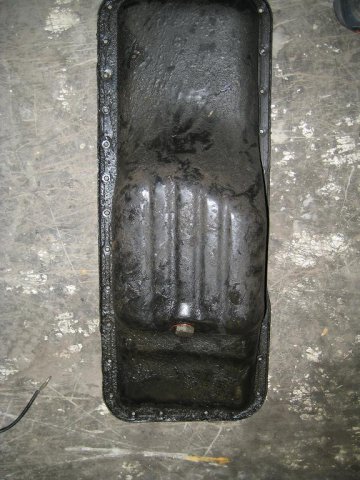

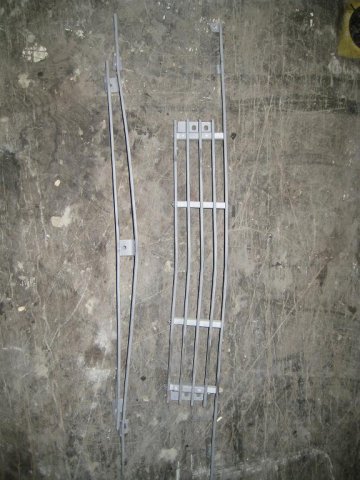

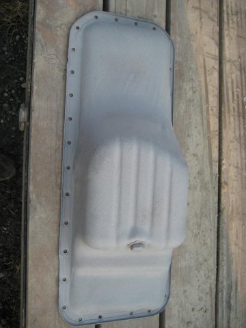

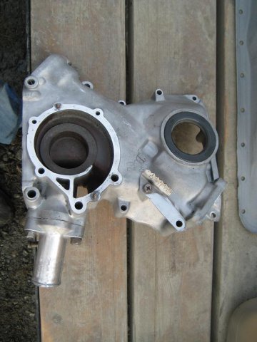

shift00 Posted April 14, 2008 Author Share Posted April 14, 2008 this is was is what the parts looked like before sandblasting and powdercoating. Quote Link to comment Share on other sites More sharing options...

jakeoster Posted April 15, 2008 Share Posted April 15, 2008 I'm curious about the undercoat that you did in your engine bay. I am considering doing that. Is it true that its not as sturdy as normal paint? Quote Link to comment Share on other sites More sharing options...
shift00 Posted April 15, 2008 Author Share Posted April 15, 2008 unfortunately i couldn't tell you if its durable, because this is the first time i've done it. I've heard both good and bad things about undercoat, but it all depends on the preparation before putting it on just like everything else. Quote Link to comment Share on other sites More sharing options...

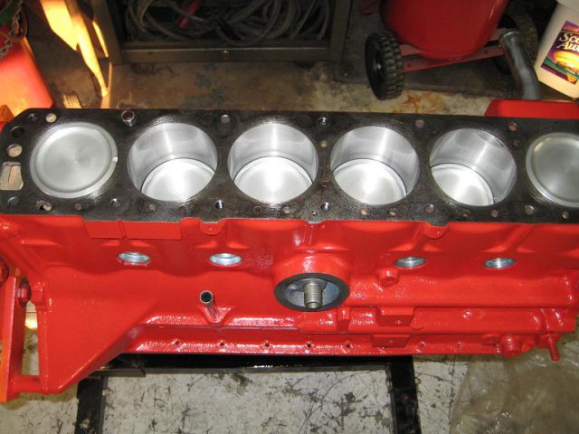

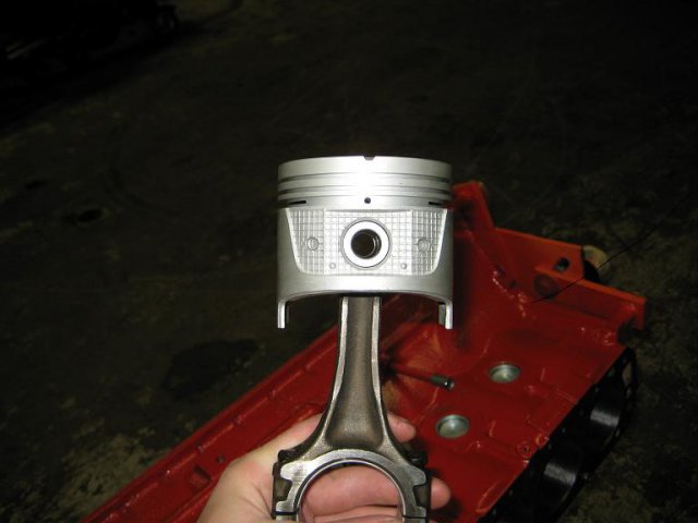

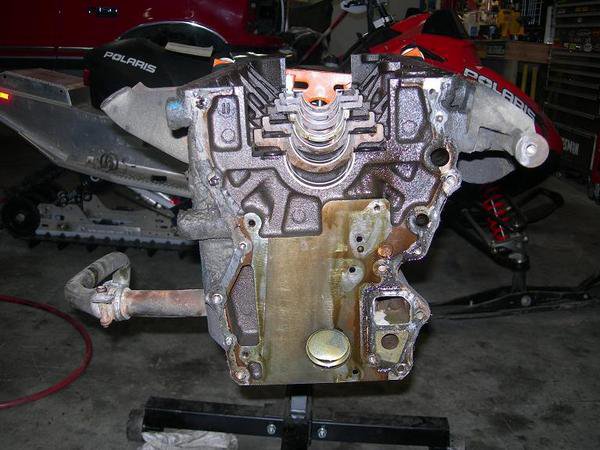

shift00 Posted April 16, 2008 Author Share Posted April 16, 2008 i put the rings on the piston today, tomorrow i shoud have the head on and working on the the cam...Not to much left. Quote Link to comment Share on other sites More sharing options...
z-ya Posted April 16, 2008 Share Posted April 16, 2008 Take your time, do it right. The ITM gasket set has a good head gasket, but the valve cover/oil pan, and intake/exhast gaskets are kind of cheap. It takes a lot of patience to get the deformed cork oil pan gasket on there right. And the cork valve cover gasket is not worth even using. Mine lasted less than on track day, and it made a mess when it let go. Quote Link to comment Share on other sites More sharing options...

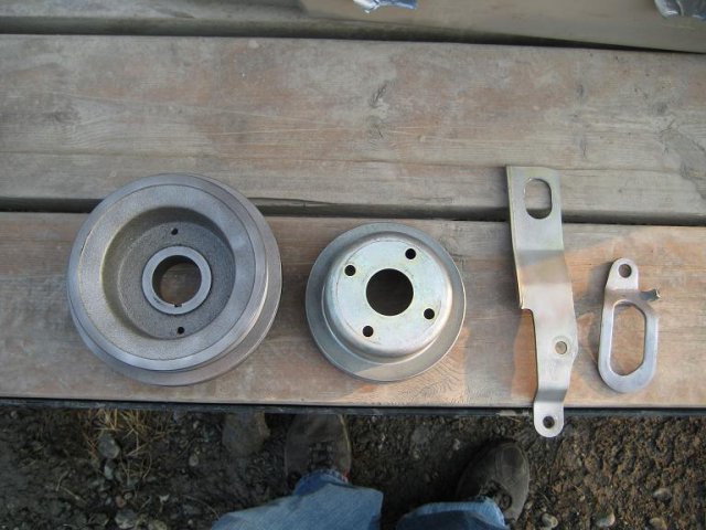

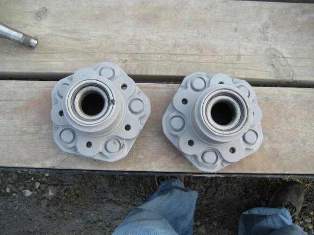

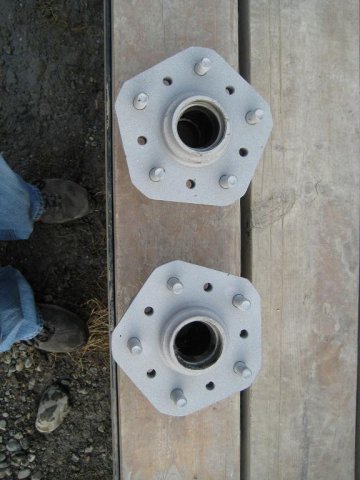

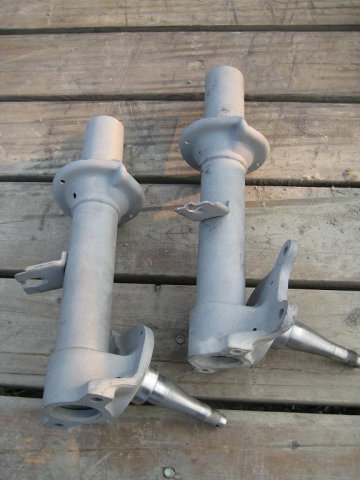

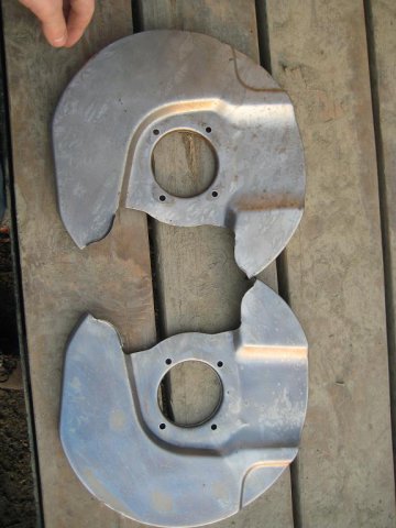

shift00 Posted April 19, 2008 Author Share Posted April 19, 2008 I got all these parts sandblasted for $180..i didn't think that was a real great deal, but it turned out pretty good and should have it powdercoated pretty soon. Quote Link to comment Share on other sites More sharing options...
Kevin.pk Posted April 20, 2008 Share Posted April 20, 2008 hey joe, figured i would chime in real quick. The parts look good but just a fyi. I wouldn't get the brake dust shield powder coated until after you get the brakes sort of mocked up. You are gonna end up trimming the dust shield when you install the Toyota 4x4 calipers as they are obviously larger than the stock calipers. I guess I forgot to tell you this cause I didn't install any shields, as mine were missing when i got the car The project looks like it is coming along pretty good... keep it up and you'll have it done in no time. Kevin Quote Link to comment Share on other sites More sharing options...

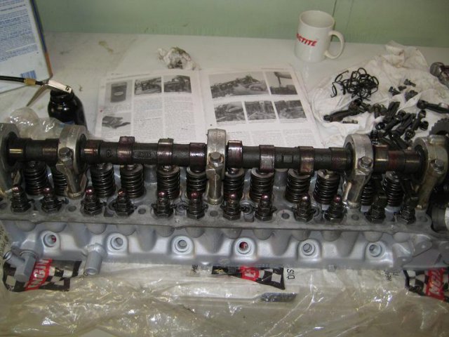

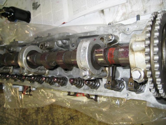

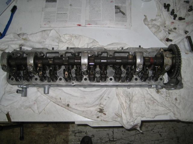

shift00 Posted April 21, 2008 Author Share Posted April 21, 2008 these are the newest pics on the motor. I've had a few problems with realighning the journels on the camshaft, does anyone have some tip on how to do so? Quote Link to comment Share on other sites More sharing options...
shift00 Posted April 21, 2008 Author Share Posted April 21, 2008 I broke a cam tower bolt as i was torqueing it down, to the minimum torque spec at 25 ft pounds! So i had to take all the rocker arms and mouse traps off and go order a bolt for it, so it should be in within the next couple day and I can go ahead put the head back together. Also i was wondering if anyone has any tech tips on how to realighn the cam journels with the cam towers? New info on this might prove to be useful! Quote Link to comment Share on other sites More sharing options...
z-ya Posted April 22, 2008 Share Posted April 22, 2008 The journals are align-honed at the factory, so you must put the cam towers back in the same order as when they came from the factory. I put the cam towers on loose with the bolts just started. Then I insert the cam with plenty of oil on all the journals. The cam should spin freely without any binding. Then start snugging down the tower bolts using the correct order. After you snug each bolt, make sure the cam still spins freely. Continue to snug down each bolt checking cam movement. Once all the bolts are snugged, torque them to spec, again checking for cam movement after torquing each bolt. Quote Link to comment Share on other sites More sharing options...
shift00 Posted April 22, 2008 Author Share Posted April 22, 2008 thanks Z-ya, Thats what is did and i had the cam towers marked before i took them off and put them back on in order, but there was still binding on two of the towers. I read im my book and it said if it didn't alighn than hit it vertically with a soft mallet, but that didn't work so i think im gonna' try it again and if it doesn't alighn than im guess i will just have to bite the bullet and get it alighnbored. Quote Link to comment Share on other sites More sharing options...
