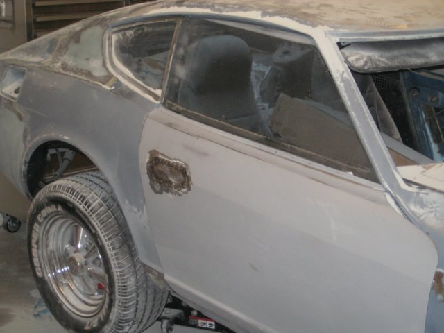

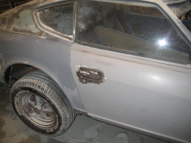

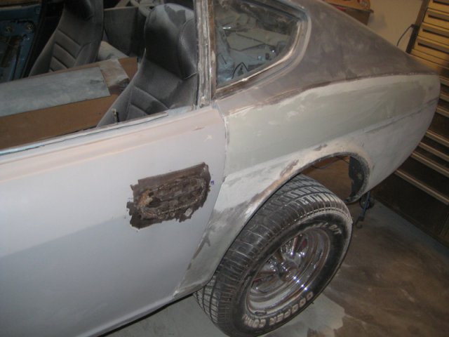

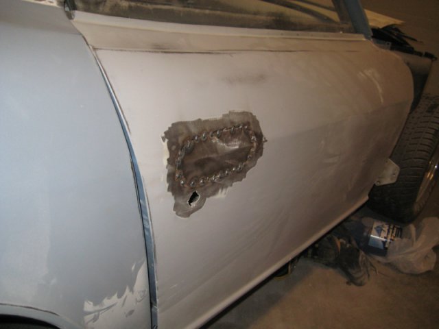

shift00 Posted February 5, 2009 Author Share Posted February 5, 2009 well here is the start to shaved door handles Quote Link to comment Share on other sites More sharing options...
Guest mad-mike Posted April 15, 2009 Share Posted April 15, 2009 nice deal you have goin so far its inspiring me to do the same to mine lol except the shaved door handles Quote Link to comment Share on other sites More sharing options...
shift00 Posted April 17, 2009 Author Share Posted April 17, 2009 nice deal you have goin so far its inspiring me to do the same to mine lol except the shaved door handles Well thats good to hear man. its been quite the undertaking. so get started on your and let me know how it goes or if you need any help. thanks joe Quote Link to comment Share on other sites More sharing options...

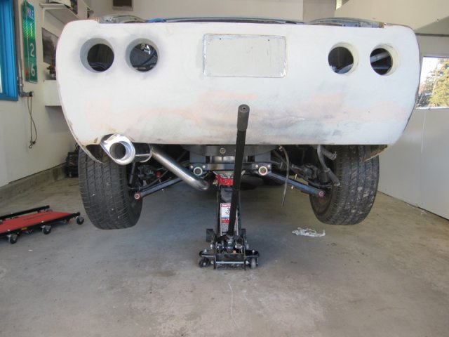

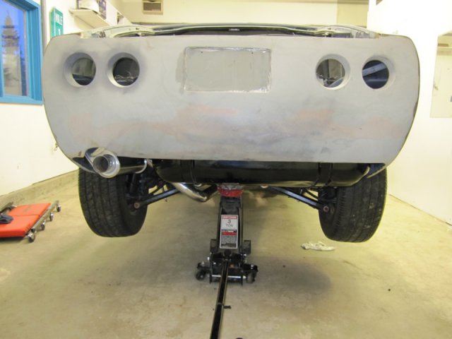

Zed lover Posted April 18, 2009 Share Posted April 18, 2009 I really like the tail lights! they give the car good clean lines and by looking at your pictures that is what your going for. I just bought a '77 my self and you are giving me great ideas. Great job looking forward to seeing it finished. Quote Link to comment Share on other sites More sharing options...
shift00 Posted April 20, 2009 Author Share Posted April 20, 2009 thanks guy i really do appreciate everything that has been said about this car. the only bad thing i that i haven't been working on it in awhile, but i still I hope to have this thing paint by summer. Does anyone have any suggestions about what i should do, or would look "cool" on the car? Quote Link to comment Share on other sites More sharing options...

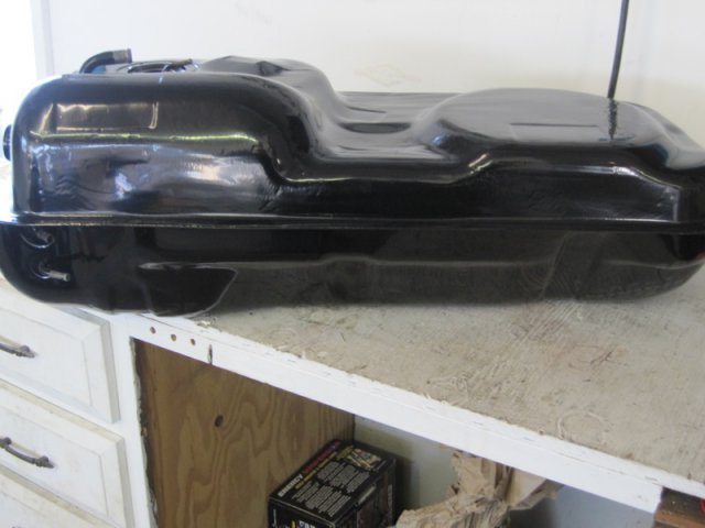

shift00 Posted January 31, 2010 Author Share Posted January 31, 2010 I took my fuel tank and had it powder coated, I think it looks pretty good! Quote Link to comment Share on other sites More sharing options...

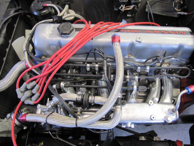

shift00 Posted January 31, 2010 Author Share Posted January 31, 2010 So I have an 77' 280z with a N42 block, head, and intake manifold...Does this vacuum and emission lines look properly routed? Thanks, Joe. Quote Link to comment Share on other sites More sharing options...
Hugh Posted February 2, 2010 Share Posted February 2, 2010 Looking good. Sorry can't help with line routing. They weren't afraid your fuel tank would explode or something? I had a really hard time finding someone to weld on a sump to mine. (gave up) Quote Link to comment Share on other sites More sharing options...
shift00 Posted February 2, 2010 Author Share Posted February 2, 2010 No...they just made me wash it out a few times with water. I pretty sure that didn't help at all seeing how i could still smell gas, but whatever made them happy! I have a question, what is that thing inside the fuel tank? Whatever it is, do you think i ruined it during the powder coating process? Quote Link to comment Share on other sites More sharing options...
Hugh Posted February 2, 2010 Share Posted February 2, 2010 Which thing are you referring to? Quote Link to comment Share on other sites More sharing options...
leftover z Posted February 10, 2010 Share Posted February 10, 2010 So I have an 77' 280z with a N42 block, head, and intake manifold...Does this vacuum and emission lines look properly routed? Thanks, Joe. DANG Shift. That engine compartment looks nice. Not too much bling. Very tasteful. Quote Link to comment Share on other sites More sharing options...

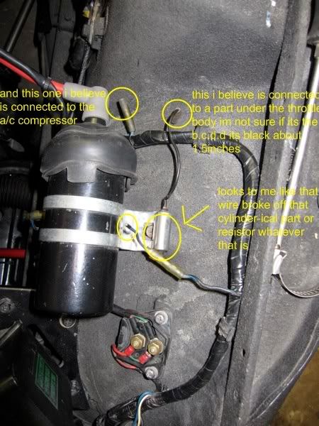

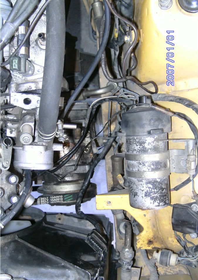

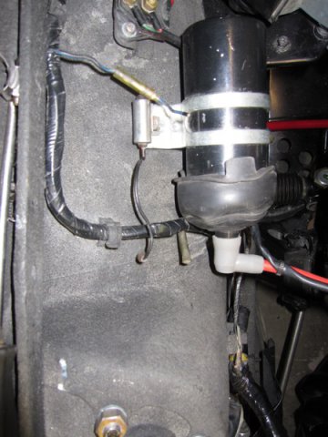

shift00 Posted February 11, 2010 Author Share Posted February 11, 2010 Does anyone know where these wire go to? I have three of them just hanging out and I have no clue where they go. Appreciate the help, Joe. Quote Link to comment Share on other sites More sharing options...
Mr.Roboto Posted February 14, 2010 Share Posted February 14, 2010 but i believe a lot of things... Quote Link to comment Share on other sites More sharing options...
Mr.Roboto Posted February 14, 2010 Share Posted February 14, 2010 hope this image helps too... fellow z buddy(>o_o)> Quote Link to comment Share on other sites More sharing options...
shift00 Posted February 15, 2010 Author Share Posted February 15, 2010 Thank you so much my friend, that really helped me out. Quote Link to comment Share on other sites More sharing options...
Mr.Roboto Posted February 15, 2010 Share Posted February 15, 2010 i would've preferred thank you very much-o mr.ro-bo-to but anywho keep us posted with your build Quote Link to comment Share on other sites More sharing options...
